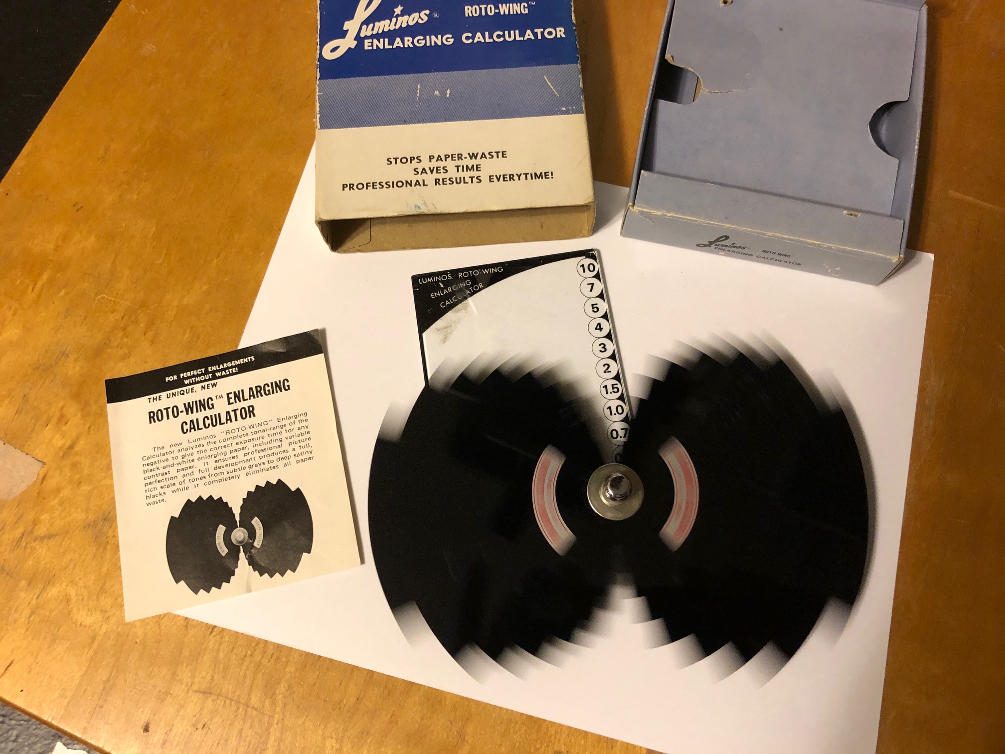

There is always the sort of-hybrid tool. I got this in a box of stuff about 45 years ago.
