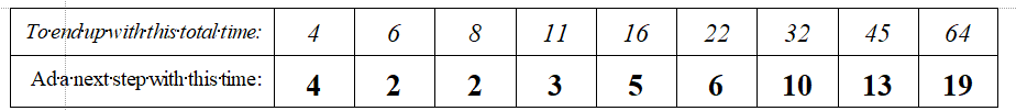

Not new, but I concede it’s not universally adopted…
Lootens 1945 and Mortensen 1942 both recommend test strips in geometric series.
Mortensen recommends 4, 6, 8, 11, 16, 22, 32, 45, 64.
Adams confoundedly doesn’t. He says 10, 15, 20, 25, 30.
Drawback of the third-stop series I use (16, 20, 25, 32, 40, 50) is that it doesn’t cover much range.
Lootens’ series (5, 10, 20, 40, 80) covers enough range to assure a “too dark” and a “too light” patch.

Actually, the advantage of the f/stop system is that it is easier to see the progression of differences, because the steps are visually equal and consistent, and there is less likelihood that the best choices will be all crunched up together at one end.

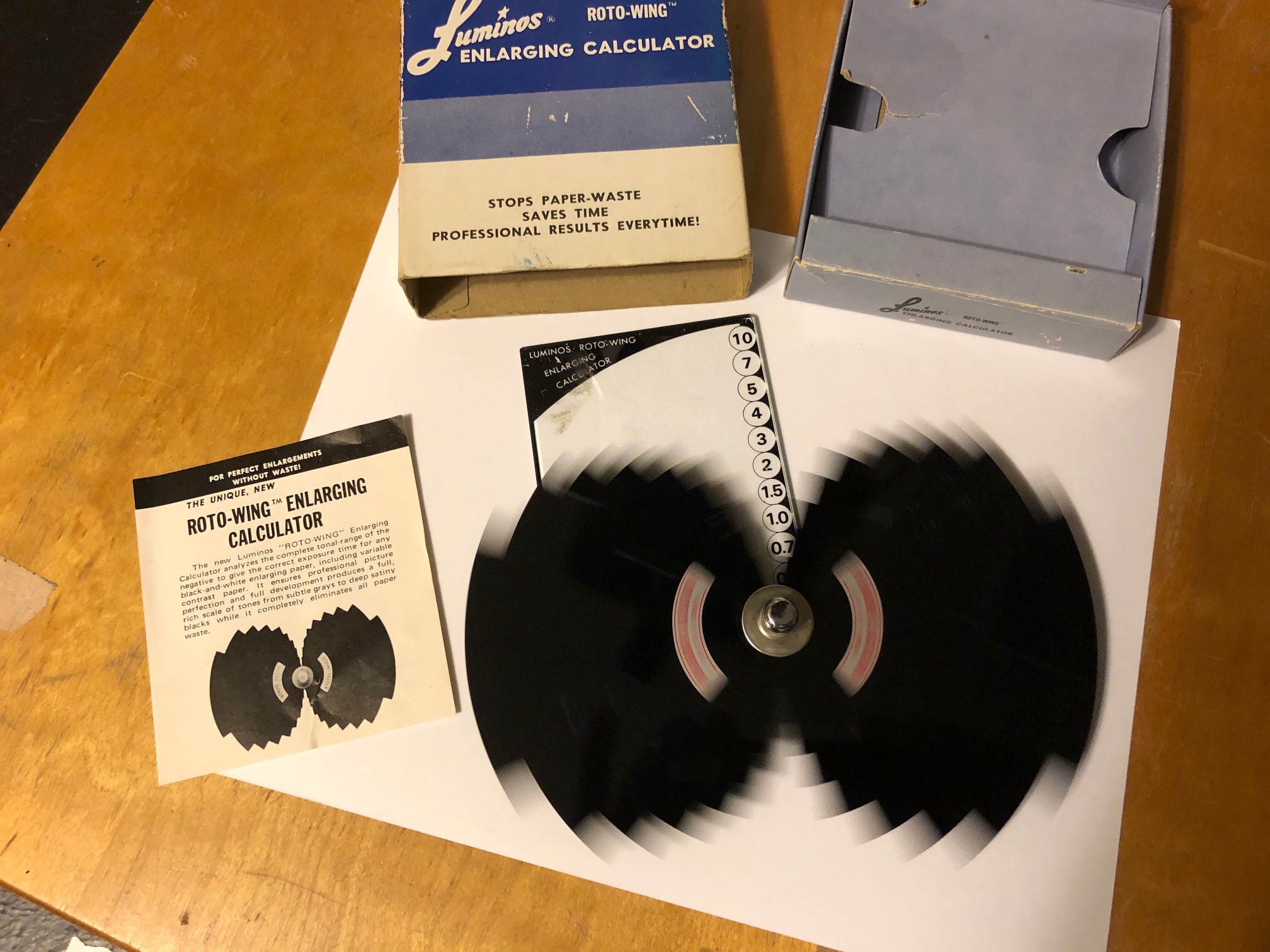

You must be joking.
I suppose they sold a few of them back in that day. As I said, this was in a box of miscellany I acquired back in the 1970s. I think it came out of a photo lab I worked in. For decades, they had tossed all kinds of junk into the old upstairs, which used to be an apartment building, and when the fire department said to clean it up, I put in overtime hauling stuff out to the dumpsters. I intercepted all kinds of cool and weird stuff.
And by the way Drew, that is the progression I use for my first set of test strip exposures, not for fine tuning the result. For fine tuning, my aperture stays unchanged, and I use the 1/6 stop tables in Way Beyond Momochrome.
