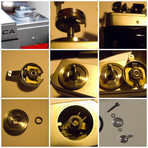

Shutter speed selector disassembly by Zoltán Kelemen, on Flickr.
Advance lever disassembly
Hotshoe disassembly
Rewind lever disassembly.

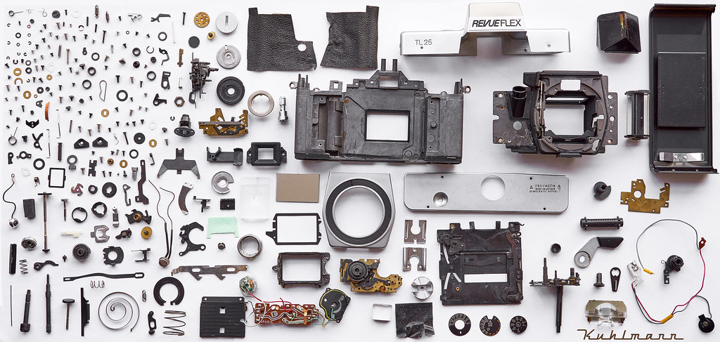

Aslo this interesting picture of a disassembled TL25 (MTL5)
Thank you!
