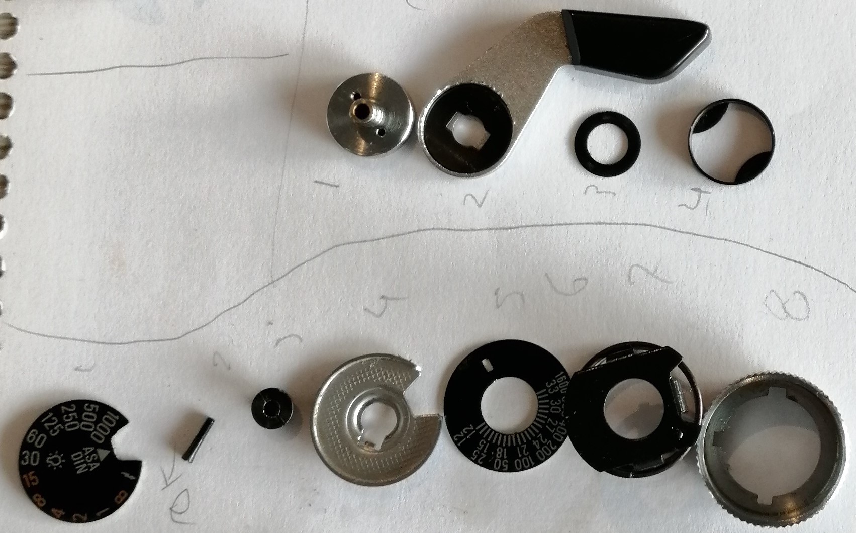

Hello, I have a Praktica MTL5B and I want to clean the viewfinder, but I have no way to remove the shutter speed selector. It was taped and I didn't know how to remove it so as not to affect the camera. I need help.
Thanks very much.
Try a heat-gun (hot air), whilst covering the rest of the camera. That might soften the adhesive of the cover of the button.

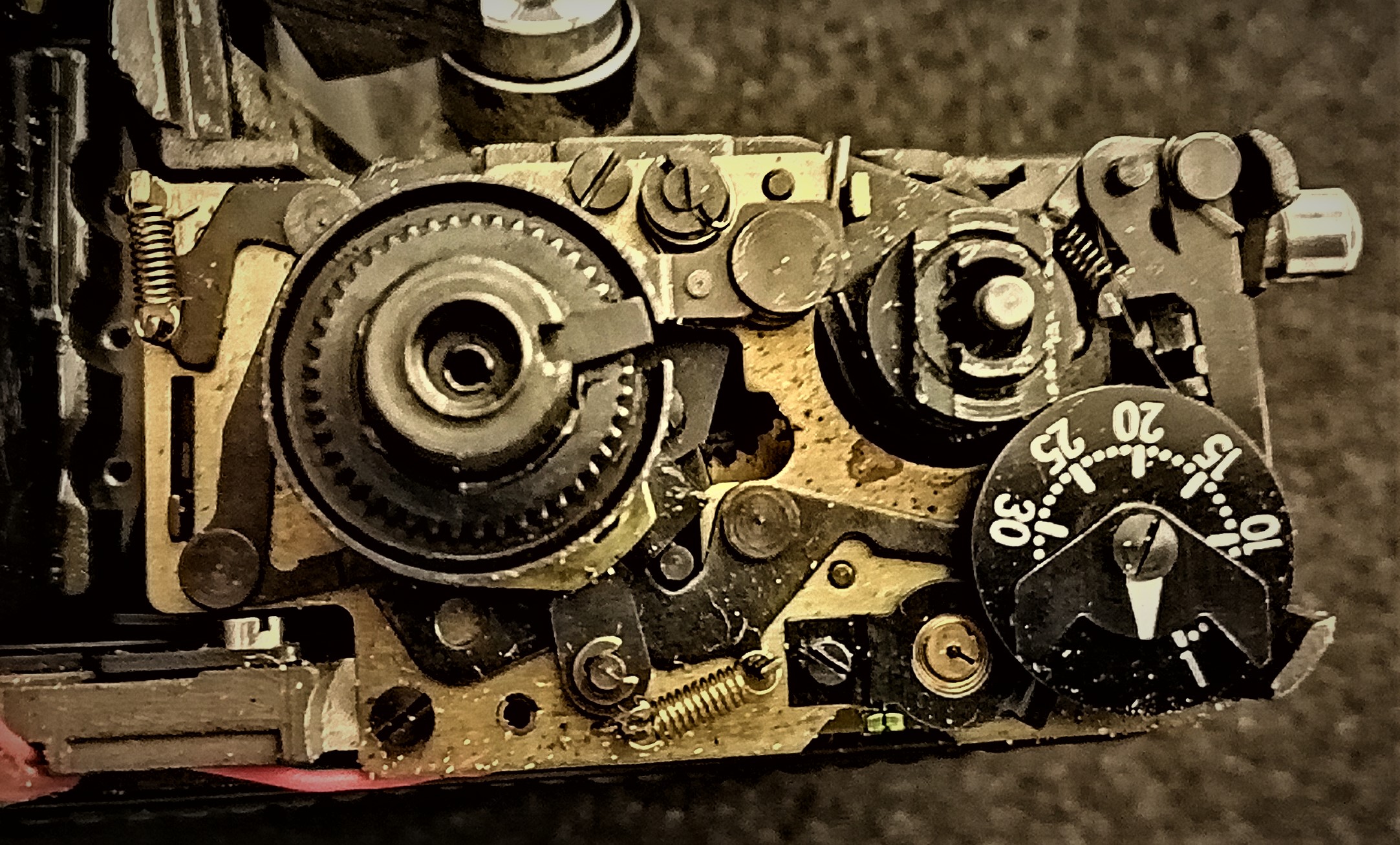

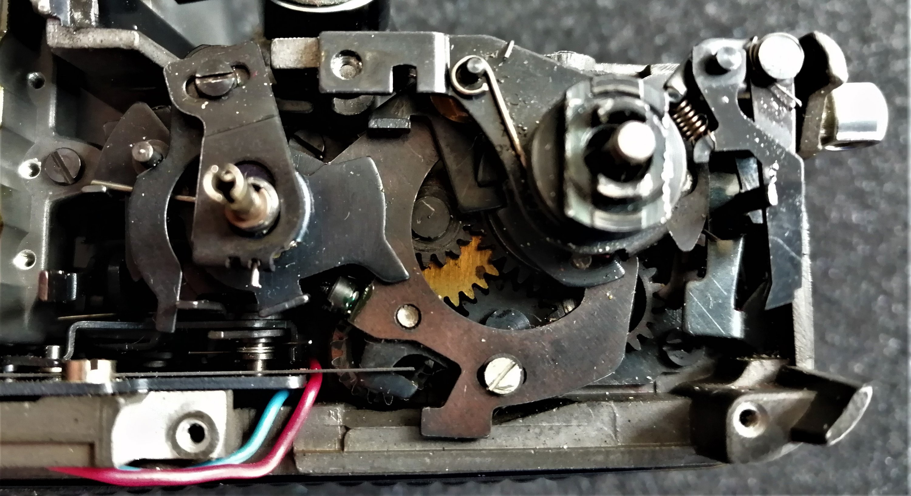

PRAKTICA MTL5b JAMMED WIND LEVER
See video below I posted which shows the wind lever jamming on the small rotating stop arm. It appears that the wind lever stop arm is not being reset by the adjacent cam when advancing the film.
It will only reset if I hold down the shutter release button whilst advancing the wind lever, as shown in the video.
Have no idea how to fix it. I am trying to decipher the service manual posted at #4.
Thanks for taking a look.
Does the mirror return or does it stay up? Do the shutter curtains cycle properly? Try to pull the shutter curtain down with your fingernail.
If I hold down the shutter button and cycle the advance lever, the mirror flicks up and down and the curtain cycles properly intermittently (as in I can see light from viewing at the rear of the camera). the majority of the time the curtains do not open and I cannot see light passing through the camera. The curtains on the MTL5b fold upwards and are lapped over each other so I cannot manually push them up with my anil without causing damage.
To test, one tries to pull the curtains down not up.. There is a flat headed silver screw by the advance mechanism. You could try loosening it and pull the metal strap from the shutter mechanism as far to the right ( looking from the back) as possible Then tighten the screw. See if then the shutter works correctly.
Thanks for the reply. I have not come across advice similar to this, so I'll definitely try it out and let you know the result 😊
I am not near my camera at the moment, I'll have to look at it tomorrow. But out of interest, do you feel it may be something to do with the shutter curtain not operating correctly? I am still trying to figure out how the advancing mech works and how the cam that moves the "cocking lever catch" is controlled? I found a loose screw behind the bottom plate. Someone find a similar loose screw from a similar Reddit thread I started, and identified the home of the screw to be within the mirror housing.
Hi Chuck just wanted to update and say your tip worked perfectly. the shutter mechanism now works great!! Thank you so much for taking the time to respond.
