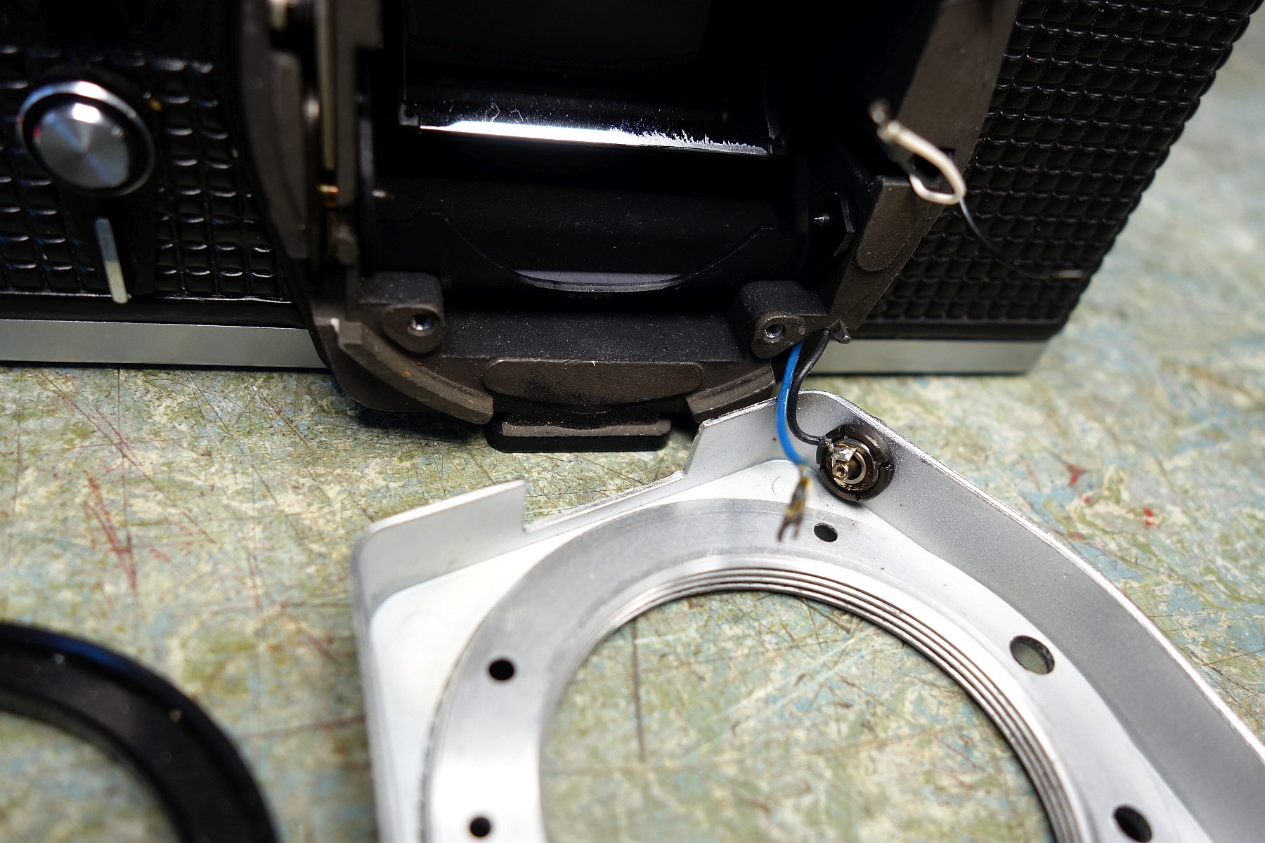

Many thanks. I removed the plastic ring as per your post #8 and replied on post #24. It wasn't so bad to remove the ring and I used a thin screwdriver to push it forward. There are two wires on the flash sync socket and one had come adrift because of a missing screw. When I got the camera I recall a screw falling loose from somewhere, but because everything worked, I just looked the other way! That's where it'll've come from. I'll find another.

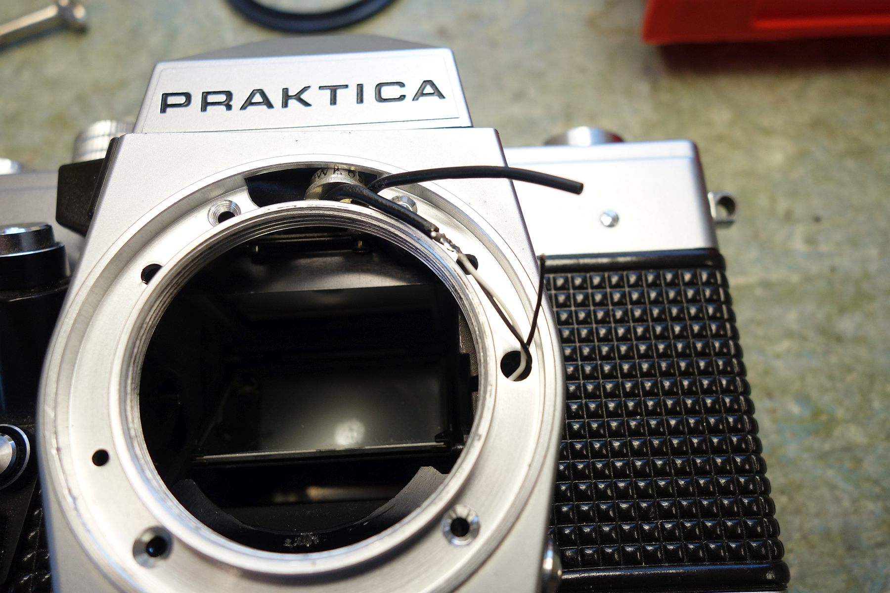

Here are pics of 1): desoldering the LDR pending removal of the bezel and 2): the rear of the flash sync socket with the LDR wires tucked away. I noticed there was about an inch of slack on all wires so I hope I haven't yanked anything off! :surprised:

I wonder why the center pole is not soldered too, but screw contacted.
One may argue that the core due to its smaller size is more heat sensitive, but other PC connectors are soldered too.
When I put it back together, the concentric ring with the tab to which the earth return wire is soldered came away from the rear of the socket. It looks like when the socket is removed, there's no need to desolder anything; merely a case of loosening the live screw and lifting the concentric ring with tweezers, then loosening the notched nut that secures the socket to the bezel. I wondered if the ring should be sintered to the socket? It's not likely to be disturbed where it is, anyway.
I couldn't find a suitable screw, so I just soldered the blue (live) wire to a tinned short length of solid copper wire that fitted snugly into the threads, soldered it to the socket live connection, and bent it over at 90 degrees so it doesn't short to earth on the casing. It works! Well, it reads short-cct when I meter across the flash sync socket and fire the shutter on 'B'. I'll try it on a flashgun next week. Light meter works too and the black plastic ring popped back into place easily. It's channelled, so as long as the sliver of insulation is beneath the LDR connections, there's no need for any sleeving - as long as the wires aren't of equal length and likely to touch.
