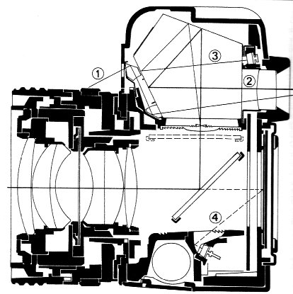

Here there is a cutaway of the VLC2:
This is a cutaway of the BX20 that shows its TTL system (alike the one of the Pentax LX):
I can't find a cutaway of the B series but I am sure it's different...so no, the VLC system is unique.

BX20 seems not so bad. I meant that TTL-OTF implementation.
It's a nicely designed camera with a lot of features, a sort of cheap version of the Pentax LX, a pity for the outer shell made of plastic that seems taken from a dashboard of a car of the 80s (good grip, though) and the advance lever very unpleasant to operate as they introduced a more powerful winder so they reinforced the steel geartrain (same sensation as the F-1N on the matter).
P.S. It appears AGX is right, the B has the lightmeter positioned like the VLC at the side of the mirror, while the BX is more conventional:
http://t.hacquard.free.fr/site1/eclates_en.html
In both cases you see underneath the skin they are well designed camera, with decent building quality equal to a 80s amateur pro Japanese camera.

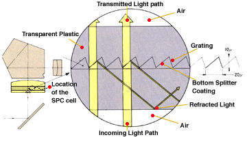

I assume Pentacon used this principle at the VLC mirror, to laterally reflect light to the sensor, that Canon later used on the screens of their New F-1:
Canon sketch
The Canon New F1's do use a beam splitter in the focusing screens, but the light metering S.P.C cell isn't in the prism housing it's in the front left hand side of the body because Canon consider it gives more accurate exposures in that position.
