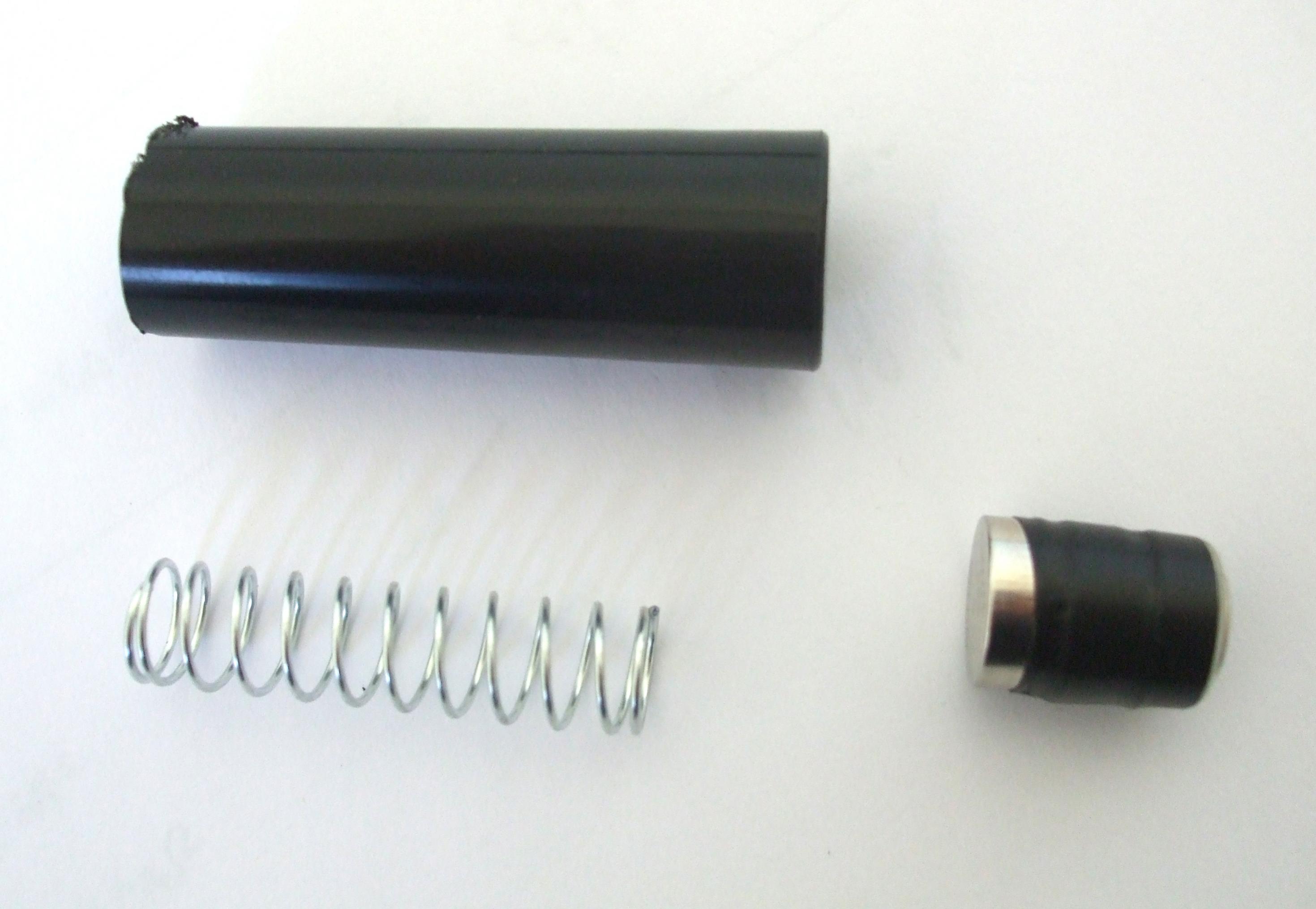

The Praktica LLC, PLC3 etc use the discontinued V21 PX 4.5 volt batteries, although you can buy replacements from battery companies which are quite expensive at £9 or so a go.
What I did was make a cell holder from the barrel of an old felt tip, a spring and three LR44 cells taped together, cost less than £1. :smile: and it works.
