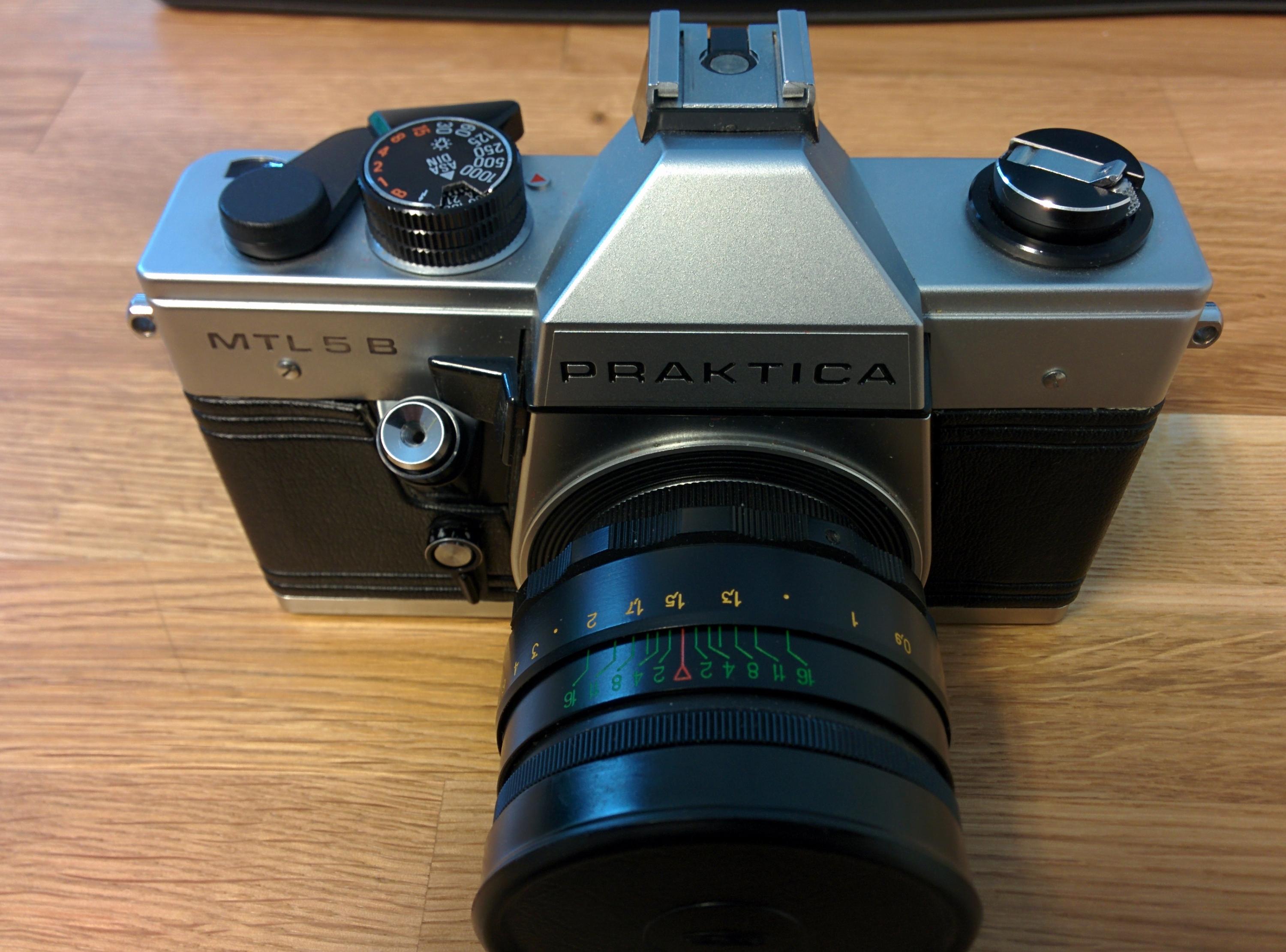

I have received my Prakticas(L2 and MTL 5B). L2 is bit smoother in cocking the shutter than MTL 5B, may be L2 is not abused. Two cameras are clean and mechanically they are all working.
attachment.php
MTL 5B with Helios 44-2.
Looking a nice glass(rather unique like 44-2) for L2, any suggestions?

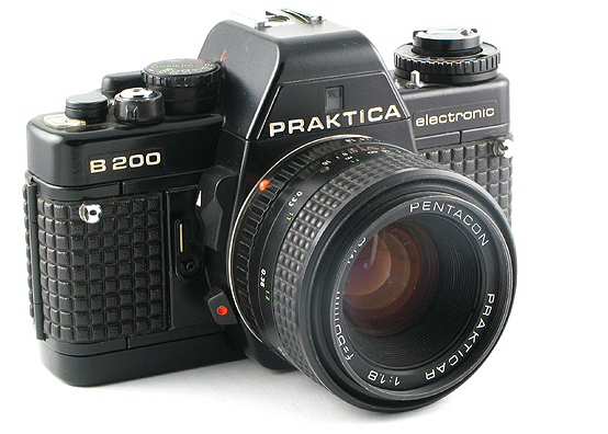

No problems with my PLC3, BC1 and B200.
The only Praktica I've had trouble with was an LLC way back in the 70's which had a temperamental meter sometimes, but I worked that camera really hard.
I quite like my B200 with the hand grenade covering!
attachment.php
I've no experience of the later Prakticas, but I'm sure they will have benefited from more experience of vertical shutter manufacture.
Do bystanders dive for cover when you whip out the B200??:D
Steve
Hi Steve,
Its a nice heavy feeling grenade, all I need to go with it now is a Zenit photosniper !

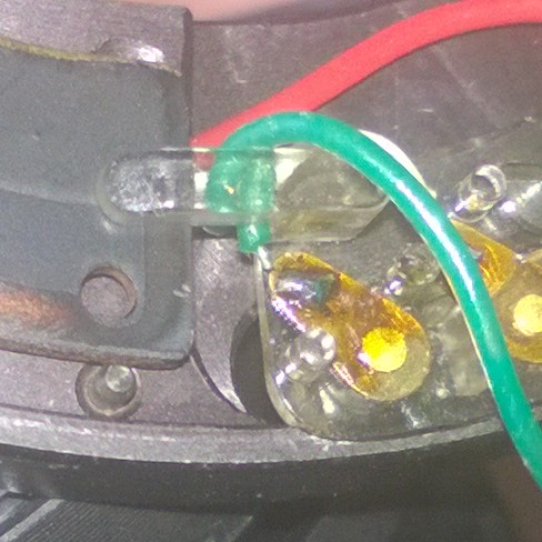

I managed to fix my 50mm f1.8. It was, just as I suspected, that a wire had become disconnected and just needed re-soldering. Everything is working now.
I repaired my 50mm f1.8 the other day. The problem was just as I suspected, a loose wire.
I re-soldered the wire and re-assembled the lens and everything was working fine.
