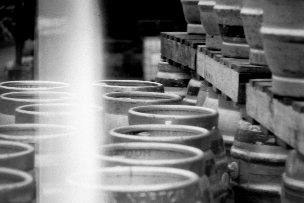

SO, after singing the praises of my BX20S which has never failed me......it's leaking!
This has never happened before, and I haven't dropped the camera recently. Any ideas? I cannot see anywhere that light could get in, everything on the back fits perfectly and the sponge around the little window that allows you to see the film type is all fine. Some shots taken inside a dark church were fine, though the first shot inside was affected which makes me think the fogging is happening before the shutter.
I love this camera but genuinely cannot find anything wrong with it.

1) Is this the first roll of film that showed this leak?
2) Are you sure you loaded and unloaded the camera in a dark place?
3) Check the light seals around the window, that would be the first place I'd look.
The BX20S has a vertically travelling shutter so I don't think the problem is there.
Sorry I thought I had already replied. The camera was fine from new in 1993 (purchased in Dresden, coincidentally) until this year other than one repair about 12 years ago after I dropped it. The fault then was that the manual shutter speeds would not select.
I used the camera extensively in the summer of 2015, and in March 2016 with a roll of Ilford Delta 3200. All films were fine, no issues with light leakage.
The first signs were two films I shot in May/June 2016, one Fomapan 100 rolled from bulk and one outdated Phototec 100 from a standard 35mm cassette. The foam seals around the window seem perfect, as does the brass hinge on the door. All films were loaded in subdued light.
I have tried putting gaffa tape on the brass hinge area and run a short test roll, with the same problem so it's probably not the hinge.
And now to add insult to injury, I got my B200 out and it's only firing at one speed despite the LED indicating the correct speed in both auto and manual mode.
