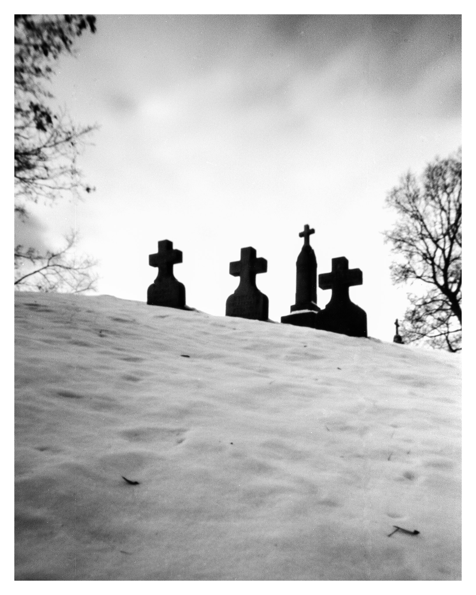

4x5 FP4, Rodinal, homemade camera:

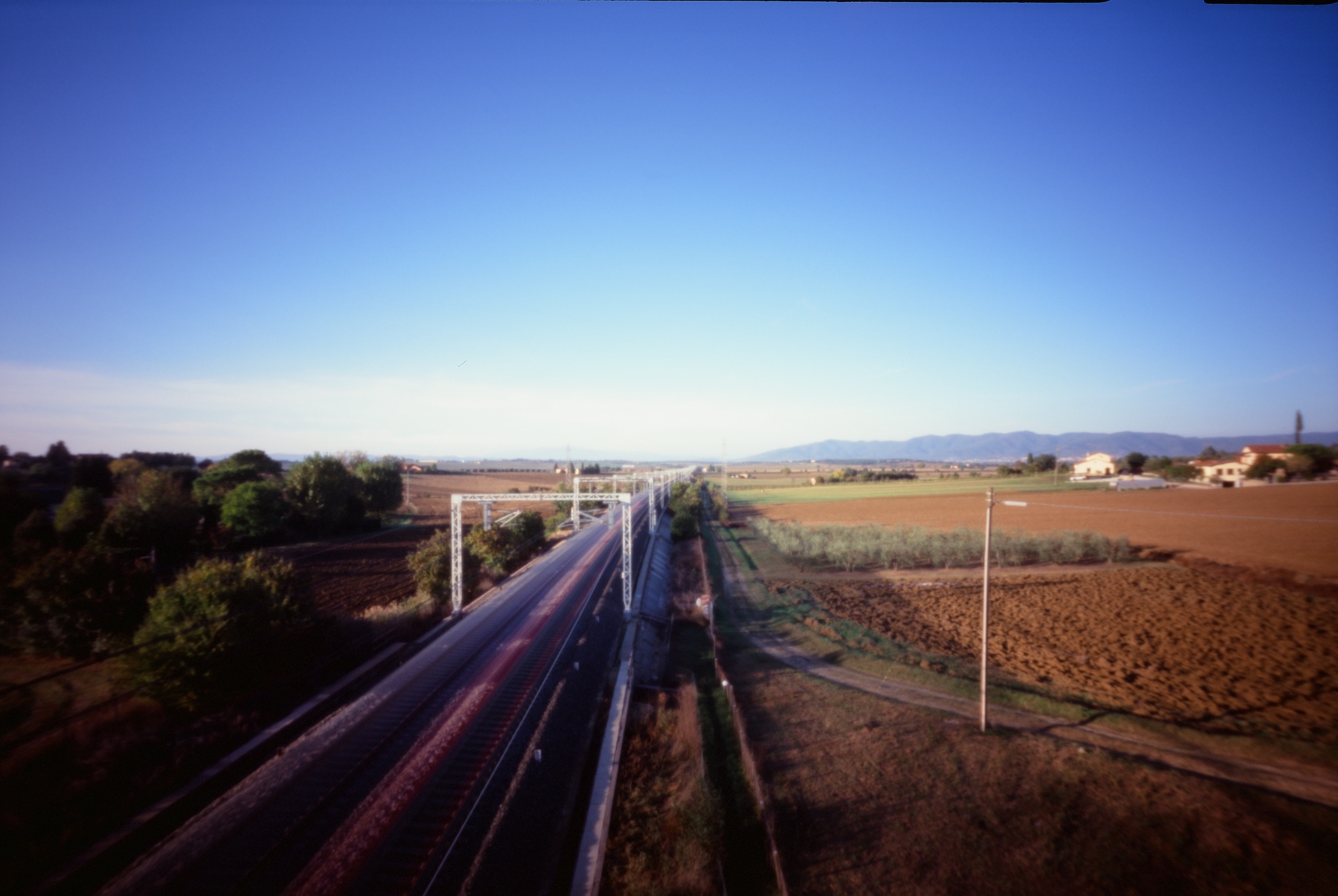

This was my first time using the Ondu in 6x9 mode. Fuji Velvia 100 ~ 10s exposure. The train is a Frecciarossa taken from a bridge near Cortona (AR).

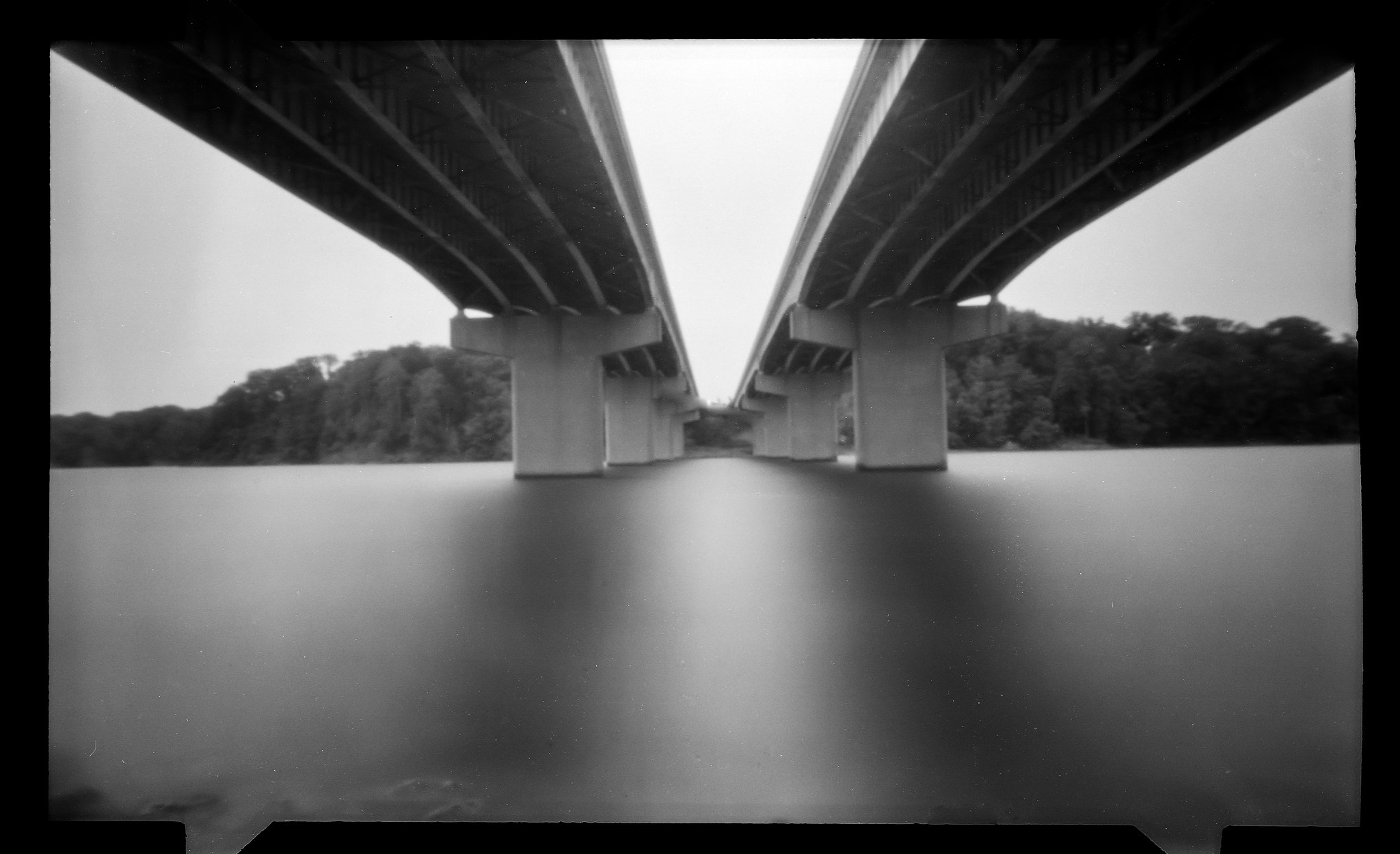

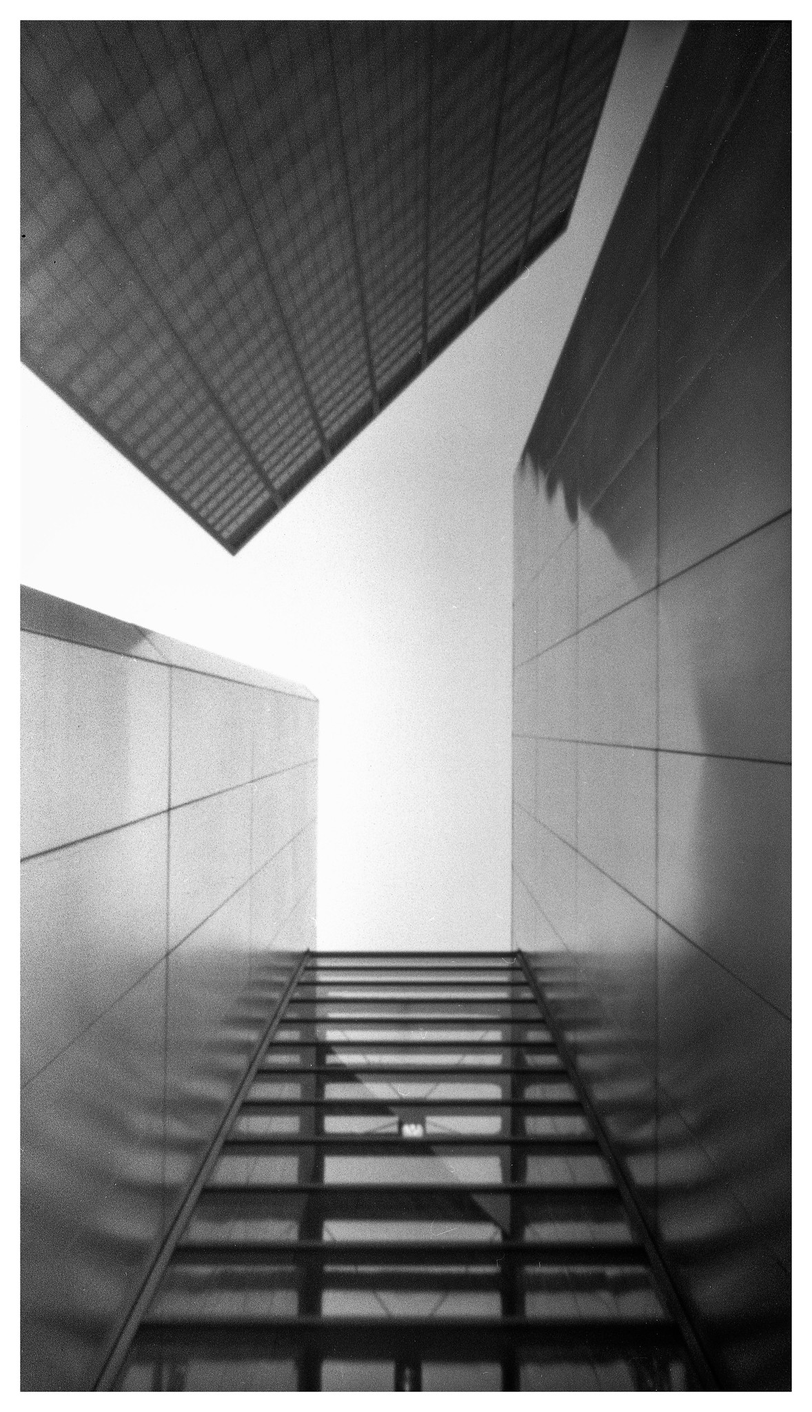

A few images from my NOON 612 pinhole camera. Most of these are shot on ACROS.
36777060716_cbd1fd9d1c_k.jpg 46810846715_b2f2eb530e_k.jpg 39485310182_bced50288a_k.jpg 24669227127_3dbf1d87dc_k.jpg 27760650949_6dcc5f7fdf_k.jpg 47727434451_0c3b5439b7_k.jpg

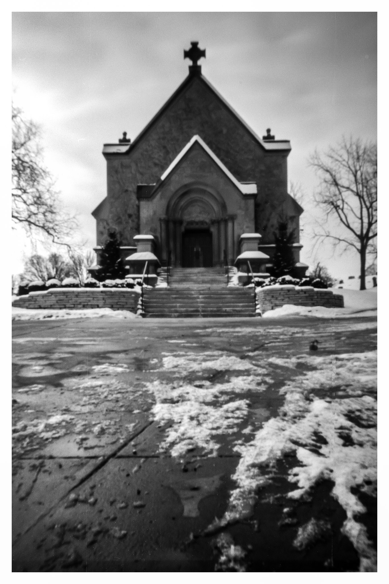

On a recent trip to New York I took this with my Ondu 4x5 Rise. Ektar 100 film, home processed and scanned on Epson V850.

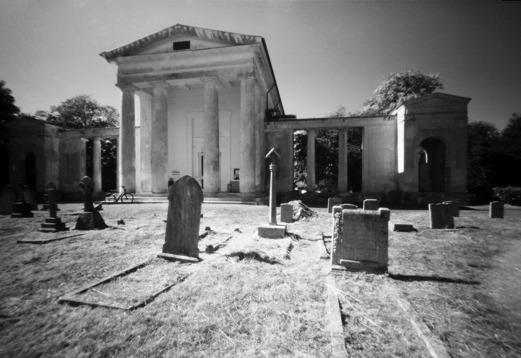

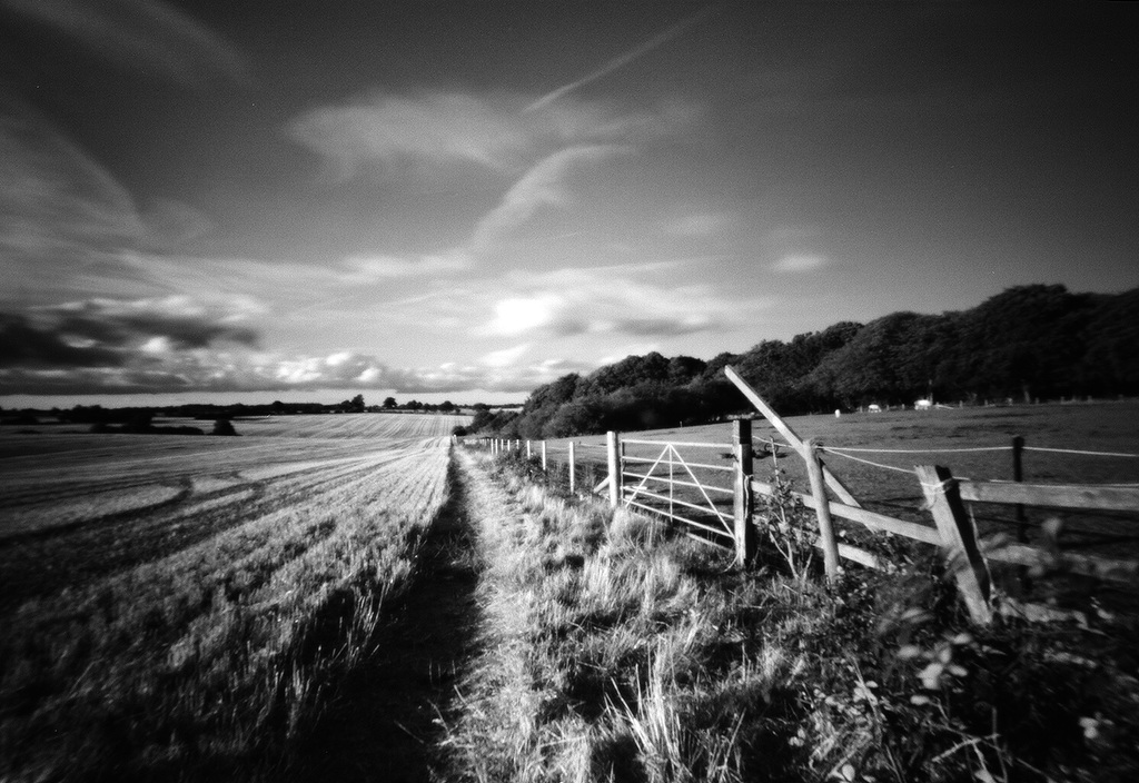

I've been dabbling in pinhole since mid-summer when I got an Ondu multiformat 6x12/9/6 camera. Here is my favourite image so far taken on Ilford Delta 400 with an orange filter.
Hertfordshire gate
par Kris Lockyear, on ipernity
VERY cool looking image!!
I got the same ONDU....I"m still trying to figure out exposure, reciprocity, etc......I'm gonna dig it out and try some more with it.
I read you used a filter...I think I got a holder too with mine, do you have a link to the filter or filter set you got?
Any idea what the exposure time was for this image?

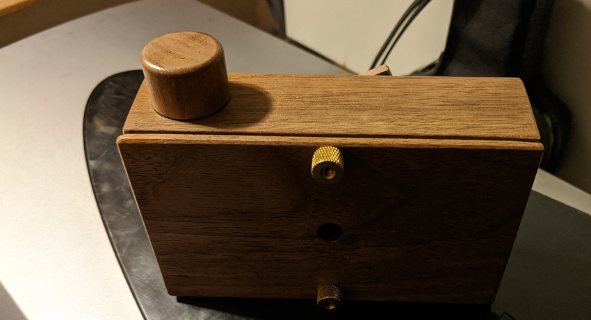

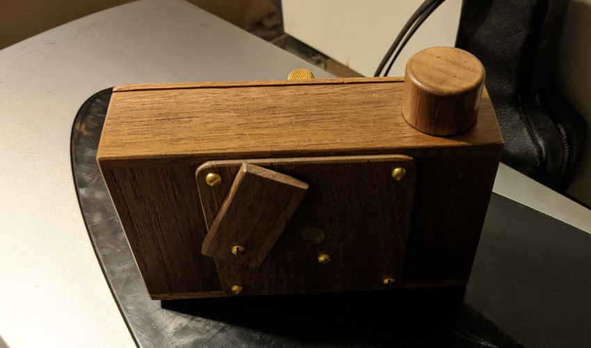

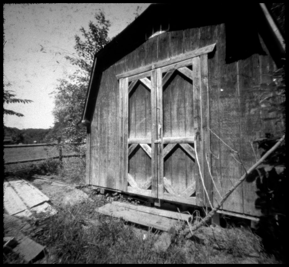

I finally finished the first test roll in my new (as in, bought new, direct from the builder) CCB 6x6 pinhole camera. CCB stands for Custom Camera Builders; they're Canadian eBay sellers, and the camera is much more reasonably priced than many of the "extra fancy" prebuilt pinhole designs. It's a "base model" camera, though -- no provision for a cable release; just a manual shutter with enough friction to stay either open or closed, wherever you left it. There's no spool control at all in the supply chamber, and the takeup has only the (adjustable) advance knob with a brass drive key to stick into the spool. One result is that the frames are slightly skewed, at least on my first roll (I may make up a pair of shims to put both spools at the same height). The camera uses a 0.2mm laser drilled hole at 30mm from the film, which is pretty danged wide and gives f/150, and has just a plain hole drilled in the back cover to view the 6x6 framing track. The interior is either flat black (inside the main chamber between pinhole and film and inside the film chambers) or covered with a foam-backed velvety material (black, of course), which both acts as a pressure plate to keep the film flat, and is one of the best possible reasonably priced materials for light absorption.
The back is held on by a pair of terminal posts, brass knurled nuts hand tightened onto embedded screw studs.
Overall, it's the kind of basic thing someone with pretty decent wood shop skills might make to sell inexpensively, in hopes of making their photo hobby pay for itself (which I suspect is a very good description of Custom Camera Builders).
Sadly, the roll of .EDU Ultra 100 I loaded for my test had two problems: first, it was Fomapan, probably the worst film choice I could make for pinhole photography in terms of reciprocity departure (an exposure that metered at fifteen minutes turned out, after reciprocity correction, to need to stand literally overnight); and second, it had been removed from its foil packet to better fit in one of those black plastic 120 film cans -- in 2006. There's just recently been a discussion about how this isn't a great idea, because it exposes the film and backing paper to humidity (even in the closed film can). As a result, every frame has black blotches (in the positive) where moisture and contact with the backing locally desensitized the film, including an interesting circular feature on the last frame, where the hole Foma punches at the film tail crease (thereby leaving a raw edge in contact with the emulsion) did this more than even the rest of the roll.
Still, I found out what I wanted/needed to know about the camera. Did I mention it's WIDE? I'm seriously not used to 30mm on 6x6 (and it's been a long time since I made pinhole images with my homemade cameras like Gumpintoids, Pintoids, and such).
Still, lots of fun. More than worth what I paid (about $70 including shipping from Canada). With good film and shims to keep the film path straight across I expect the only artifacts to be the sort of brushed edge, where the velvet material projects its shadow to define the frame. And I'll get used to the (roughly 17 mm equivalent for 35mm) wide angle. It's flat film, so at least fences and walls won't come out curved.
CCB 6x6 Pinhole, .EDU Ultra 100, Xtol-R Stock
It looks like you have a great platform, despite the Fomapan/EDU 100 and I look forward to seeing more, especially in either HP5 or Tri-x 400 @ 200 ISO.
Have you posted pics of your new camera yet, I'd be interested to see it.

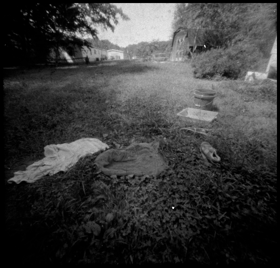

This is Magheramore, a beach in Wicklow, Ireland, taken on a Holga WPC, with the pinhole replaced by a 0.25mm.

Don't have a picture on my computer yet -- I'm much more prone to take pictures with my cameras than of them -- but I'll try to remember to post one. Seller's eBay store (no affiliation).
Okay, here are a couple pictures of the camera, taken with my phone.
Simple, but well made.
That's a good looking little unit, simple is often best, as there is only a bit of math to fuss over, IMO.
Thanks for sharing.

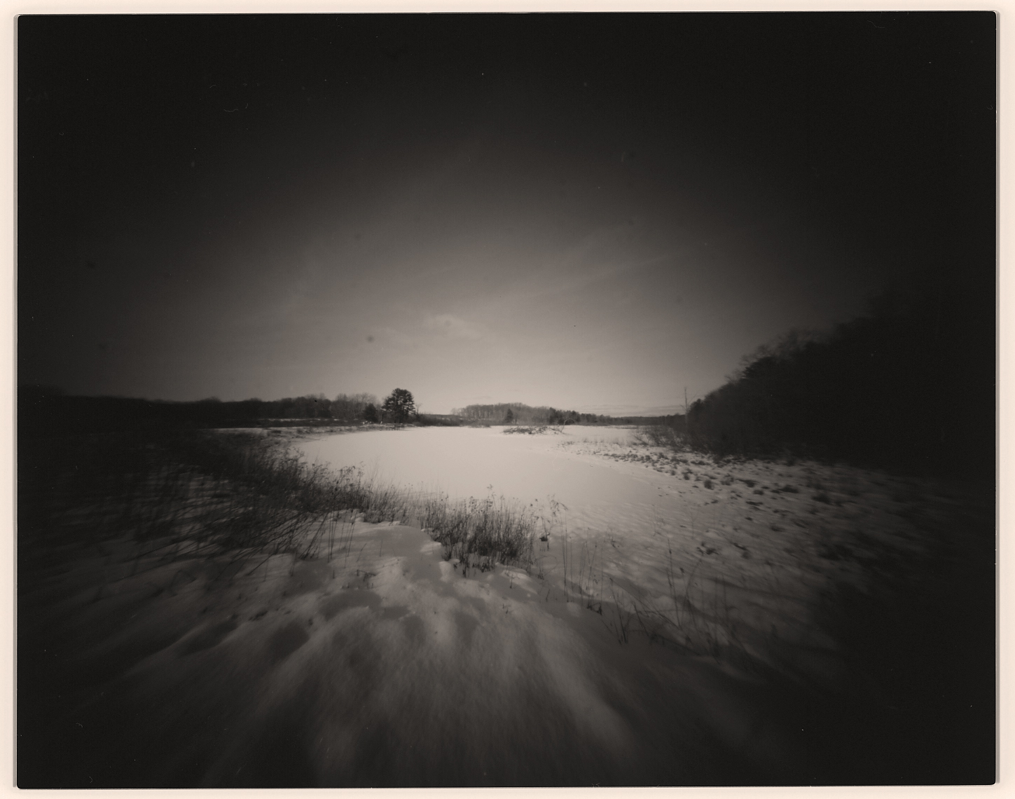

The other day I took a hike with my sister at the Erie National Wildlife Refuge in PA and could not leave home without my camera. I wanted to see what the ZeroImage 4x5 using the 25mm would do - how wide is it really? Using Delta 100 expired in 2017 and exposed at ei100, developed in HC110 dilution 'H' I'm not entirely disappointed. There was a 1stop ND filter which I did not compensate in exposure for, however I am discovering the same marks on all my negs in the same place, so I'm thinking it's probably something on the filter. - Need for more testing. I would like to experiment with stronger ND filters, but after reading another thread about dust I have to question whether it will work or just be another headache. It might be that I need to just use a slower film or paper negative to slow the exposure. Filter is behind the "lens"
Thoughts?
That's a pretty nice shot. The problem with filters is that unlike a lens, a pinhole is more of a 1:1 ray tracing exercise and any little bit that blocks a ray shows up. Thanks to direct proportion, the closer the dust to the pinhole, the larger the effect will be. It doesn't matter whether the filter is in front or back of the pinhole, other than in back might shield it a little from dust while out walking around. A few years ago I tried a filter with a body cap pinhole on my Bronica (6x6 format). I had a shot or two left on a roll of tungsten Ektachrome, so I taped a conversion filter in front and it basically worked, I scanned the transparency and put it on the web but never actually attempted a large enough print that might have made dust obvious.
I use pinholery as my excuse to be a bit loose, so I likely wouldn't worry much about a stop or two of over exposure if I had a reason to want to use a longer shutter opening. In my first pinhole attempts in the new millennium, using a 4x5 press camera with a pinhole and shutter flap on a homemade lens board, I had purchased some 400 ISO film thinking "oh, microscopic F-stop" but then discovered that slow speeds around 1 second+/- are pretty tough to control reliably with a swiveling flap shutter. So I ordered some 100 speed film, but I did get usable results, if a bit "bullet-proof," with 400. Haven't looked recently, but there may be some even slower films out there in 4x5. My last few years of pinhole work has been on 8x10 X-ray film with a home brew camera. I've pretty much zeroed in on pulled development in HC110 1+63 to rein in contrast, so my exposures are around EI 50 which generally comes out to several seconds even in full sun.

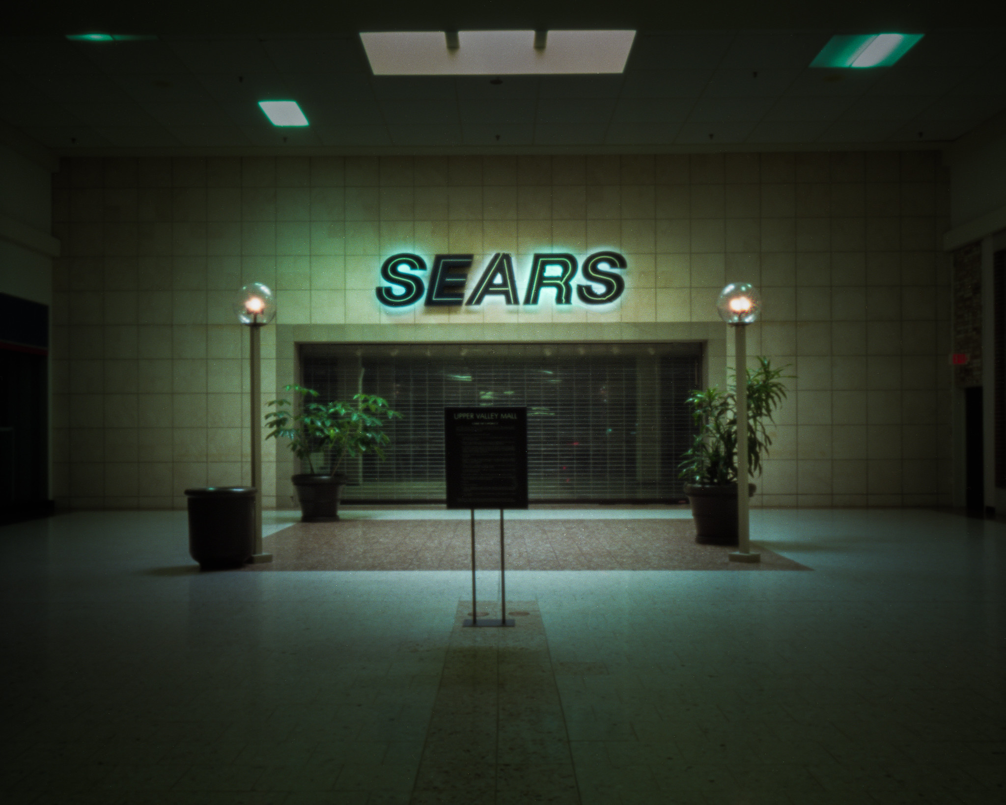

"SARS" - the death of a shopping mall in Springfield, Ohio.
Dora Goodman Zone medium format camera with pinhole front on Kodak Ektar film. 20 minute exposure.
