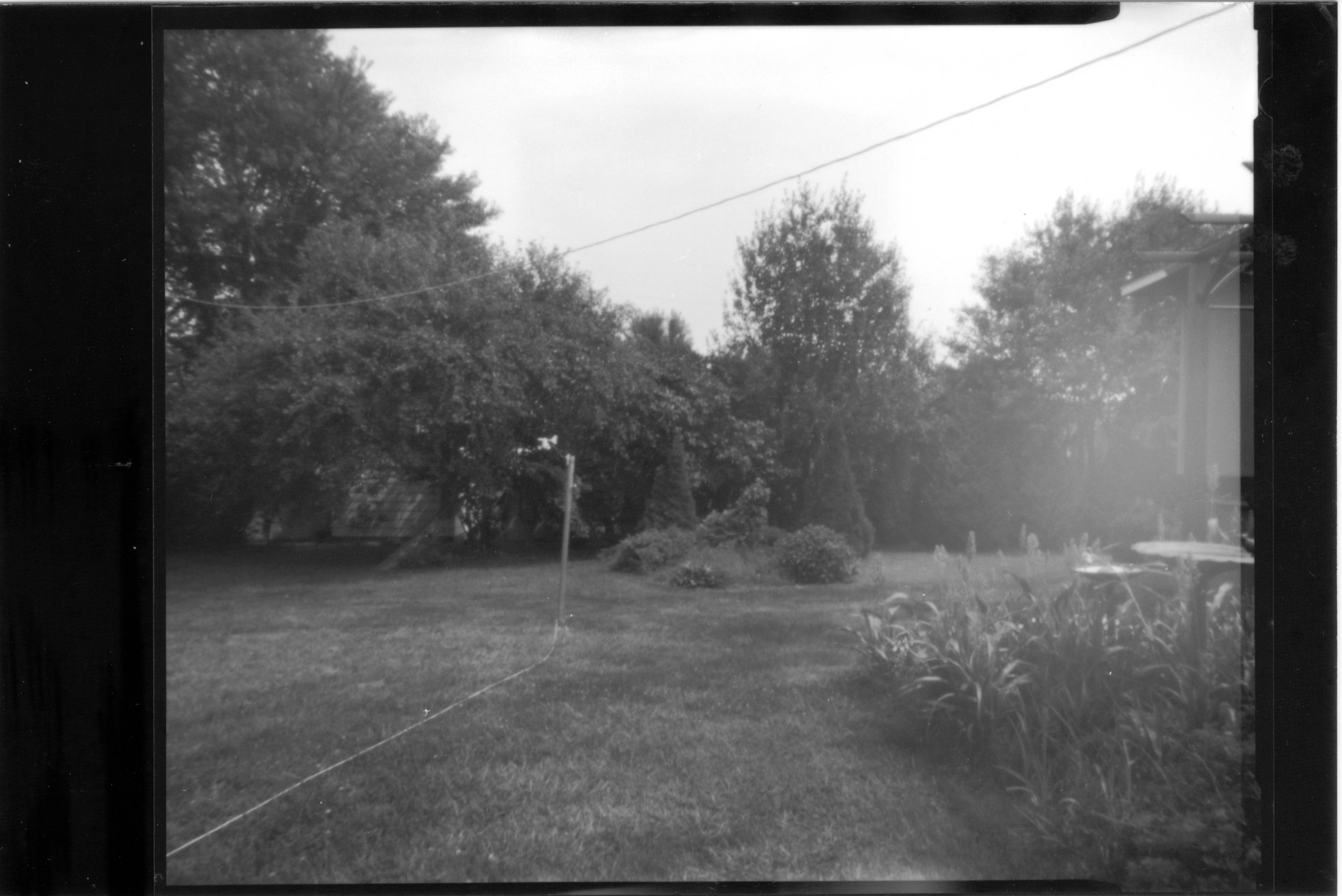

You cant tell if it is clean with the naked eye, mine looks like the way you described. You could blow some compressed air through it just in case. Your main problem is the light leak, really need to fix that before you can sought out any other possible problems. Maybe you can cover the film holder with a dark cloth when exposing the film. Seems to be exposed about right.First pinhole for me, and first film in this camera. I need some advise...
4X5 Pinhole Camera; estimated f-stop 256; shutter open 6 seconds.
Film Arista EDU 400
Film Developed 8 minutes @ 68F stock D-76
Contact printed on Ilford Multigrade IV RC Portfolio Paper; 24 second exposure (but I know this might not mean anything as it depends on enlarger height, and f-stop used); Dektol 1:2 for 1 min 30 seconds.
Contact print scanned into computer.
I'm looking for some advise. This is my first "playing" with a pinhole camera. Opening the "shutter" and looking closely at the pinhole itself, it appears that it is a tiny hole made of lots of little holes. Like a super microscopic screen/sieve. Is this normal? I feel the negatives have a soft-focus look to them. (tripod is sturdy, I don't think it is camera movement. (maybe "wind blowing tree movement?, but day was pretty calm) So I'm wondering of the "pinhole", being made of a dozen or so micro-holes would be the cause of the soft focus. Has anyone else experienced this, or have a pinhole that is like this?
I also see my film holder seems to have a light leak where the film is inserted (fogging on right side of photo). I bought these used on "some auction site". Maybe the seller knew they leaked and wanted to get rid of them.
If anyone has ideas on making film backs "light-tight" please pass along a trick, a link or a paragraph.
I guess I was expecting "super crisp" negatives with everything in perfect focus.
Thanks,
REAndy

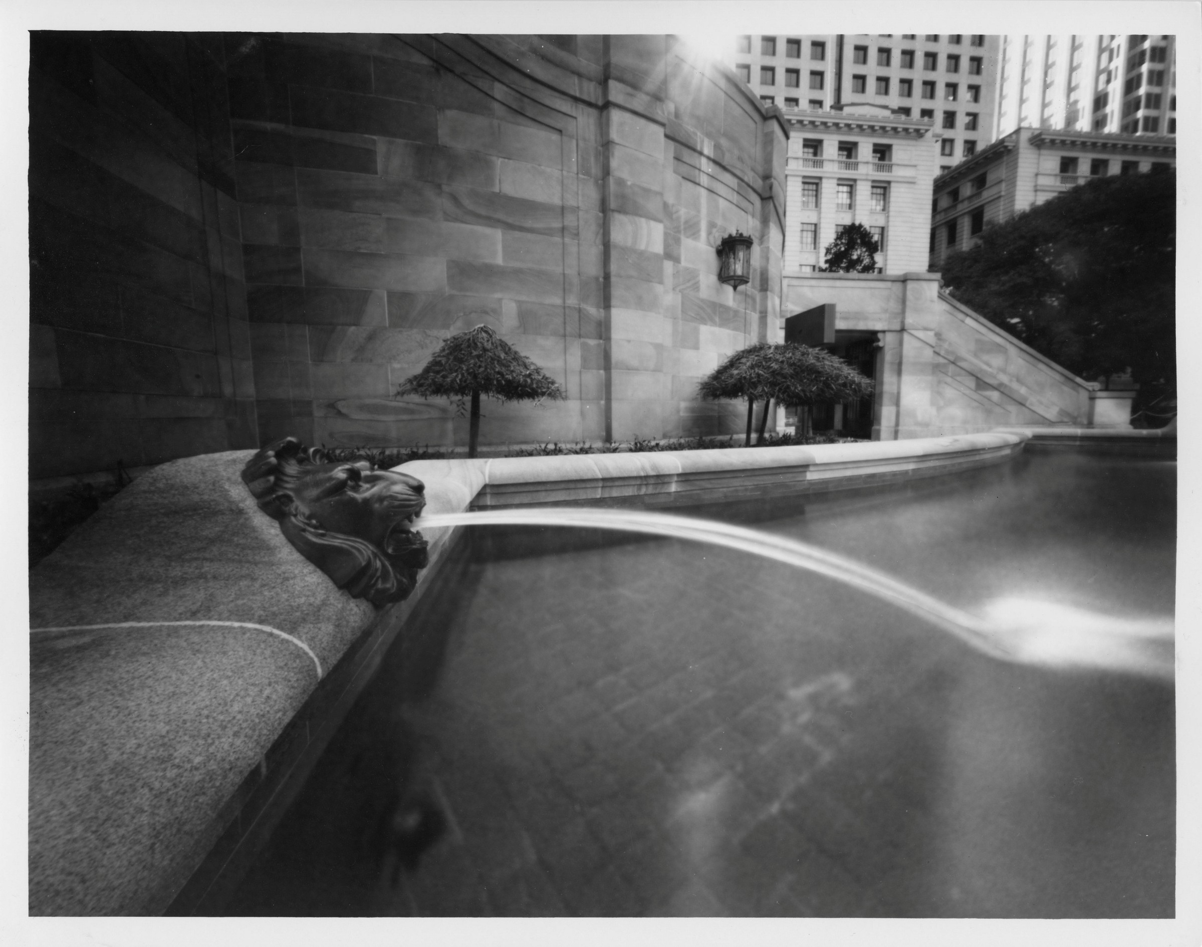

Yippee!
This is my first pin hole picture (well, that was exposed correctly). I bought a f250 8x10 and a box of edu 100 film. Managed to calculate the exposure correctly at about 45minutes. Wanted a little more of the water spurt, but hey I got the sun and everything else. Had the try pod in the pool about half a meter from the lions head.
Andy, I am familiar with single pinholes, which I have used, and zone plate, which I have not used. I am not familiar with a pinhole camera having a dozen or so holes. I would think that would give a much softer, perhaps glowing image than a single pinhole. I would think you could remove the multiple pinhole and replace with a single pinhole, for sharper images....it appears that it is a tiny hole made of lots of little holes. Like a super microscopic screen/sieve. Is this normal? I feel the negatives have a soft-focus look to them.
Did you completely remove the dark-slide during exposure or leave it slightly inserted in the film holder? Sometimes leaving it just barely inserted can cause light to get in. What ever, don't be to fast to blame the film holder, it could be the camera back it's self that is letting light leak in, or some other part of the camera construction. Also, could it be that the sun was hitting your pinhole causing a flair during exposure? That is another caution that you need to take.I also see my film holder seems to have a light leak where the film is inserted...
If it is the film holder or camera back, one simple tool is to just keep a black T-shirt with you and drape it over the back of the camera during exposure.

No one noticed me that time, but I have had to explain my wooden box to security guards before, some just cant comprehend that is a camera, just get puzzled looks when I take the film branch off and show an empty box.Well done, Paul, the lion is impressive. How did you get away with having the tripod in the pool in what seems to be a public area?
+1Shane:
A beautiful image!
