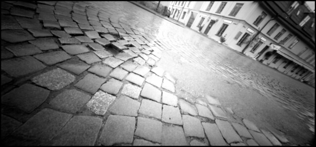

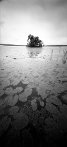

My all together first shot of the year:
436 wpc agfapan 05
by Johan, on Flickr
One of my last rolls of this agfapan (which turns yellow in the base after dev..) This time developed using HC-110 (3,5ml per roll for one hour. 5min/agitation) Holga WPC.

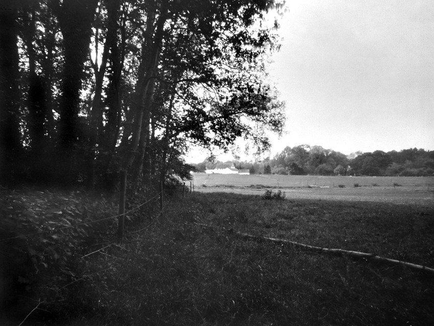

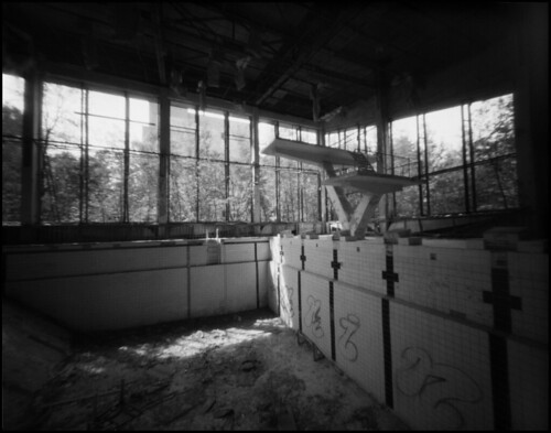

2 recent images on trying out a 4x5 wide angle using an old pre war Linhof 4x5 so paper negs are in conventional sheet film holders, pinhole in very thin brass shim since these were taken I have had to modify internal flare but suspect the holders or light seals on the body. Applied quite a bit of USM to give a bite to the details (I am not crazy about too much softness of pinhole imges). I also pre flash prior to development.
1st. Image: Local Old Farm. 4x5 hacked pinhole camera using paper Negative Ilfospeed2.1M @Iso 3. fl.60mm dia. 0.30mm f200. Expose 20mins. in weak sun. (light in Belgium...)
At this focal length the coverage is falling off quite a bit.
2nd. Image: Local stream. Exposed 1hr. (sun kept hiding, Belgium afterall).

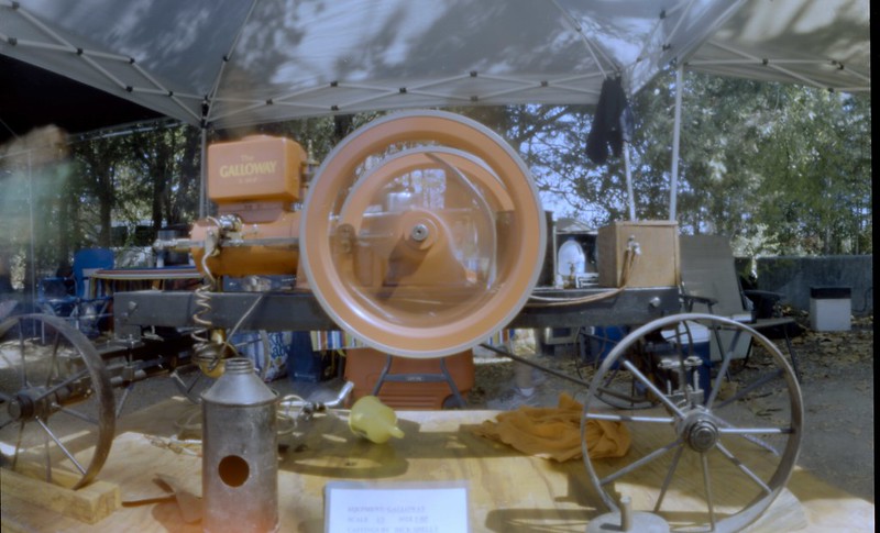

Hi, new to forum. I'm excited to find this place. I've been dabbling in pinhole for a while. I recently made an expensive impulse purchase of a P.90/2 6x9 pinhole camera from Mottweiler Studio. While I don't believe that cameras need to be expensive to be good I have to admit that I just saw this thing and had to have it. I very much admire the work of others in B&W but have been mostly disappointed in my own results. I see, think and compose in color. Here is one of my first images with my new camera.

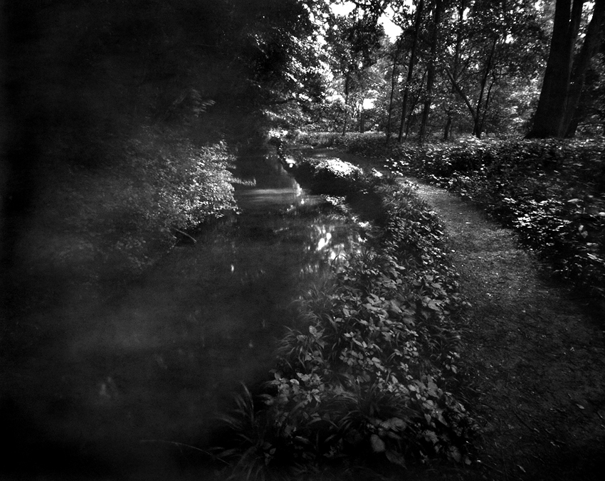

Pinhole Panoramic
by Narsuitus, on Flickr
Arista.EDU Ultra black & white 100 ISO 35mm film in Holga - 120WPC wide pinhole camera
51mm pinhole to film plane distance
.3mm pinhole
Tripod mounted
f/170
2 1/2 minute shutter speed
94 degree horizontal angle-of-view
Film developed in 1:1 Kodak D76 at 20 degrees C for 13 minutes.
Epson V850 flatbed scanner
