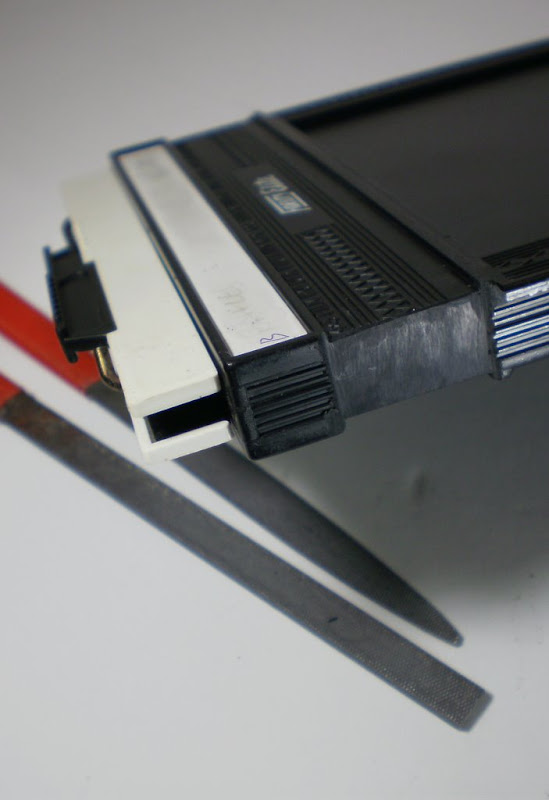

2. Make Ditches for Bite-In
If you are good at machine, and happen have tools, you can make ditches on side of the holders, let clamps grip the holders by "Bite-In", it is the best solution I can get now, but you need tools to do it. The ditch is 1.5mm wide, 20mm long, and 2mm in depth.
Here I use TOYO holders, whose side are without ditches, but with these ditches I made, they are feasible for Byron now, holders is securely hold.

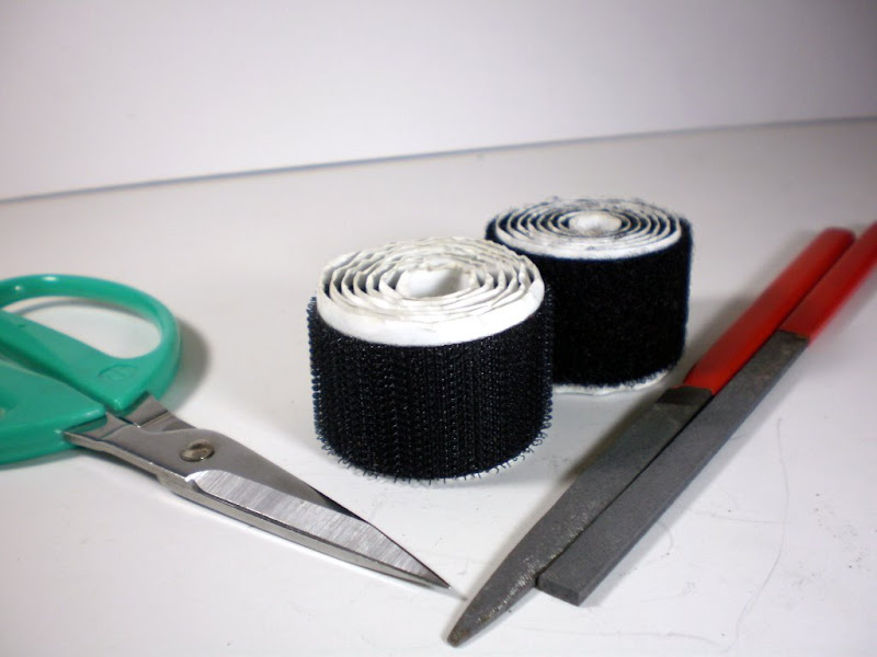

3. The Velcro Way
I know that ditches way is difficult for average people, so there is an easy way, what we want to prepare are velcro tape, a pair of scissor, and file.

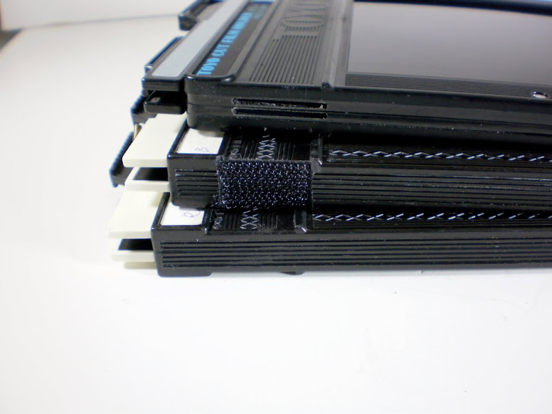

File both side of holder, to make room for velcro tape, you can compare original holder and the one who been filed.
Then cut the proper size of velcro tape (hook side), paste it on both sides of holder, now we provide very good "Bite-In" zone for clamps!
For comparing the "Bite-In", we list three ways in a row, you can choose an option you like. Now, the DD slide holders are not limited anymore, any holders allowed!!

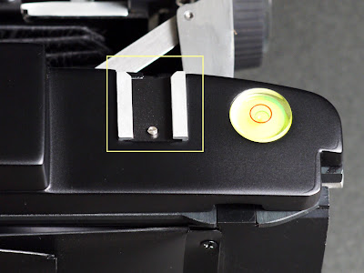

Walter Garcia in NY added a bubble on Byron, how creative! I love the idea!
I should try mount one on my Byron!
Thanks, Walter, great idea!

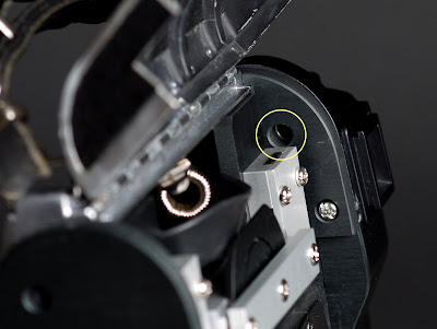

Now I took time mainly on developing Emily, WA 4x5 shooter, based on J66 body, almost the same as 110/B, except no Range finder on top, and no front door for rail, so it is a good candidate for wide angle.
All the same back system to Byron, Emily needs new bellows, new front lens plate, and a new top plate. The top plates just arrived, I installed it with two cold shoes, one for view finder, one for a tiny range finder, if uses want to, that one from Voigtlander/Cosina is good I think.
This is the position for about 47mm lens. Avoiding pig snout and helical focus ring which are popular seen on wide angle camera, I want to replace them by bellows and level, to keep it slim and easy to carry. Bellows is easy to me, but the level, that puzzeled me.
If I can successfully made it, then Emily will be a great WA camera for lenses wider than 90mm! Here I come! 47mm, 65mm!

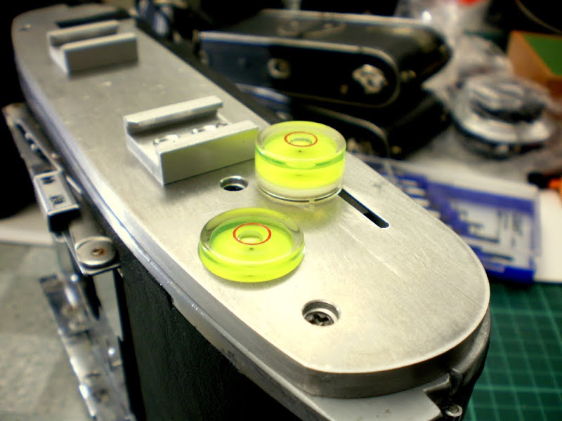

Just brought back the top plate for Emily, I did some modification---drilled hole for bubble level. Contributed idea by Walter, drilled hole on Byron top housing, I found that Emily should have one too.
bubble level is rather thick, but thanks to the plate, it is implanted quite well

RF housing modification takes many steps, and now it adds a bubble level hole.
left to right: 110A housing, 110B housing, 110b modified Byron housing, eye window adds a eye caps attachment.
and at the right side, use putty to reshape the button line,
far right side was drilled with hole for bubble level, and a dent edge for PA-45 holder.
a lot of putty, drill, sanding, and 2 to 3 layers of spray paint.
