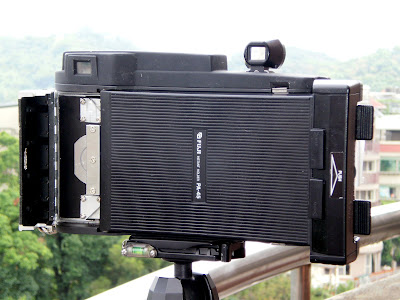

Just change the blocking plate from a pull-out-push-in into a rotate design.
When rotate to show up, the camera is ready for double-sided holder.
When rotate to hide in the chamber, the camera is ready for bayonet style holder, like Fuji PA-45
So this camera needs no any part to take off when changing the film back system, no springs, no screws, no gg plate to taking care of.

Thanks guys, now I need your help on wish list and Q&A, what do you like if any feature available? I'd like to proceed on 2nd version with new improvements.
As aristotelis grammatikakis ( one more Greek from Crete :smile: say David .. this camera is way to good and i have already send you a email with some features that i think would be good (att least for my one :smile:

To avoid vibration when shooting, best install a cable release, but put the cable in a proper place so we can operate in a smooth way is also important. I find a way to make cable fixed in front of camera, with magnets and a pen clip, you can take it off when not in use, so outlook keeps neat and simple. Cable release and holder can be store in the chamber of the camera body.
