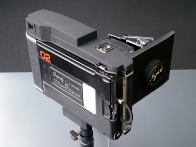

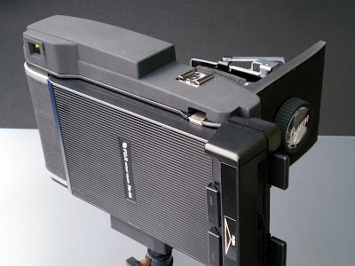

I would like to show you the project I am on, to convert a Polaroid 110B into a 4x5 snap shooter with lens interchangeable system.
It took me 4 years already, and I hope I can finish it by the end of this year!
Please tell me what you think, any comments are welcome!!

Looks like a cool project. How will you focus it?
salihonba
Mar 3, 2008
115
Taiwan
127mm lens on 4x5 is equivalent to 40mm focal length on 35mm camera, and 90mm equivalent to 25mm, so I think for such a wide angle lens, estimate and shoot is not difficult.

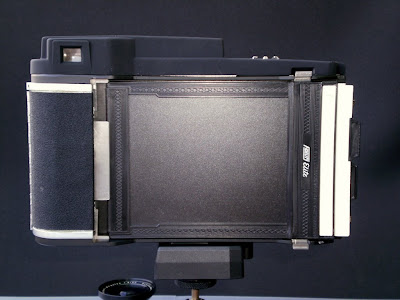

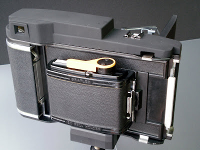

Now I am working on the back, trying not to attach Graflex film back, to keep Polaroid's own slim style, not easy, but very challenging! Hope I can have a good result to share.

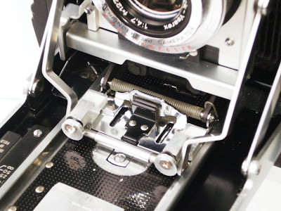

Yes I think converting 900 is a good idea, since you can make a flat front stand, meaning no size limited to #0 shutter as 110B or 110A, I alway wanted to use Schneider 120/6.8 angulon on it, who takes #1 shutter. It will be on my project list. I would not make a front stand who can shift or tilt, because it will be a snapshooter, not a view camera.
I learned a lot from Dean's site, bought his CD years ago as a started point. I also learned many good ideas from Mr.Noah in NY, hope I can make a good conversion like them.
salihonba
Mar 3, 2008
115
Taiwan
Dear John, Prontor SVS shutter is what I think very good in quality, I believe that your problematic shutter will be easily repaired, but if you would like to replace the shutter, almost any #0 shutter can be used, only problem is that the trigger is not so long in length as SVS has, so maybe you need a release cable to trigger. And the lenses, as long as the rear element is small, can go through the hole on front stand, you can pick any one. All you need is a wrench for lens, and a screwdriver only, take off and remount from inside, it is easy.
Or you can follow the way Mr.Littman suggested on his site (not anymore now, don't know why), for the purpose to use the big rear element lens but without the lens exchange ability, take off the rear element(even front element!) when folding the camera, leave only the shutter, cover shutter with a tiny cap, and when unfolding the camera, remount the rear/front element back to the place.
In my way, lens exchange is very easy, but it needs some modification on front stand, and for accommodation big rear, better replace the bellows at the same time. I do think of providing a service, convert front stand for anyone who needs it, into a exchangeable system.
