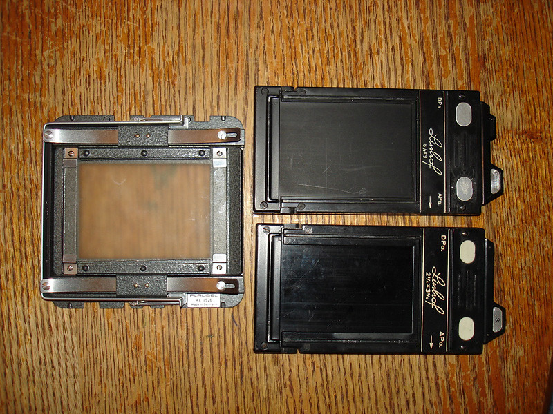

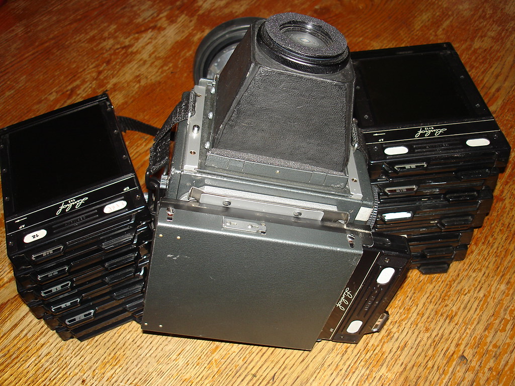

Here is my (new to me) Makiflex Sheet Film Back. On the left, are six Linhof 4x5" Sheet Film Holders, and on the right, are six Linhof 9x12cm Sheet Film Holders. These are great holders, they have a built-in pressure plate, which "presses" the film tightly against the fim plane and allows for super-sharp results. Why do I have 9x12cm as well as 4x5" film holders? Well, I have a lot in my deep freeze of both sizes of film. I just ordered 300 sheets of FOMA Retro Soft 320 9x12cm (from a shop in Germany) so I glad I have both sizes of holders!
This Makiflex Back is interesting. On the top and bottom, it has "flip latches" which you undo, and squeeze the holder into it's smaller configuration, and the re-do the latches. Then it fits 4x5" Graphic/Riteway/Lisco holders, which are much thinner than the Linhofs. All of these holders produce an 82mmx90cm image on the sheets films. Pretty cool stuff.

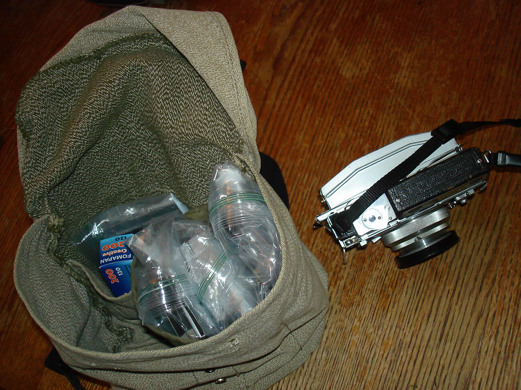

This just arrived on my doorstep today from Germany.
300 sheets of Foma Retropan Soft 320.
Will fit in above ^^ 9x12cm Linhof Film Holders and others I have. :smile:

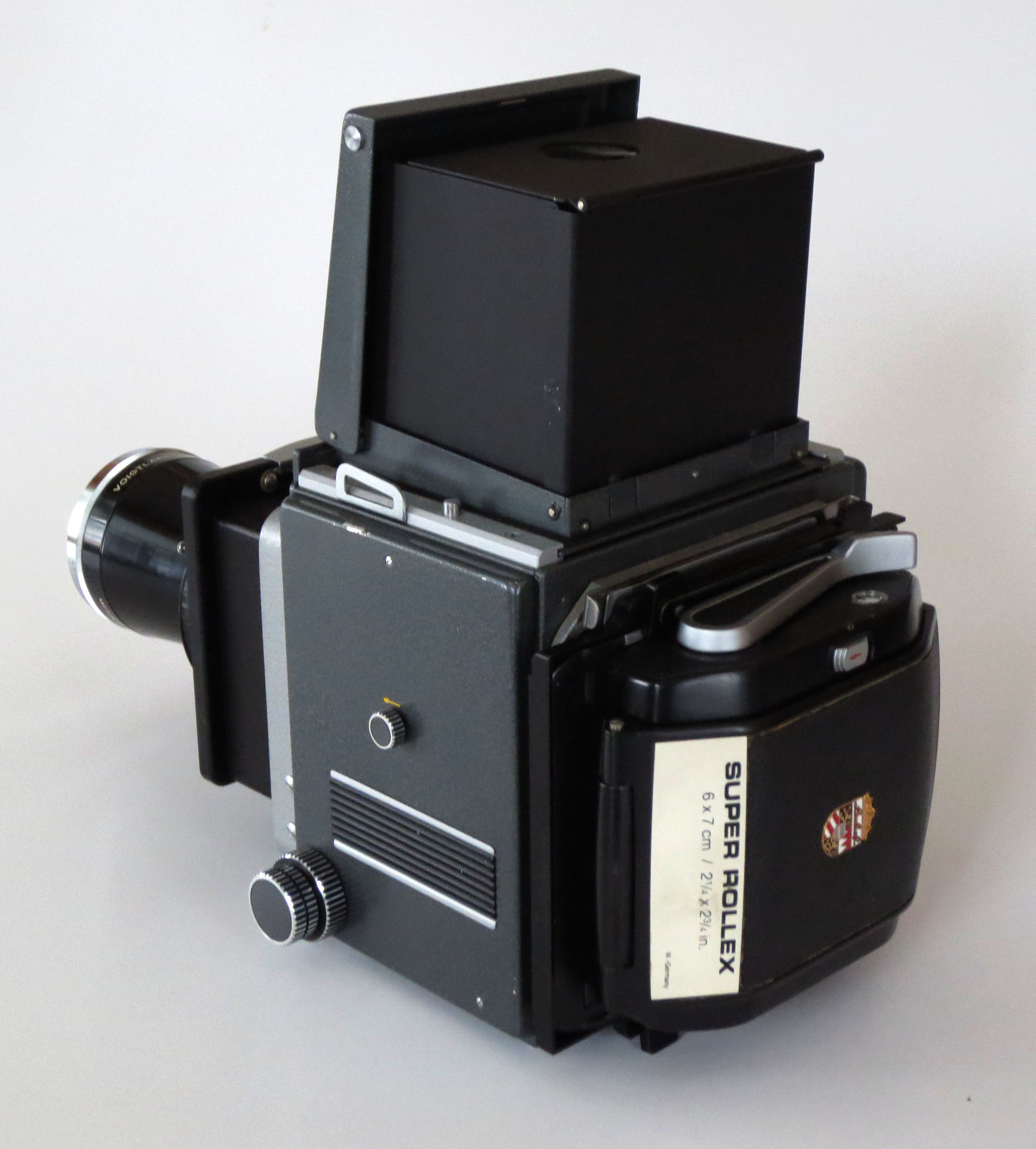

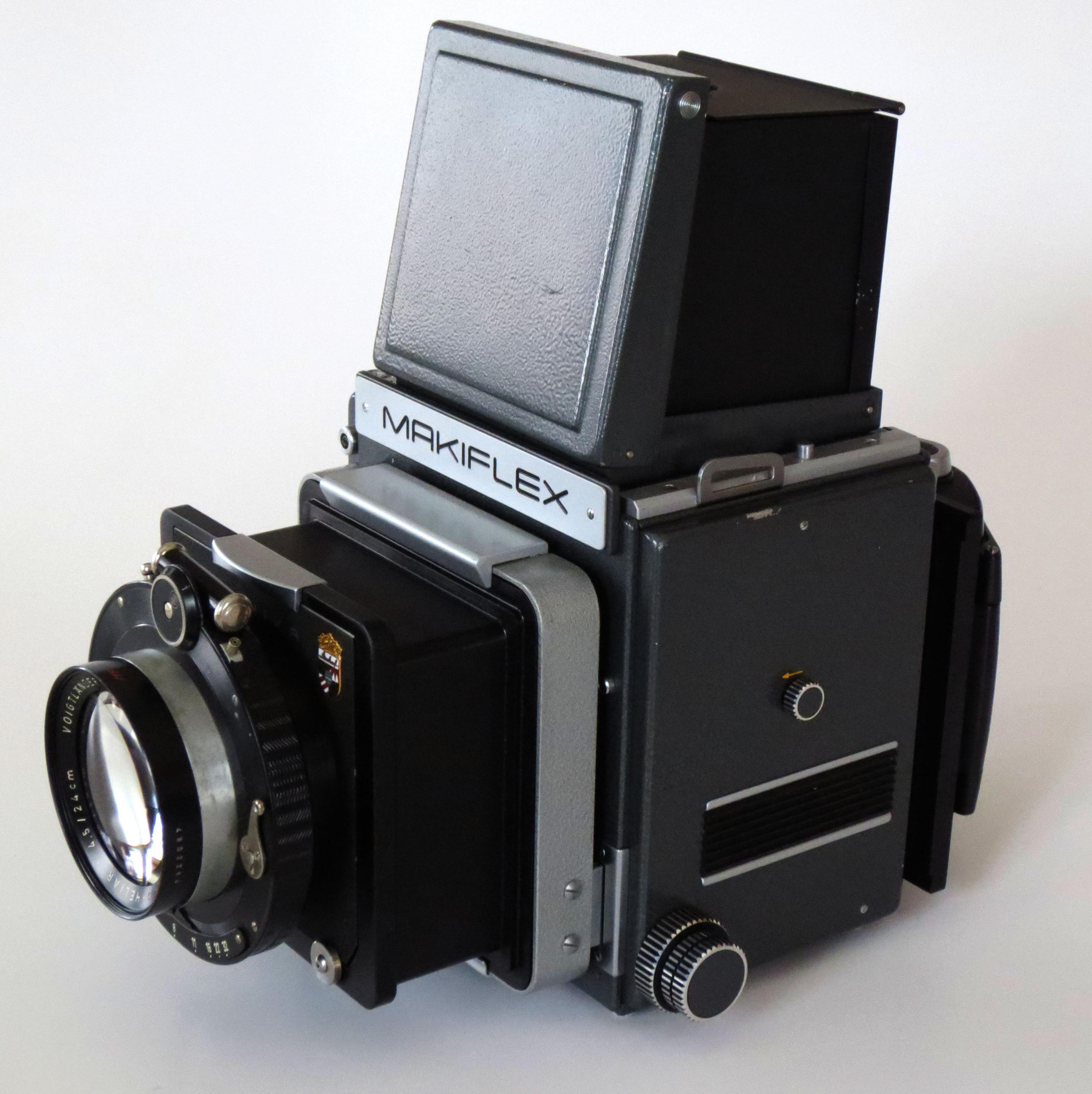

Here are a couple of images of my Makiflex. I usually use it with a 210 or 240mm Heliar. I find it a very easy camera to use. The basic camera is very robust with a very nice focusing rack. I've acquired a couple Makiflex odds and ends over the last few years, I'll try to post some additional images of those.
The adapter below allows use of Linhof lens boards to be mounted on the camera. For the back I made an adapter for accepting 4x5 accessories-- the back mounted on the camera is a Linhof 6x9 Super Rollex.

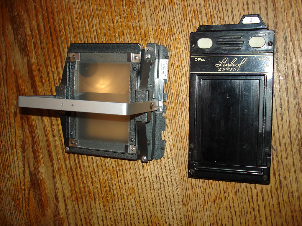

Here's a 2x3" Linhof holder I picked up for a good price. This fits in the 2x3" Makiflex Back, shown with the bail open. The extra-thick Linhof -just- barely goes in, with not much room to spare. But it fits. I would like to get some more of these, but they tend to be expensive. I also have Rigteway and Lisco 2x3 holders that fit this back.

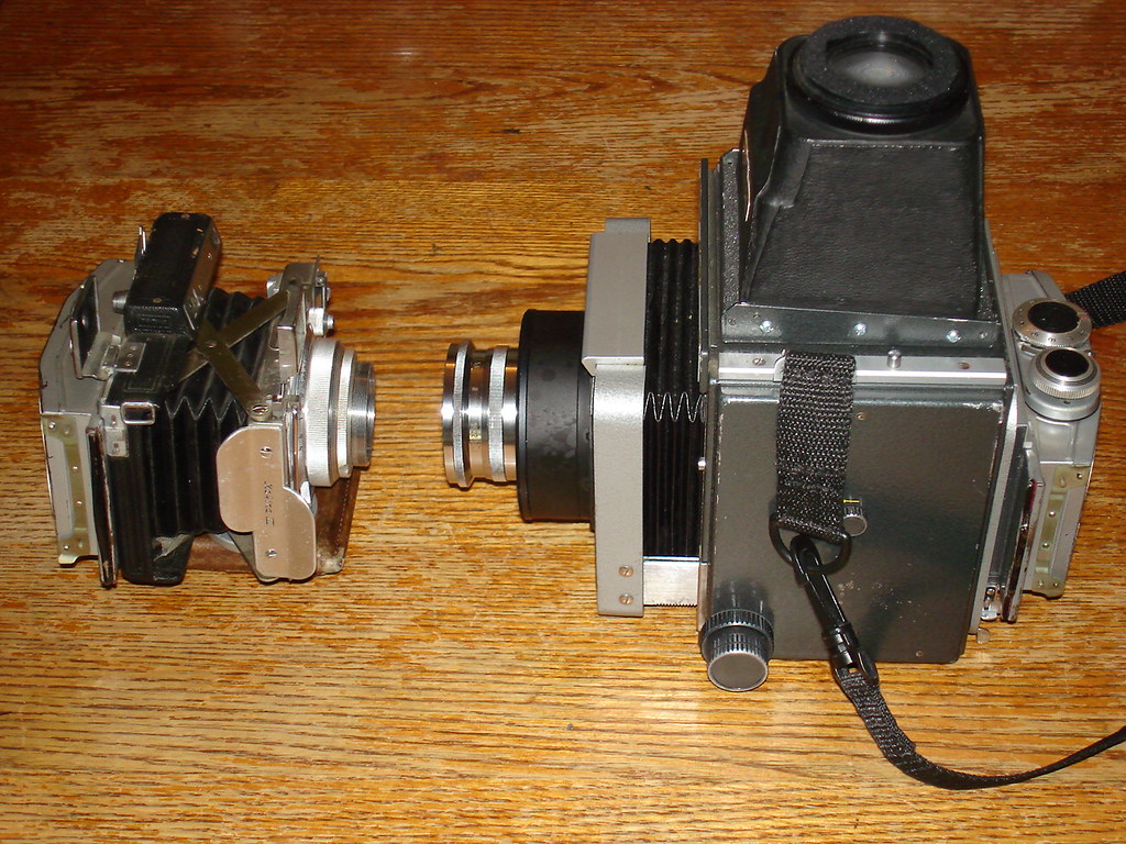

This is from earlier this summer, but I picked out a nice Makina III, which I have wanted for many years.
All the Makina roll holders and 6.5cmx9cm Makina sheet holders fit both cameras.
The Makina is great fun to use and is perfect for discreet shooting :smile: Heavy but fits in Swedish Medical Bag. So I will be finishing roll holders and plates much more quickly now that I have both cameras

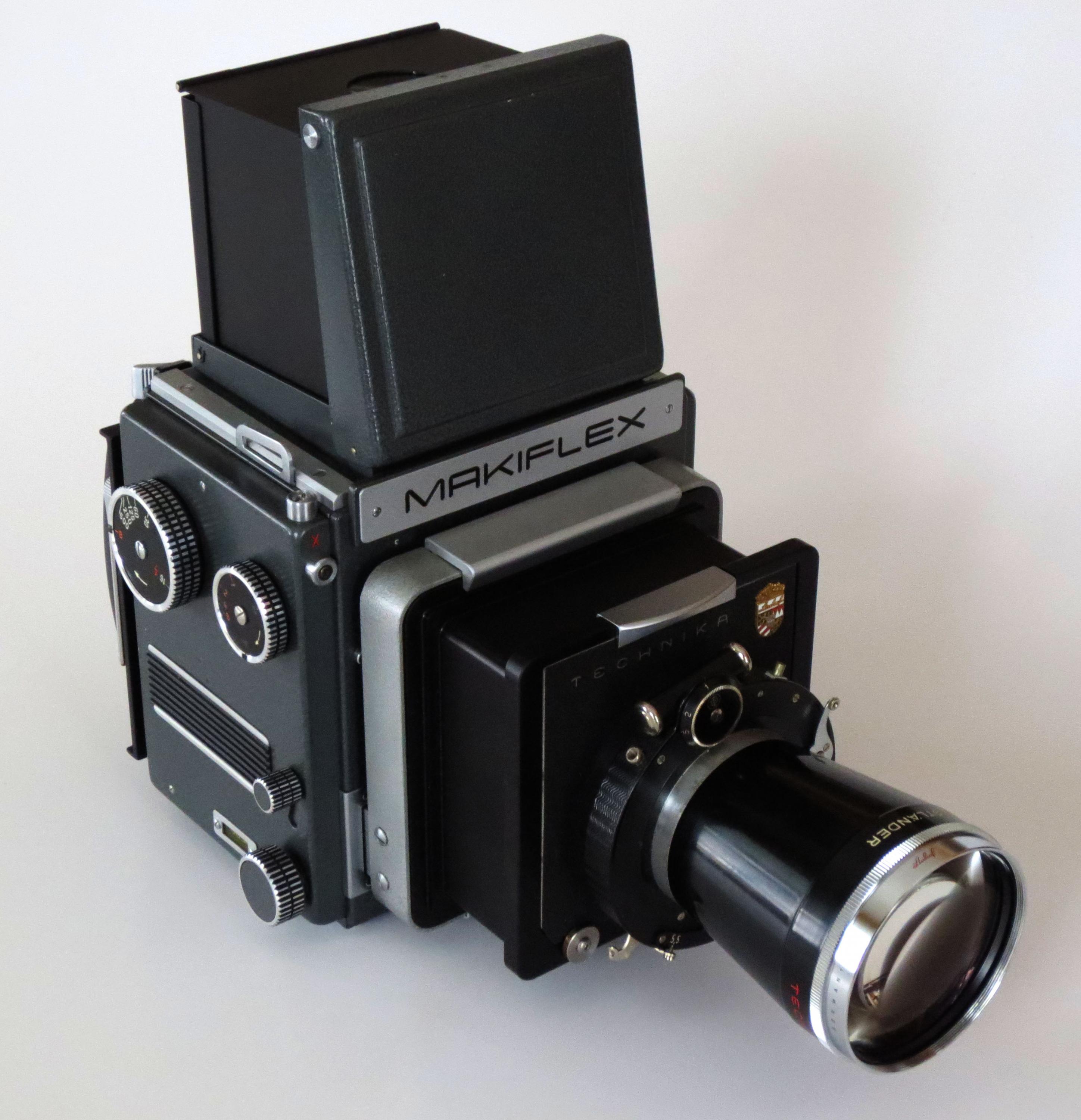

Thanks for posting, Sneebot! Great stuff. Here is one more (from Flikr) Beautiful metalworking! Hope you don't mind my posting....... Looks like 360mm Schneider Tele-Xenar, one of the original Makiflex lenses in the catalog.
Almost-- 360mm Voigtlander Telomar...

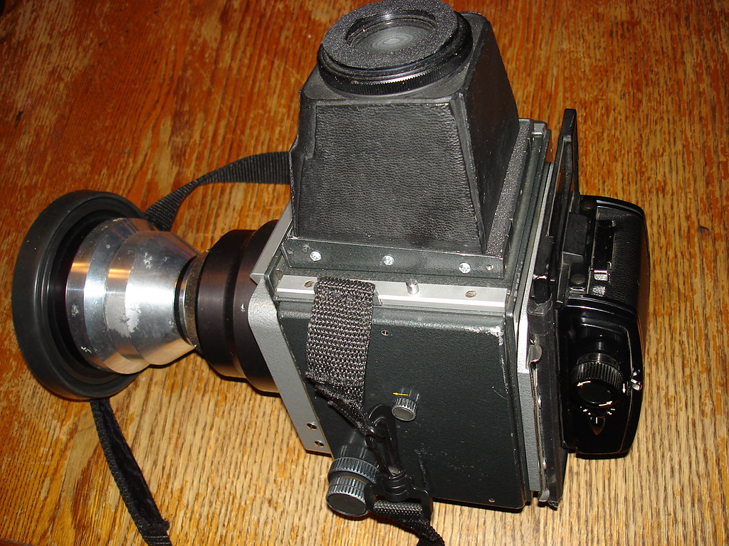

I have a 180mm CZJ Zeiss Jena 180mm F2.8 Zebra Sonnar coming from KEH that I am going to try to adapt to the Makiflex. That will be interesting, especially if the lens covers 82mm x 90mm and I suspect it prolly will reasonably do so. I may need to mount it in a Peco Jr recessed board to increase the focus range towards infinity. What a great lens, too bad the P6 bodies that fit it are so questionable. Not so the Makiflexes. And I can even shoot 6x6, I three Makina backs in that size. Weight may be an issue, stay tuned.
