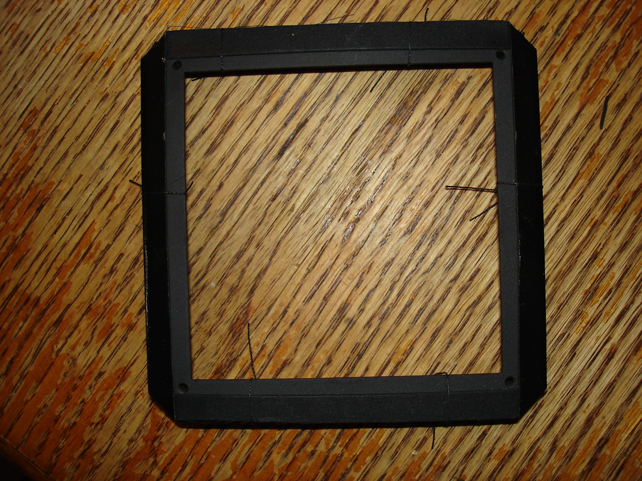

Attached are photos of the Automatic Makiflex Bellows removed from the camera. The bellows is screwed to the camera body via a metal frame, and appears to glued from the inside, to the front standard of the Makiflex body, via a cardboard or "fibre" spacer. I will let Ken sort all of that out.

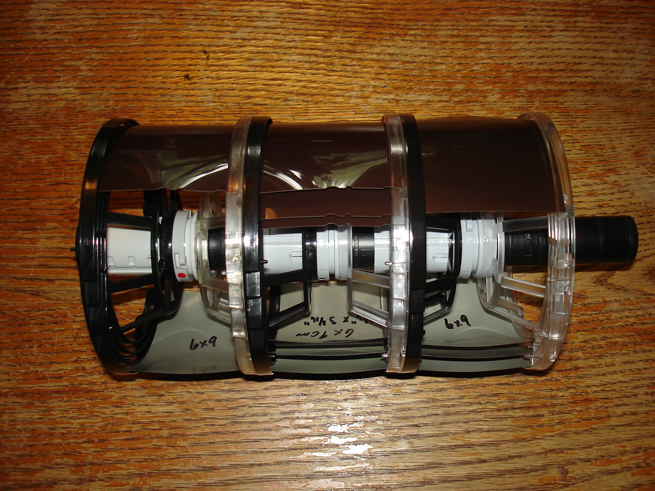

Here I am practicing loading scrap old 6.5cmx9cm cut film, onto three JOBO 2509n sheet film reels.
This setup will process eighteen sheets at a go, which I think is pretty good production.
These three reels fit perfectly into my JOBO Multitank 5.
Practicing with lights on is the best way to learn. :whistling:
Using the JOBO Multitank 6, I will also be able to process eight rolls of 120 film at a go.
I have ordered four JOBO 2502 reels for holding 120 roll film, although I still need the "red clips"
so I can process two rolls of 120 per reel. Thus, eight 120 rolls per film run. Not bad!
So things are coming together nicely. My Multitank 2 will be able to process (one reel) six sheets of 6.5cmx9cm.
This will be especially useful if I should wish to do any stand development in the future.
And of course the 2509n reels also hold 9x12cm film, so I am really set to go.

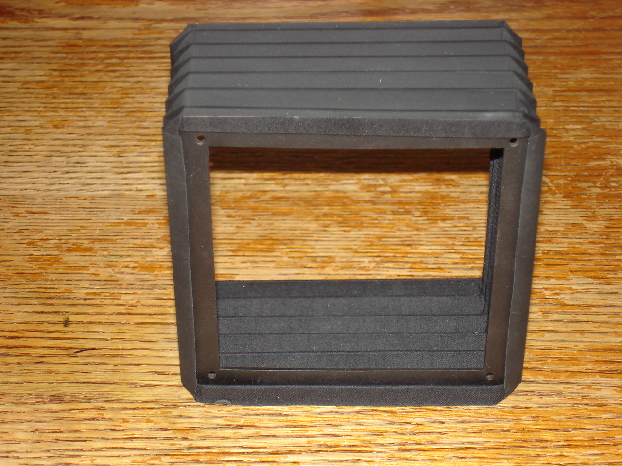

From "Custom Bellows Ltd" in the UK.
Just arrived; Very quick turnaround.
My Plaubel Makiflex Rubber Bellows.
Brand New and absolutely perfect in every way.
So now this will go with the camera to Ken Ruth at the end of June.

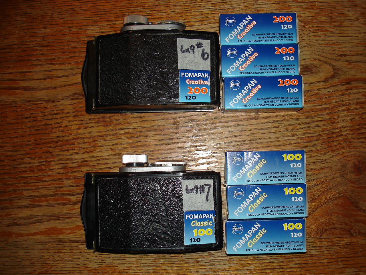

In my deep freeze I uncovered some FOMA 100 and 200 film, which I have loaded into two black Plaubel Makina 6.5x9cm filmbacks. I really like what I see on the internet with the FOMA films. Have enough 120 to do some serious work, four rolls of each. And I have a lot of FOMA sheet film which I will be loading up soon.
I have vacation time coming up ahead so I am looking forward to getting out working with these cameras.

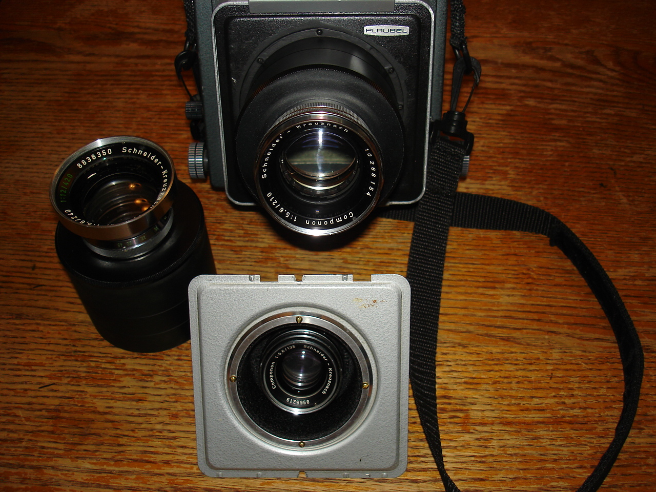

Here are three (new to me) lenses, mounted and ready to go.
On the camera is a 210mm Schneider Componon.
In front is a 135mm Schneider Componon, mounted on a Durst recessed cone.
It easily achieves infinity focus when set up this way. But not so quick to change the f/stop- but it works! And to the left, a 240mm Schneider Symmar. I really do think these chrome (60-70's vintage) lenses are the perfect match for these cameras.
I have been taking these lenses completely apart, to clean the front and back of the cell groups. All of them have become much more useful to me, without the "milky-white" outgassing deposits :blink:

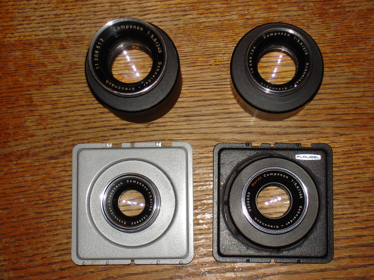

My (partial) collection of Schneider F5.6 Componon lenses, which I have just finished adapting to fit the Makiflexes. From the bottom left, the 150mm F5.6 Componon, bottom right 180mm F5.6 Schneider Componon, top right 210mm F5.6 Componon, top left 240mm F5.6 Schneider Componon.
I also have the 50mm, 60mm, 80mm, 105mm, and 135mm. In the process of revitalizing my old Omega D2 Enlarger, I intend to get my B&W darkroom up and running again.
Ken Ruth suggested I get the Componons, and I am pleased. BTW he has Makiflex #1 in his shop right now, and overall he thinks it's in great condition. Should not be a problem to CLA it, it's the the third Makiflex he has worked on.

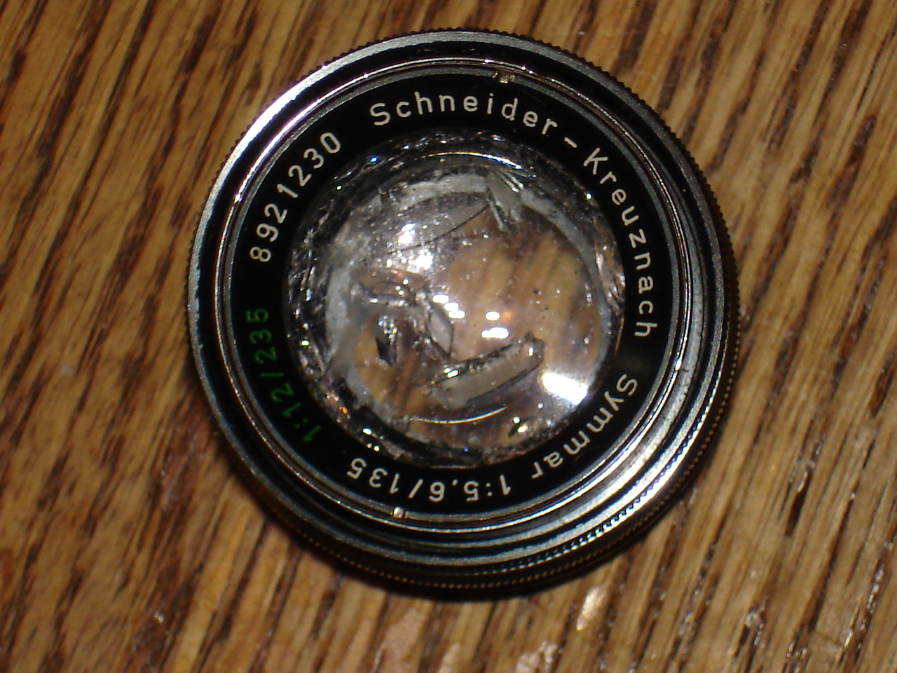

And here is what happens, when you are cleaning the cell groups in a 135mm Symmar, and one of them "squirts" out of your hand, and hits the concrete floor in my workshop. :blink: Won't do that again :whistling: Luckily these old Schneider lenses are fairly plentiful, and not too expensive. I have a replacement coming from Prague that should be here this afternoon.
At least I can reuse the retaining ring :laugh:

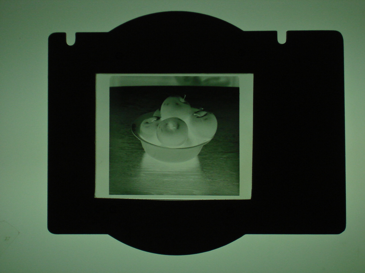

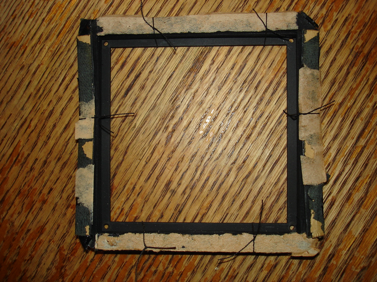

Here I have taken an old Omega D 3.25"x4.25" Negative carrier (homemade but very nice metalworking!) and "opened it up" to hold a full-frame Plaubel Makiflex Negative, with a bit of border all around. This would be on 9x12cm film in single sheet film holders. Actual image size full gate is 90mmx82mm from the Makiflexes.
This will be perfect for making "full frame" silver prints from my Makiflex negs.

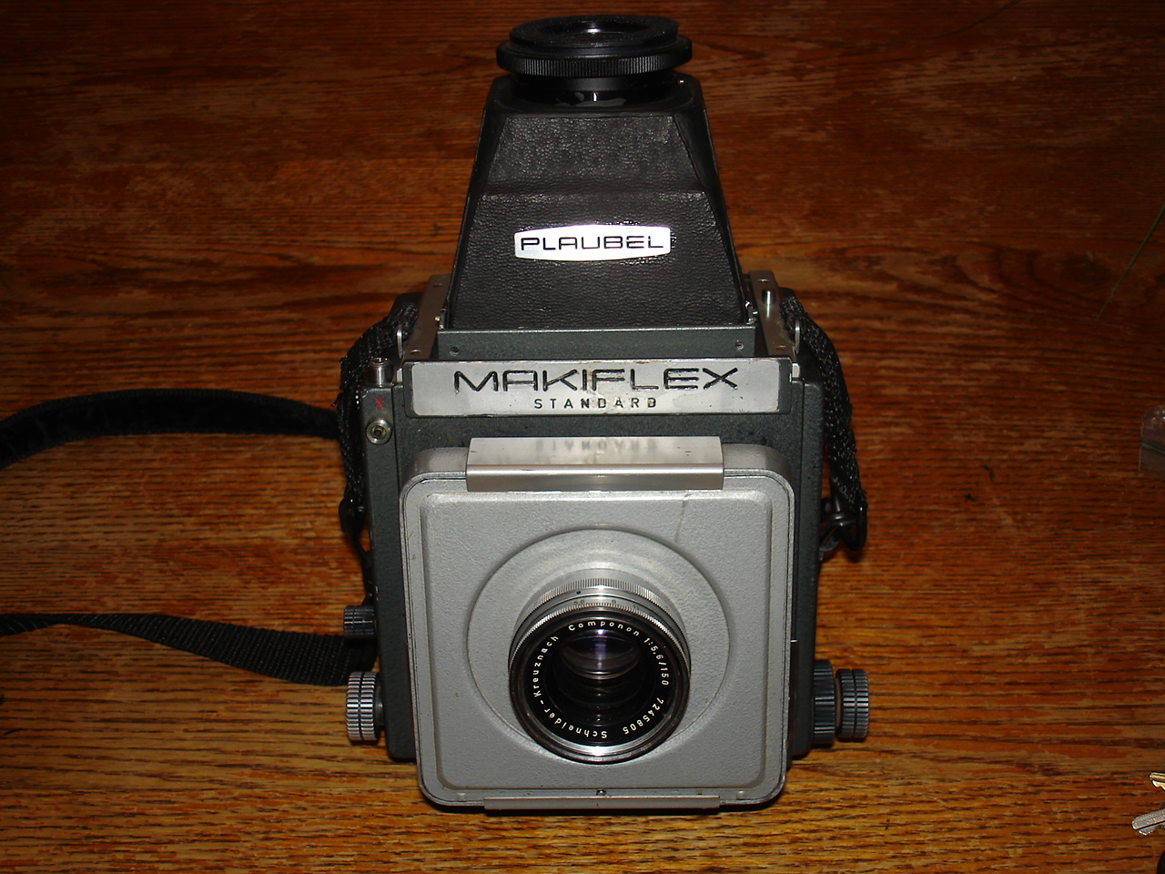

Hey Nokton
Can you maybe tell me which are the Standard's shutter speeds?

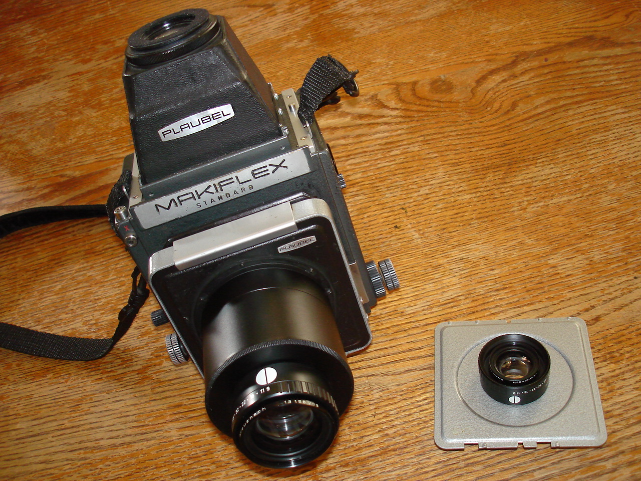

On the right, is the "Makiflex Standard" with 150mm F2.8 Schneider Xenotar. This model has a more restricted range of shutter speeds, and no auto-iris provision.
Hey Nokton
Milos,
The Makiflex Standard has shutter speeds of "B", 1/8", 1/10" (strobe X sync), 1/15", 1/30", 1/60" and 1/125".

Milos,
Thanks for your comments. I am shooting more with these, and will be posting more soon. Right now I am using 6x9cm B&W roll films of various types; Fuji Acros, Fuji Neopan, FOMA Creative 200, and some old Agfa APX100. Will be interesting to see the differences in these film types.
As to the speed of shutter issue, it sounds like the model you want is the one simply marked "Makiflex". This is the more "deluxe" model, takes auto-iris Plaubel Makiflex lenses. You cock the shutter, and the lens stops down right before shutter firing. Very fast to use! Or you can use most manual barrel lenses from 125mm on up.
The "Makiflex" also has a wider speed range; "B", 1/15" (X-sync), 1/30", 1/60", 1/125", 1/250", and 1/500". It also has a separate "slow speed" dial so it also has 1/8", 1/4", 1/2", 1", 2", and 4". Much more versatile!

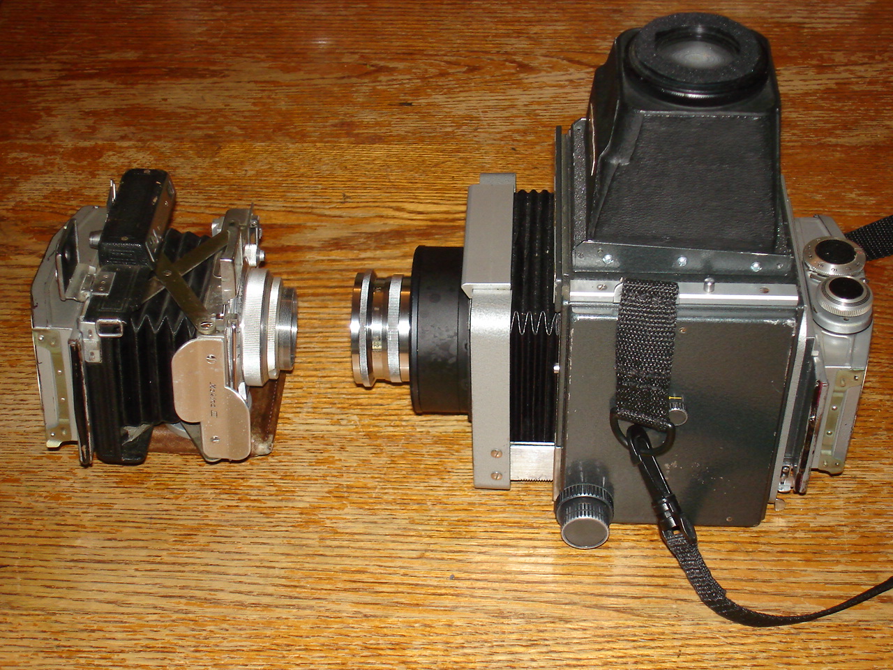

100mm F2.9 Makina III meets one of the Makiflexes (with 180mm Schneider Componon & homemade Mamiya RB67 Mag Hood). :D

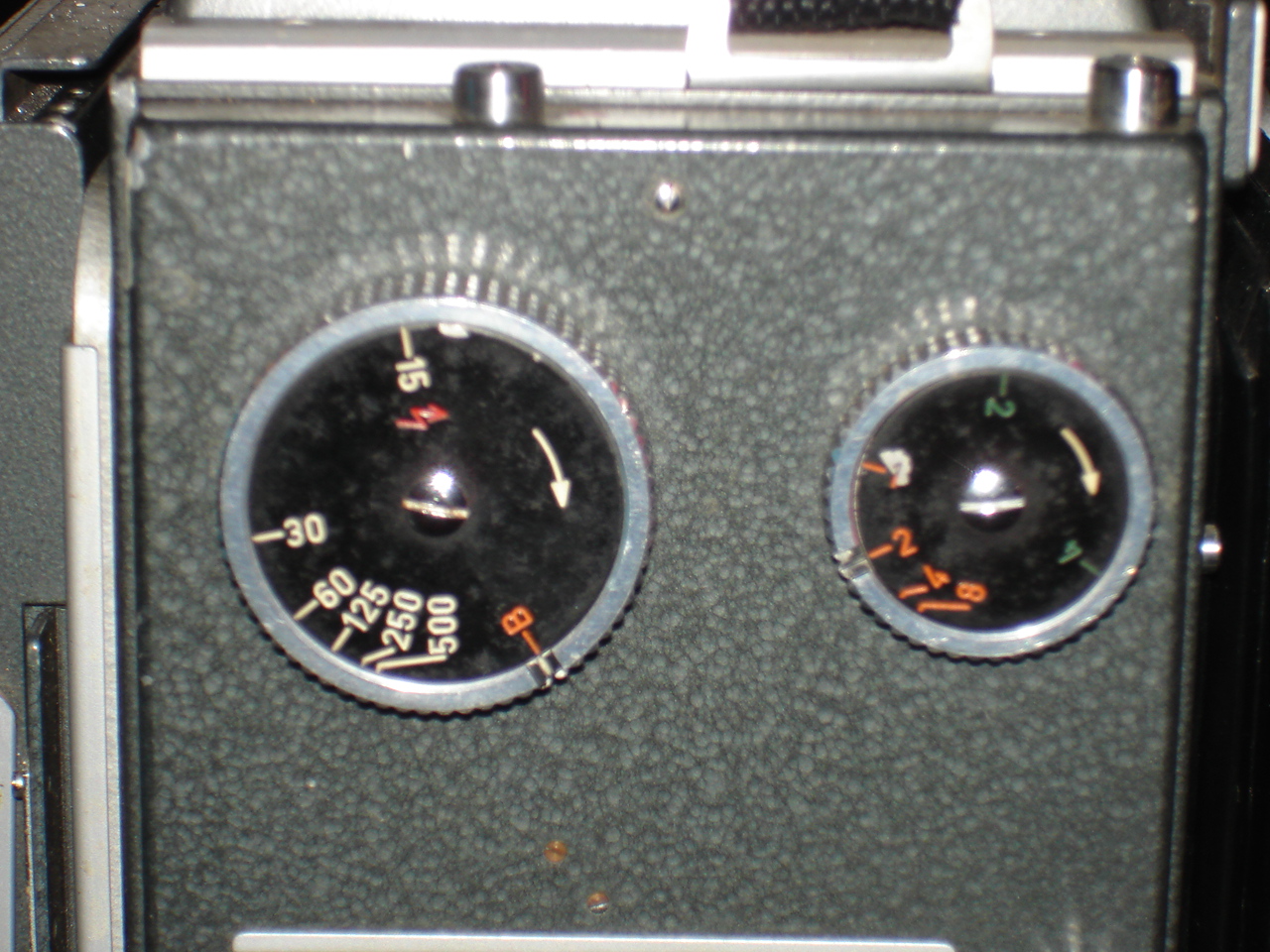

Can you please tell me how do you swap from one shutter speed selector to the other? I mean - how does camera know which one of the two is to adjust to?

On the Makiflex (not the Standard) The big wind knob sets the speeds. To use the slow speeds, you set the big knob to "B". Then you wind the second (smaller) speed knob and the shutter stays open however long you set it. You have to hold the camera open with a cable release (or hold the release lever down) while it is firing or the shutter will close early. In the picture the shutter is set to 2 seconds.
The 150mm F2.8 Xenotar will not fit on my regular Makiflex, I had to put it on a recessed board that only fits the Standard. On the Makiflex you would need to put it on a flat board, but it won't focus to infinity. But very nice for closer-in shooting :tongue:
