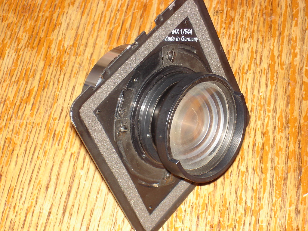

See picture of my 150mm F2.8 Xenotar below. It is mounted on a Plaubel Peco Jr recessed lens board,
that I had around. It fits the Makiflex Standard, but not the Makiflex (because the recessed cone is too
big to fit into the front of the Makiflex. The interior recess is smaller on the Makiflex, because of the automatic
cables inside the body. If I got a smaller lens cone to recess the lens (like a Durst IXOTUB) it would fit both
cameras. This will involve an intensive amount of metal cutting.
Second problem: When focused at infinity, the Xenotar rear cell strikes the mirror inside the camera body, when you go to fire the shutter. Solution: Remove a lot of heavy brass material from the rear of the Xenotar cell :pouty::pouty::pouty: (see the picture, I have done it!) and you can fire the mirror with the Xenotar on both of the Makiflexes. Actually Plaubel had an Automatic version of this lens and that is exactly what they did at the factory! A nearby camera dealer has this very lens, and lent it to me for a weekend, to take pictures and make measurements :tongue:
Whew!! :blink: A lot of engineering and very heavy metalcutting. But it can be made to fit both cameras.
I just have not gotten around to building the final recessed board that will fit both cameras. Stay tuned :wink:

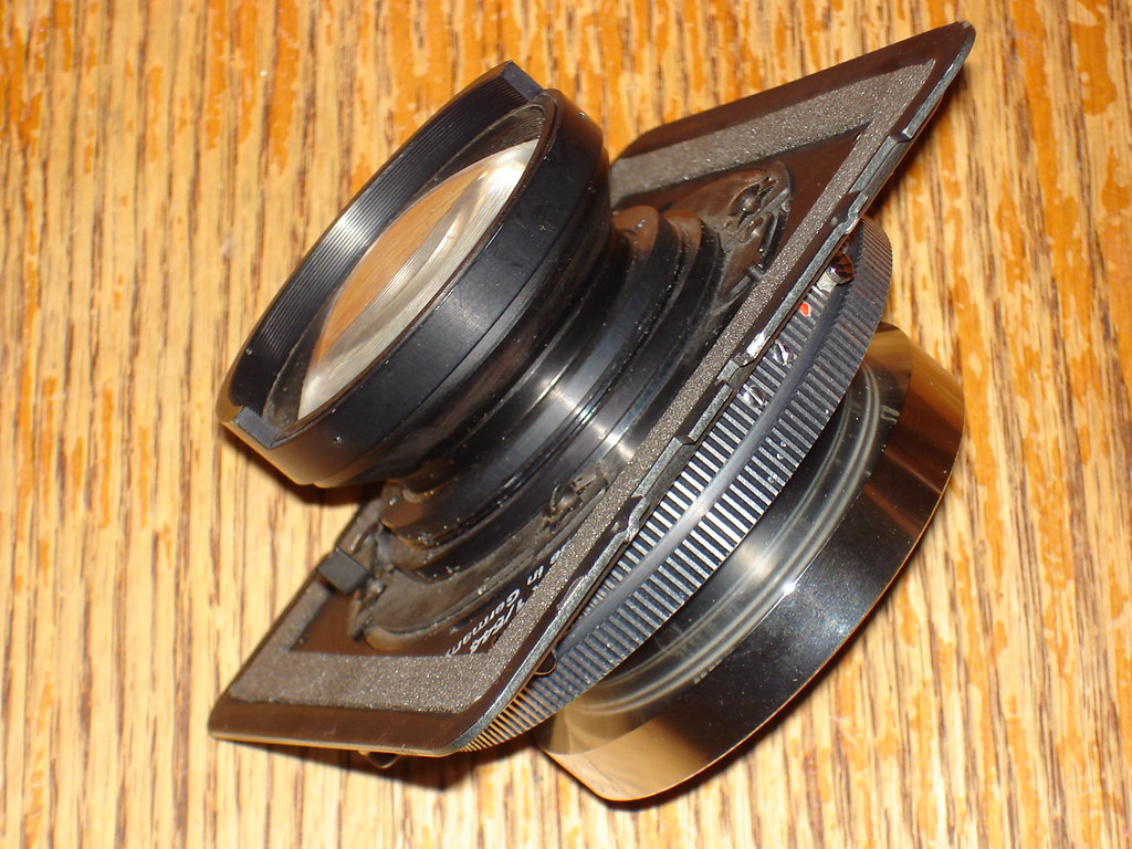

Here is the Plaubel Makiflex 150mm F2.8 Auto-iris lens (on my Makiflex) A super rare lens
This Xenotar will work on both Plaubel Makiflex models and focuses from infinity to super close-up.
002 by Nokton48, on Flickr
Here you can see how it was set up at the Plaubel factory. Very ingenious........ Note how the rear cell has been remanufactured at the factory, to clear the mirror when focused at infinity.

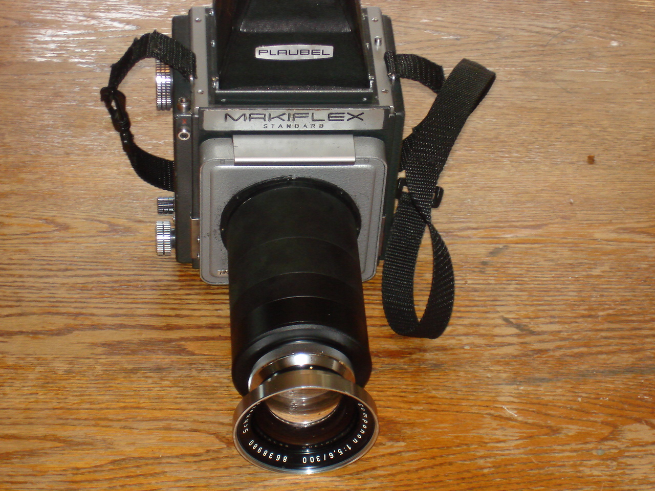

This 300mm F5.6 Schneider Componon is big and heavy and came along at a good price.
Have all the other Componons (except the 360mm, too big for these cameras!) so I thought
I better grab it. This one is heavier than, but not bigger than, my 360mm Tele-Arton. It's a beast.
The rear cell is massive and barely filts inside the (for Wista) tubes I am using, from China.
I now need to buy some more ($15 each) as I choose to dedicate tubes for each lens.

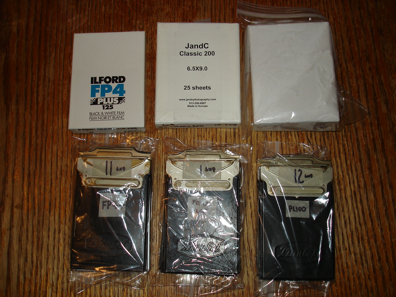

Here are nine Plaubel Makina 6x9cm cut film holders, loaded with fresh film, ready to go.
Three are Ilford FP4+, three are Foma 200, and three are Efke PL100.
Three of my favorite emulsions.
Just enough, when I shoot it off, to completely fill my new Jobo Multitank 5.
It will do 18 6x9cm sheets in a go. And of course, I can also use these in my new Makina III.

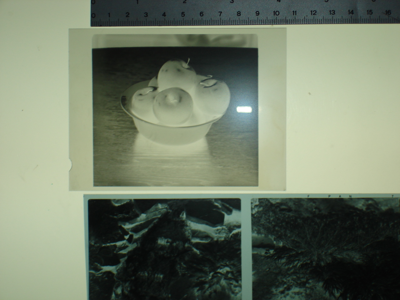

Here's an old test image, made on Ilford Delta 3200 roll film, rated at EI 800. Developed this weekend, eight rolls in the Jobo Multitank 6 on Unicolor Uniroller is perfect for my uses. Microdol-X straight 24 minutes at 18C, 360mm F5.5 Tele-Arton lens wide open. High speed roll film shows a lot of promise for me. This stuff was not available when this camera was in it's heydey.

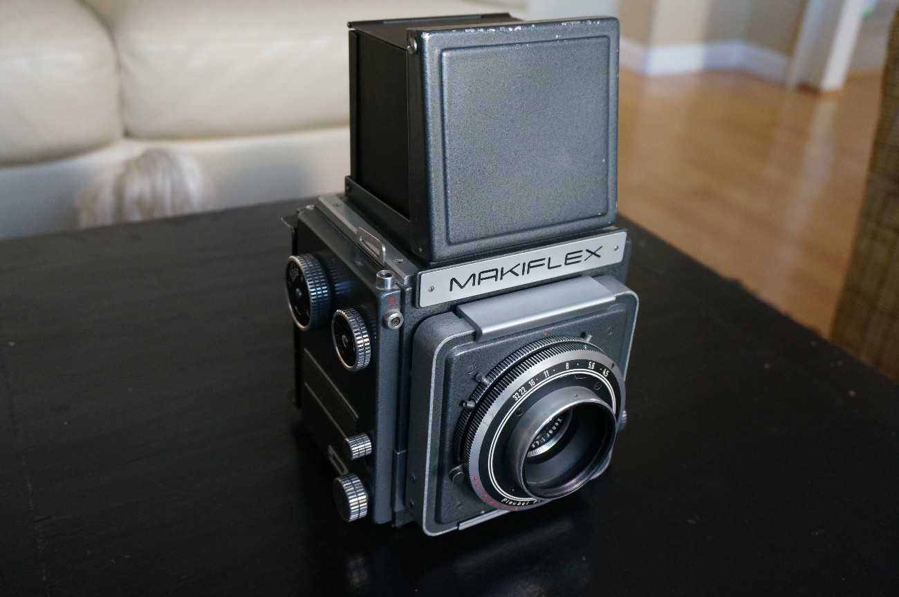

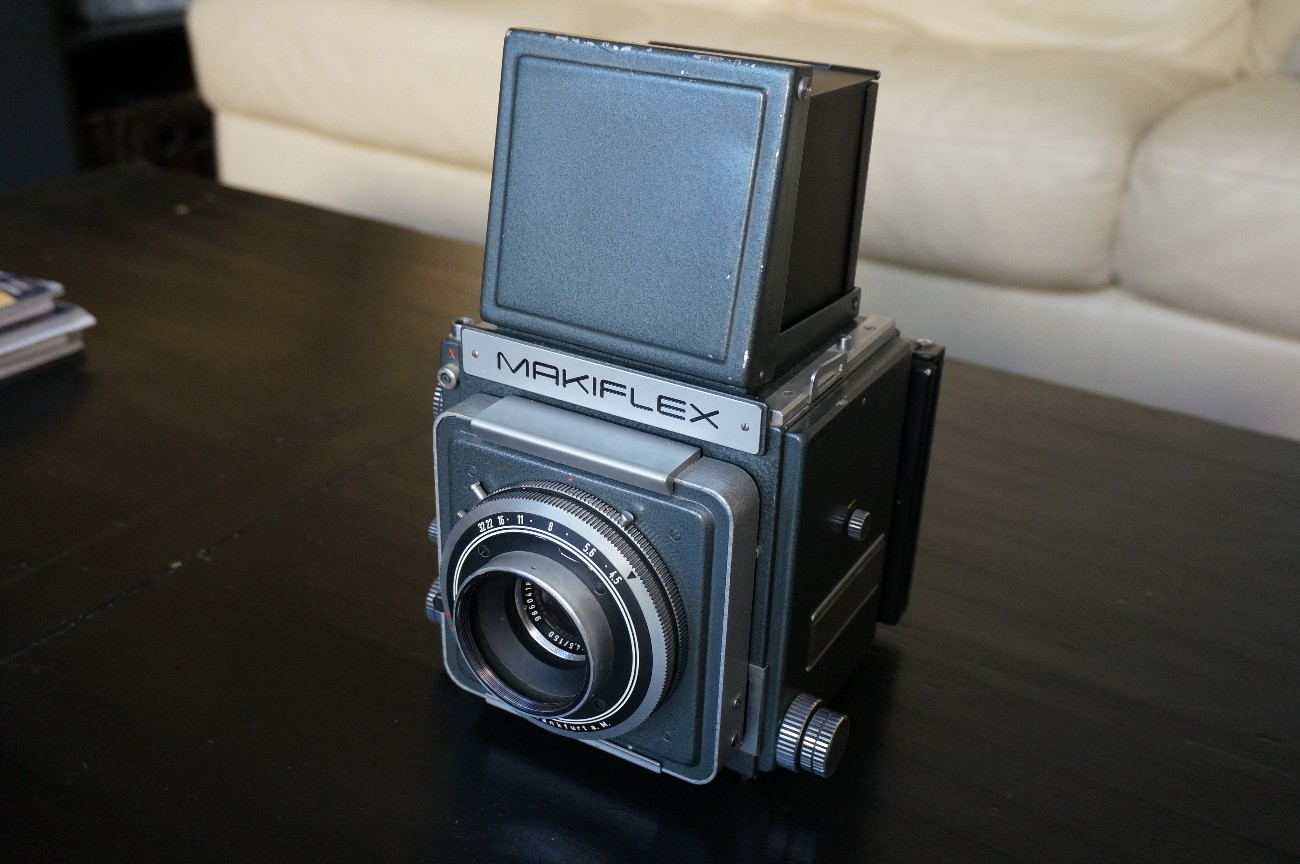

I apologies in advance for my ignorance.. I'm just getting started with my Makiflex.. I acquired it from my uncle and it came with a sheet film back. I would love to use 120 film see several posters with a roll film back. So I have a few questions. What backs are compatible and where can I purchase one. Also, I have no clue as to how I can mount one of those backs onto my Makiflex, is there an adapter that I need?
Wow another Makiflex owner! :smile:

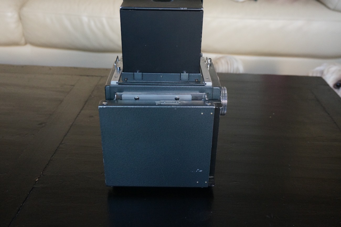

The best thing for you to do, is to take some pictures of the back of the camera, with the sheet film back on, but also with the film back off. Post them here. I'll tell you exactly what you have, and what you will need to get going with roll film. Plaubel made 4+ different backs, some of which will take roll holders. Post some pictures and I'll be glad to help.
Probably the Makiflex back I see most often (maybe this is what you have) is the MX1/521, or the MX1/525 (which comes with a spring-loaded groundglass screen), which is a great and very useful accessory. This back takes Plaubel Makina roll film holders, which were made in 6x6cm and 6x9cm formats. You could also use Plaubel Makina single sided 6x9cm sheet film holders.

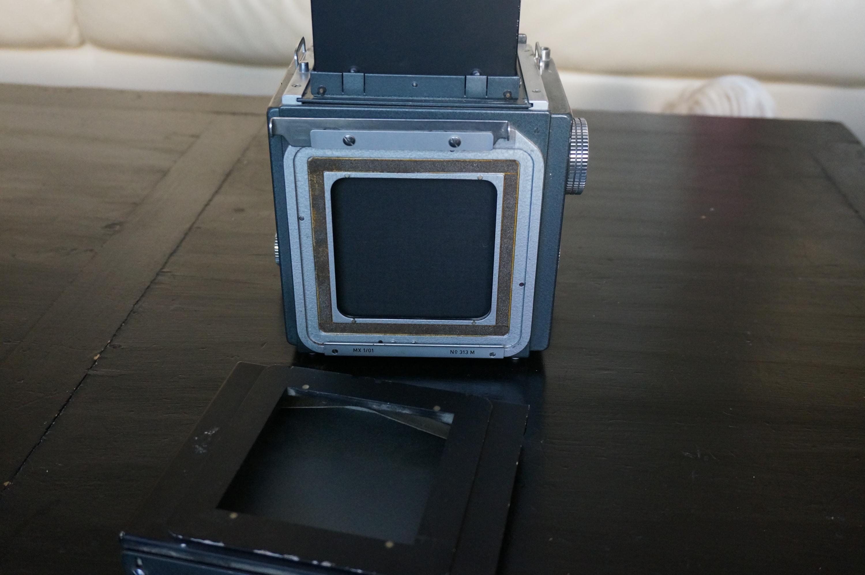

Thank you!! Here are the pictures you requested. The camera seems to be in good working order.. all the shutter speeds seem accurate and the actuation counter is at 1687.. The only issue I see is that the bellows has a small tear(1cm) on the bottom at a crease. I'll need advice on how to repair that as well. Thanks for all your help, after reading through all these posts, I feel I've made contact with someone very knowledgeable about this camera.

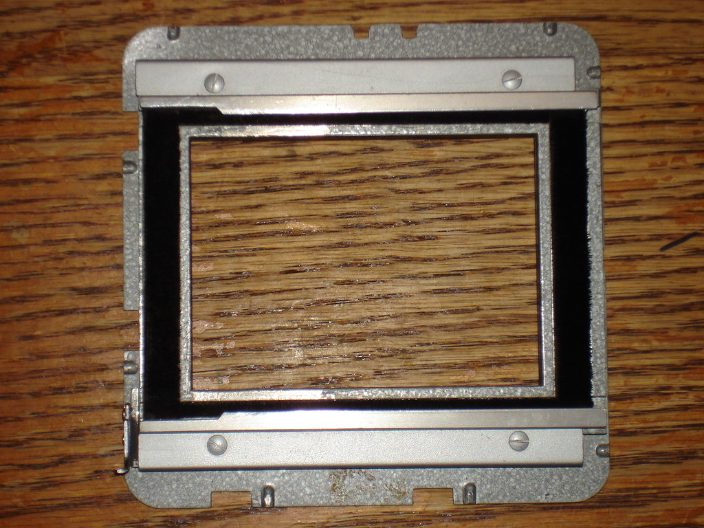

Hello again!
What you have, is the MX1/538, 3 1/4 x 3 1/4 Back for double dark slides. This back puts an 82mmx90mm image onto a sheet of 4x5" sheet film. Fidelity, Linhof, Graphic/Graflex, or Polaroid 4x5" sheet film holders fit this back. Very easy to find these holders, they are everywhere and not expensive. Very rare and cool to have this for this camera. 1687 actuations is nothing.......... One of my cameras has 21,000 actuations.......... Yours looks in great shape. The bellows is leather and can be patched. A cut-down strip of good quality black electrical tape makes a good temporary patch.
You have a Plaubel Makiflex (not the Makiflex Standard) this is the deluxe model. It has a 150mm 4.5 Plaubel Auto-iris lens. You cock the lens and it stops down right before exposure. They referred to this as "Automatic" operation back in the 1960's.
Is the lens a Xenar? I have that one, it's a really great optic. If you are REALLY REALLY lucky you have the Apo Lanthar.

After studying your pictures of the Makina film back pictures more carefully, it seems that the MX1/521 attachment would fit on the back of my camera. Then all I would need would be the Plaubel Rada back listed. Am I correct in my assumption? Thanks for being so patient with me.
Absolutely correct! BTW having an automatic Xenar is not unlucky. It's a rare lens with Plaubel Automation. I love mine.
In fact I would be interested in trading this Plaubel back, for your 4x5 back, if you are interested...... Send me a PM maybe be can both benefit
This will fit your camera. Plaubel called it the "double rail" system and it takes Makina and Peco Jr accessories

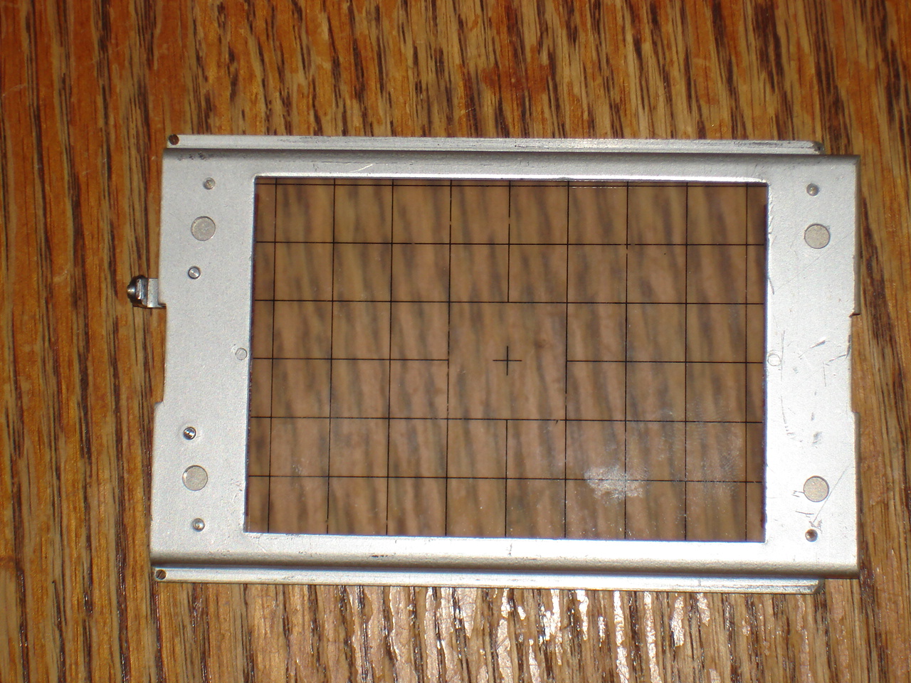

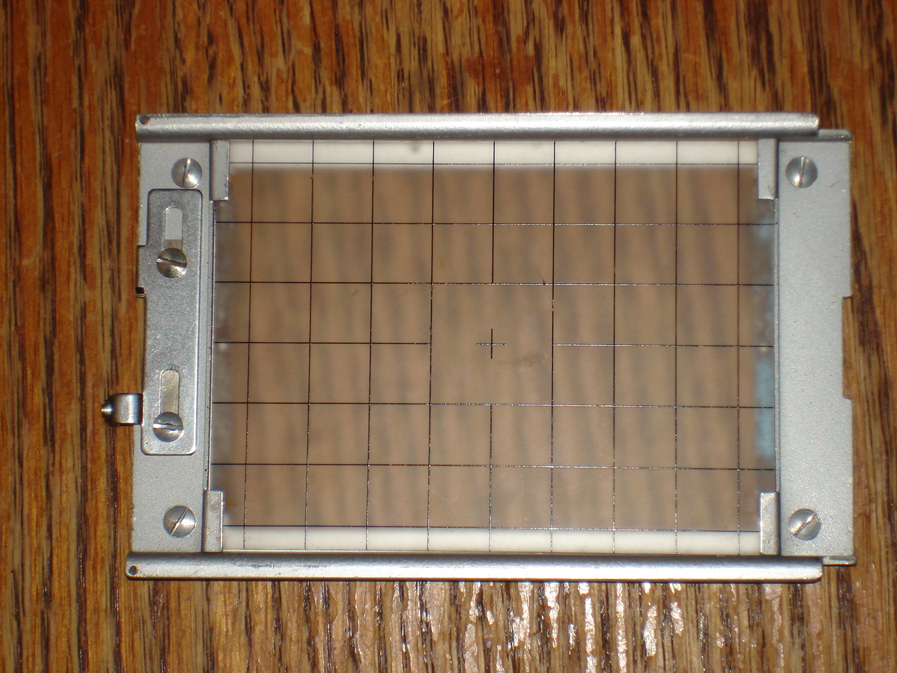

Per an offline request here is the Plaubel Groundglass back, which fits the double rail Adapter Back.
So you can view the image at the film plane, just like a view camera.
