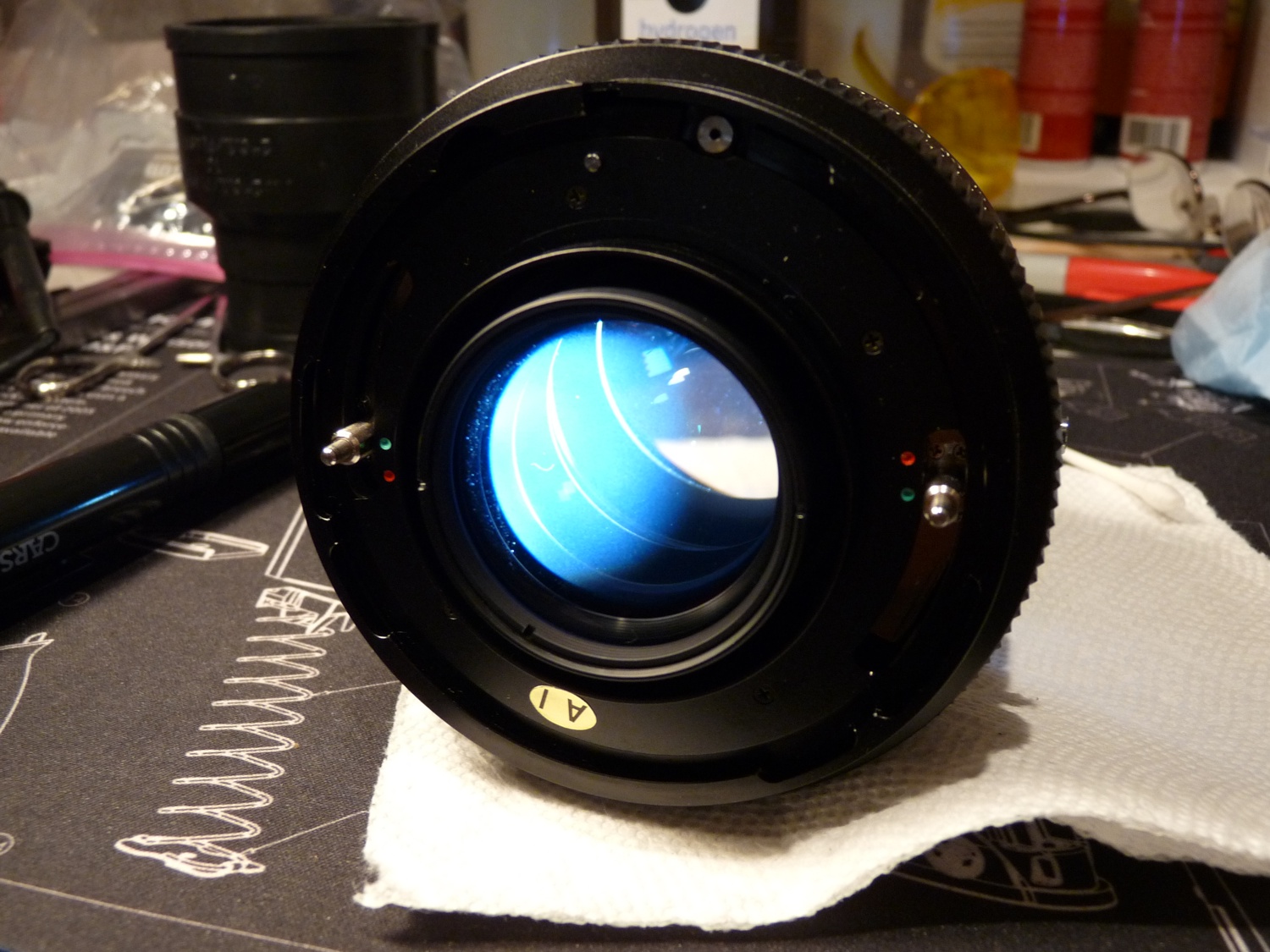

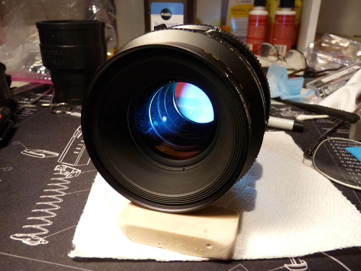

Well, I ordered a used "near mint" ("No fog, fungus, mold, etc.") 127mm K/L lens from ebay and it came today, but has haze on the rear lens group that lights up when I shine a light through the lens. See attached pics. Very disappointing. Maybe RB-67 lenses just don't age well.
