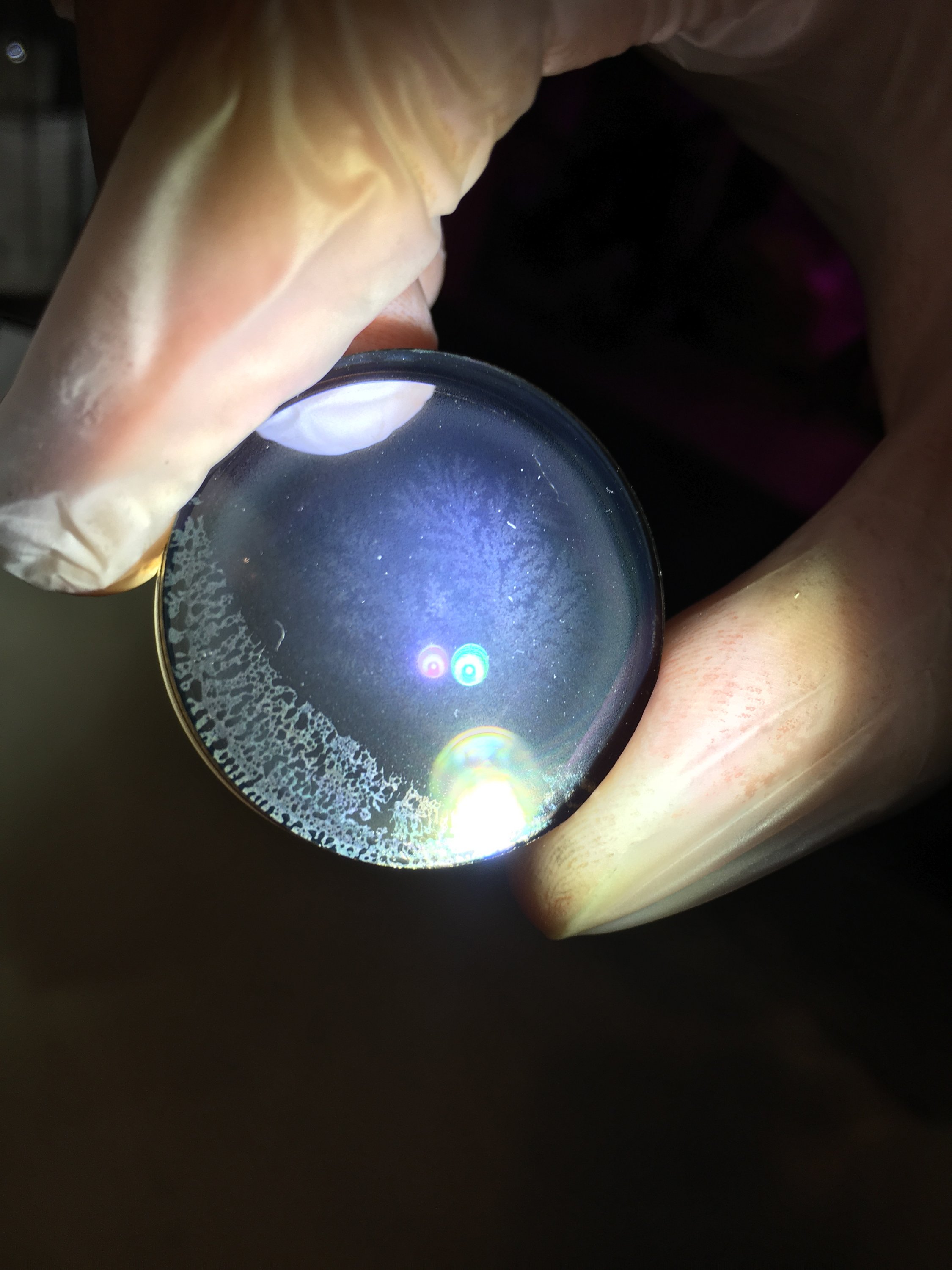

It was a great pleasure to find this thread as I’m facing the same problem. Recently got my Rb67 pro sd with 127mm k/l lens, was posted as tested and in good condition, visually and mechanically was true, however after few test rolls I’ve noticed highlights flaring and general softness of the lens uncharacteristic of mamiya glass.
Long story short after digging further and eventually ending up with a rare double in the oven, I have the same issue as the author.
the only difference after one cycle in the oven at 160 degrees Celsius, which is about 325f as suggested in earlier posts, the fungus like growth has appeared all through out the double and I mean a really tree looking growth, plus some separation on one side.
does anyone know should I run more cycles at this point? Also no fungus was noticeable before just the same old foggy/hazy cemented element.
also doing some research I’ve found that fungus would die at about 130f which is almost half of the temperature that I set, however somehow it resulted in it developing out of nowhere?
hope someone can help.
I don't think that's fungus. You might be decementing the lens elements by heating them - not sure if that was the goal of this exercise.
