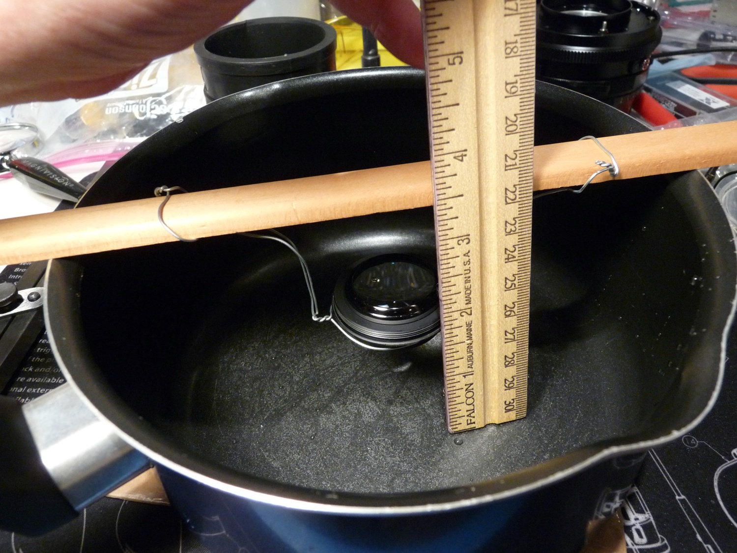

I know this is a really old thread, but I stumbled across the contraption I made to boil this lens and realized I never posted a follow-up. I rigged a way to suspend the lens pair in a pan of boiling water rather than letting it touch the pan. I boiled it three times for at least 15 minutes (each) over a period of several days, but never detected any change. I finally got frustrated and gave up.

Yes, I left the heat turned on and the water boiling the whole time (about 15-25 minutes) and then turned the heat off and left the lens in the water as it cooled down. I did it a couple months ago when this discussion was active. I just forgot about it because of some family health issues. I checked it just now and it is still quite cloudy, but I will keep an eye on it.

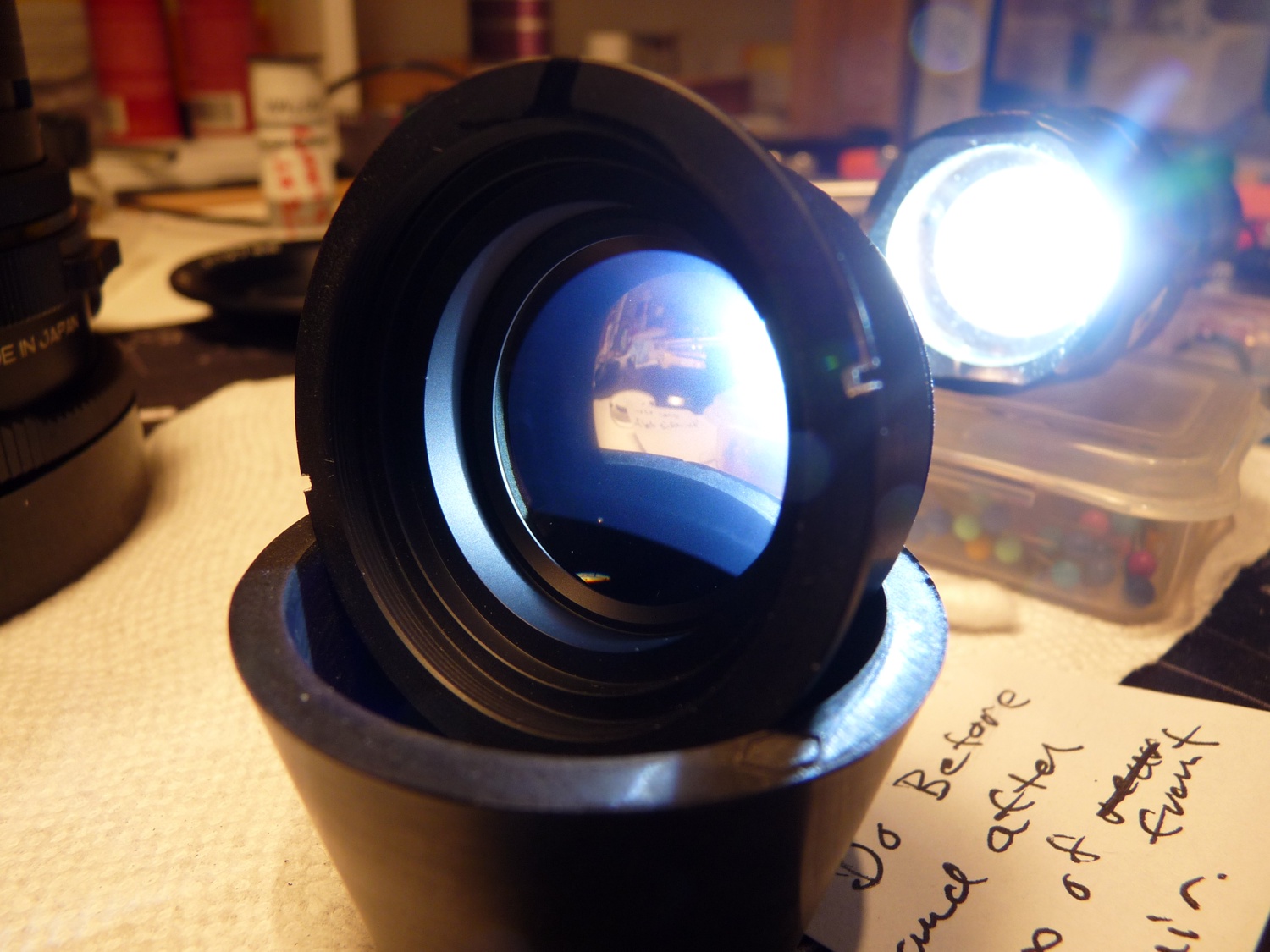

SUCCESS!!!
The oven treatment did it.

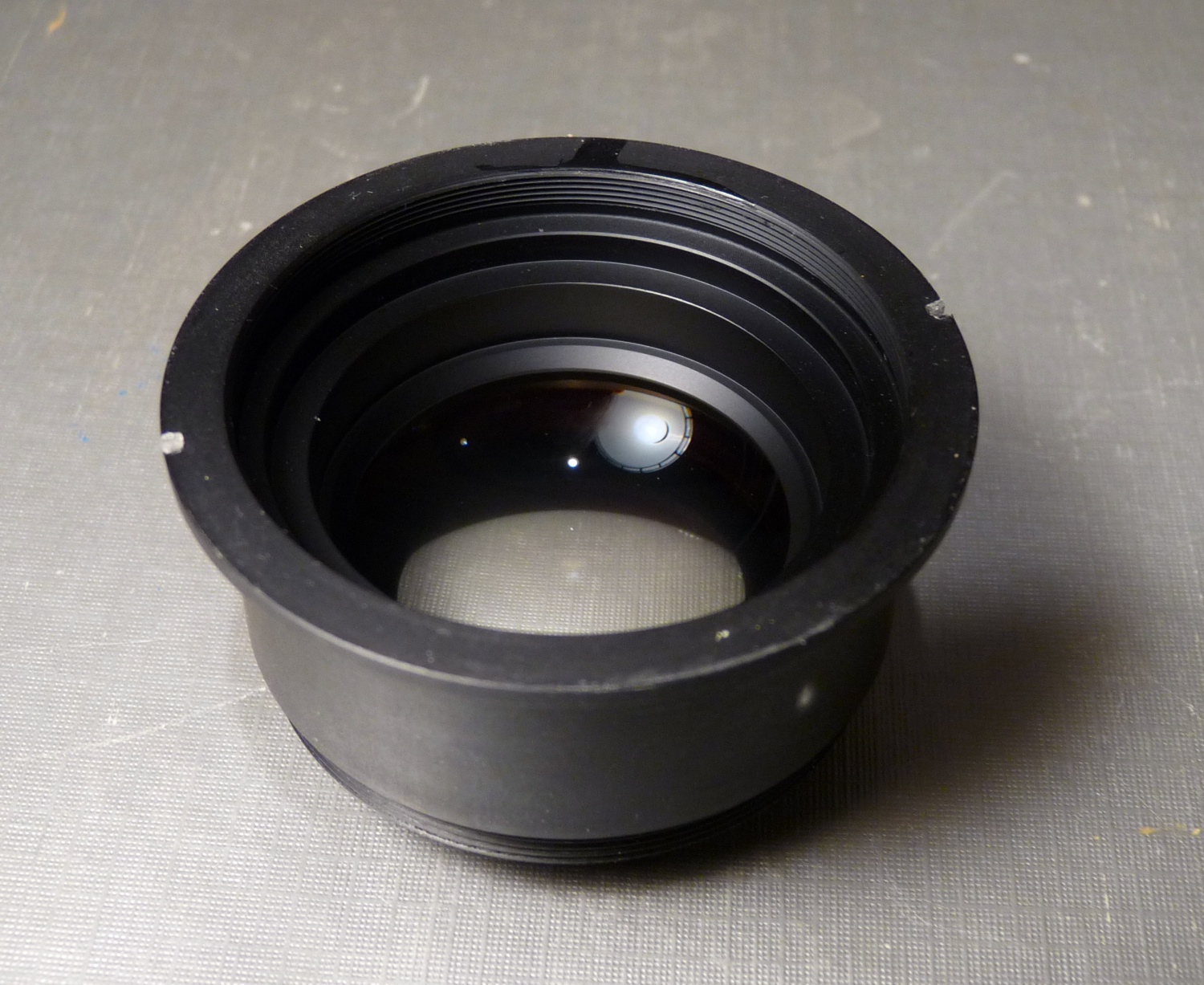

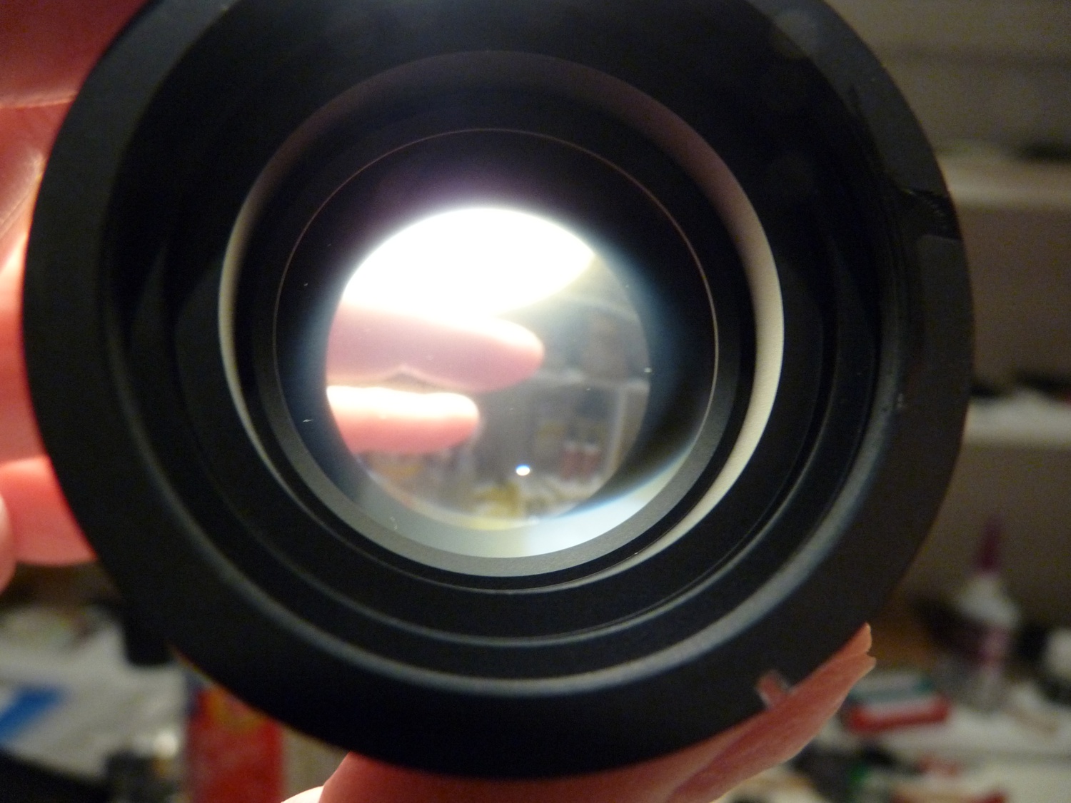

It didn't just get better. The haze is GONE! The haze had a texture and it was slightly worse around the edges than in the center and it lit up brightly when shining a flashlight through it. All that is gone from the center all the way to the outer edges. See picture below. I gave it three cycles at 325F for 30 minutes, followed by a cooldown of several hours after each heating. The haze was still there after the second cycle and I expected it to still be there after the third. The actual temp, as measured with a thermocouple at the lens position, varied. The hottest was 377F immediately after preheat, just before I put the lens in the oven, but after that it varied between 309F and 352F. I left the glued lenses in the metal metal mounting piece (basically a threaded collar). In other words, there was no need to try and separate the glass from the metal ring they are mounted in. Also, there is no apparent damage to the coating.
I did this treatment on the rear lens pair. This 127mm lens has a cemented front pair which also has pronounced haze. I will be doing that one tomorrow. I will try to remember to do before and after pictures.
This should give hope to everyone with old Mamiya lenses with haze between cemented elements. Remember, I sent this lens to a repair shop and they told me they couldn't fix the haze. Removing these lens pairs is not hard and only requires a few fairly inexpensive tools. There are several videos on Youtube by mikeno62 demonstrating the disassembly of RB-67 lenses.

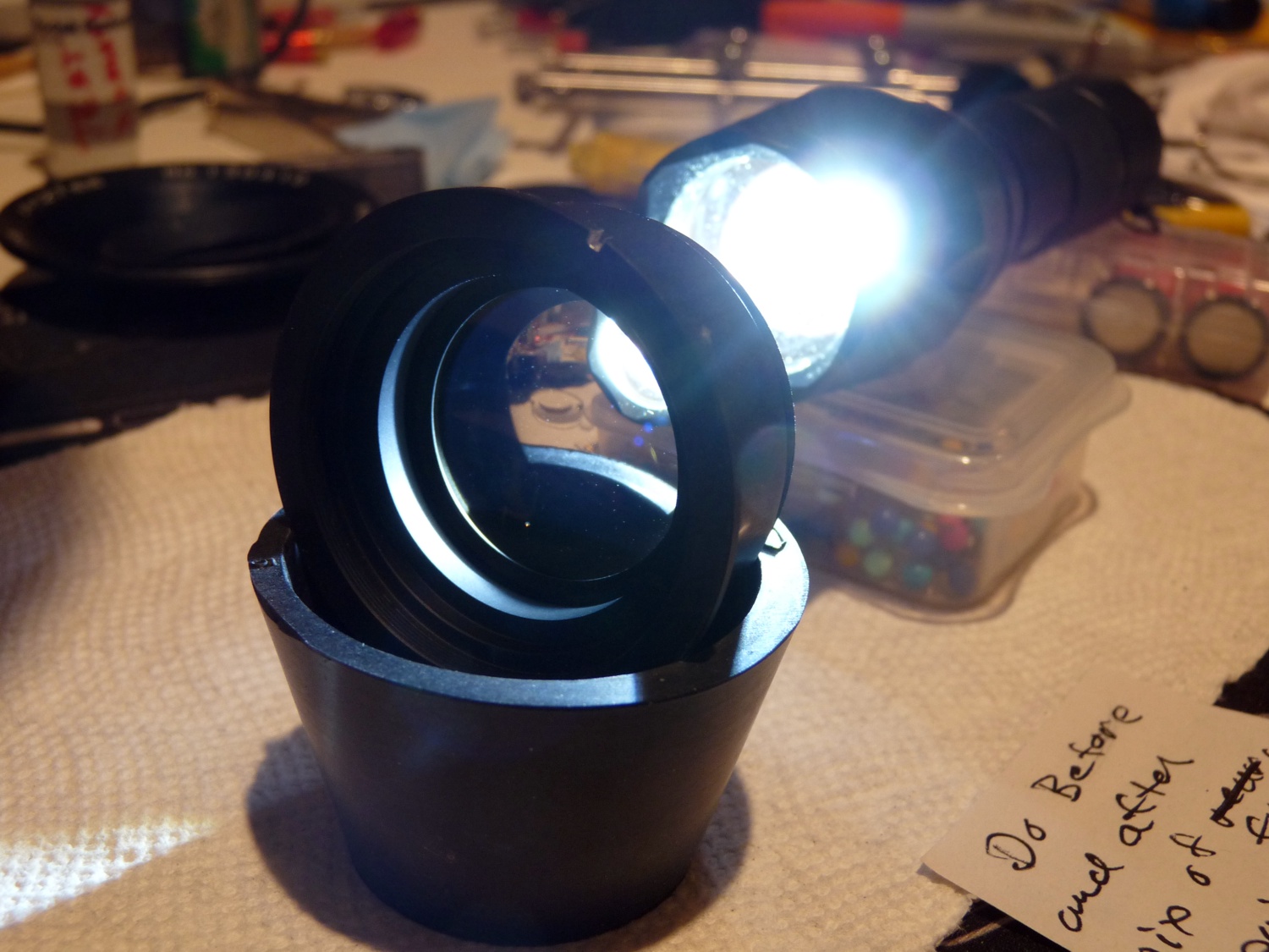

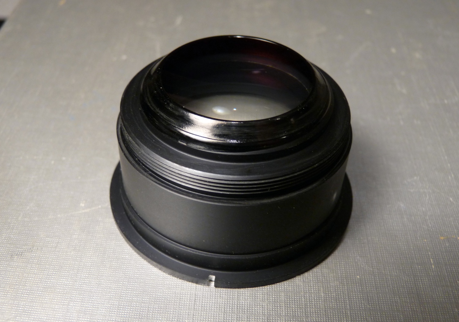

The pair of glued elements from the front group of the 127mm lens cleared after a single heat cycle. Not sure why it would be any different, although this lens pair was never boiled. Maybe the haze just wasn't quite as bad or the oven temp was a little hotter. I didn't pay as much attention to the oven temp because I just assumed it would be about the same as yesterday. I probably won't even bother with additional heat cycles for this one.

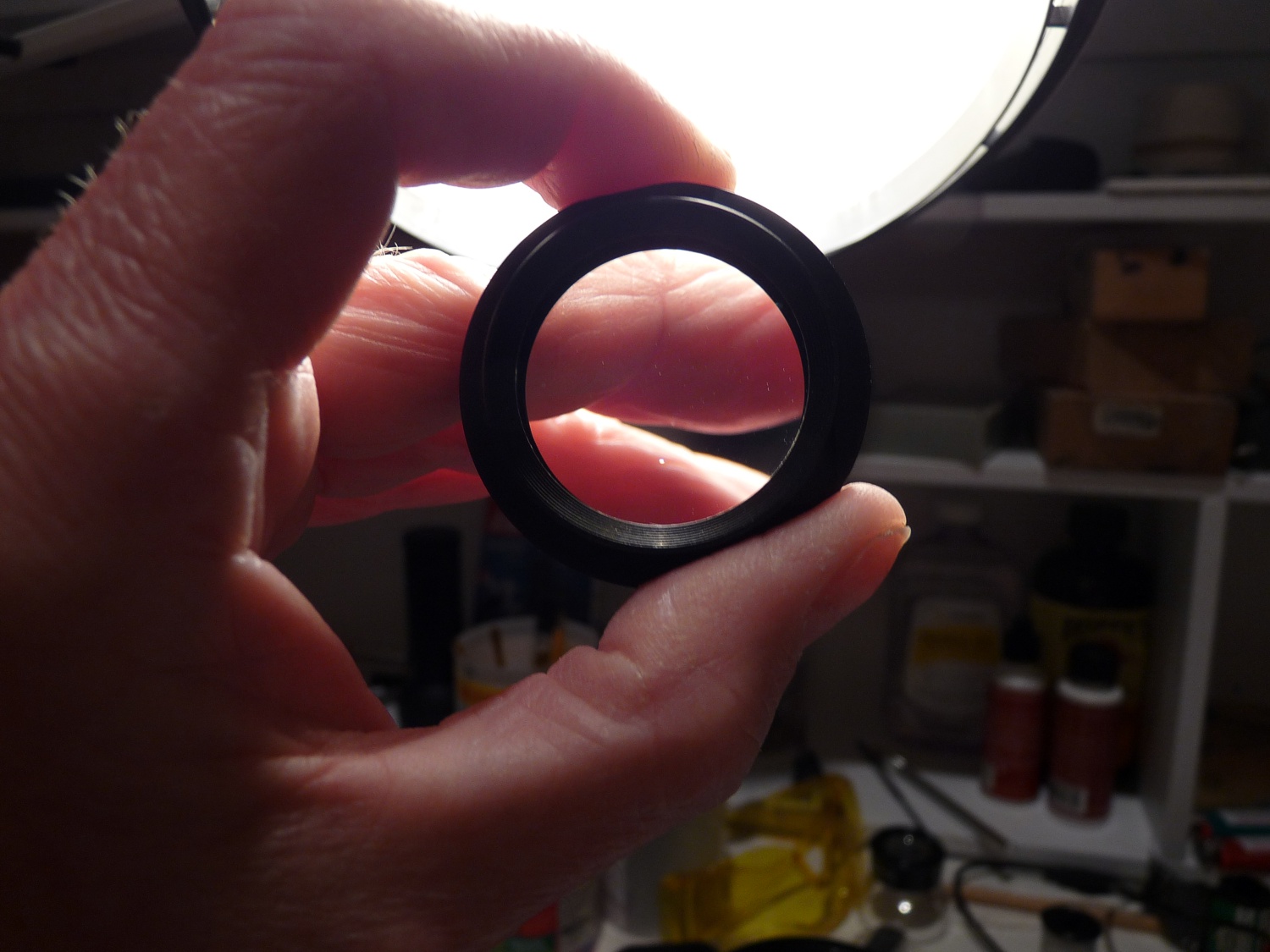

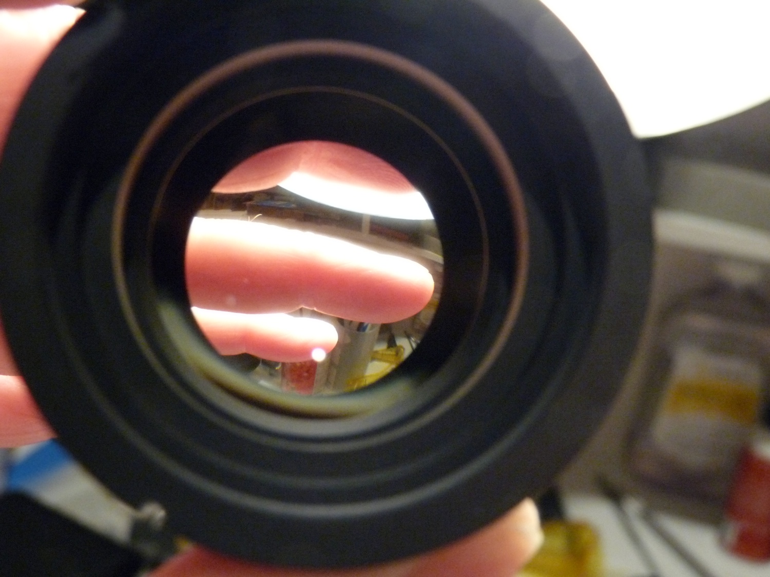

Attached pictures: The first two are just to show what this pair looks like. I did not attempt to separate the glass from the threaded metal collar, so the first picture is how it was oriented in the pan in the oven. Following that are two pairs of "before and after pictures". The lighting on the pictures is meant to highlight the fog. These pictures don't convey how clear the lenses look when you're just looking through them with the naked eye. This process really seems to turn back the clock a couple decades on these elements. It's what you should and would expect to see on a new lens.
