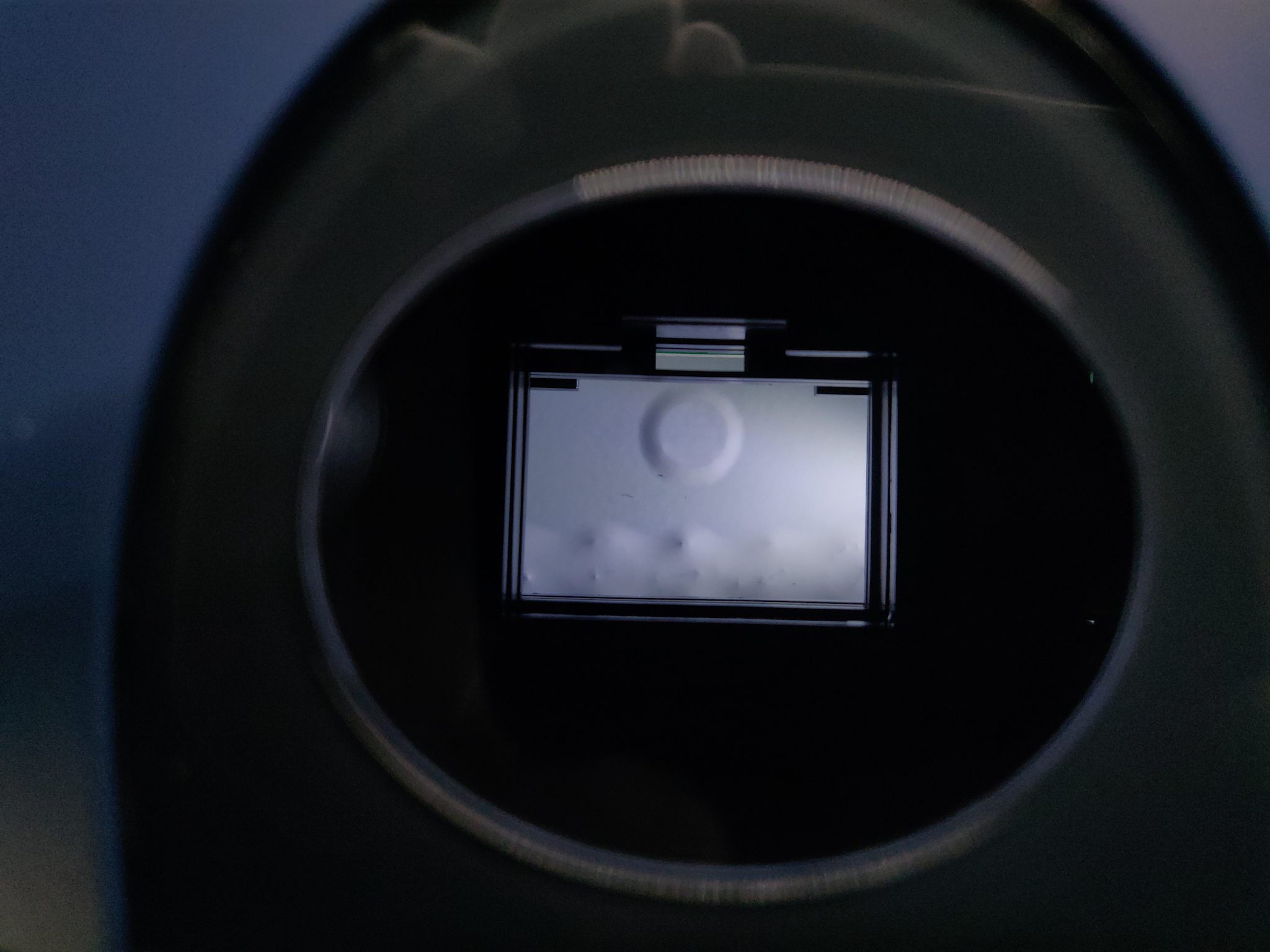

Also, are the lumps and bumps at the bottom of the viewing window normal?
So far I am not impressed with this scanner and am 90% sure it's getting boxed up and sent back. Be for I do so, I'm hoping others have used it and can point to something I might be doing wrong.

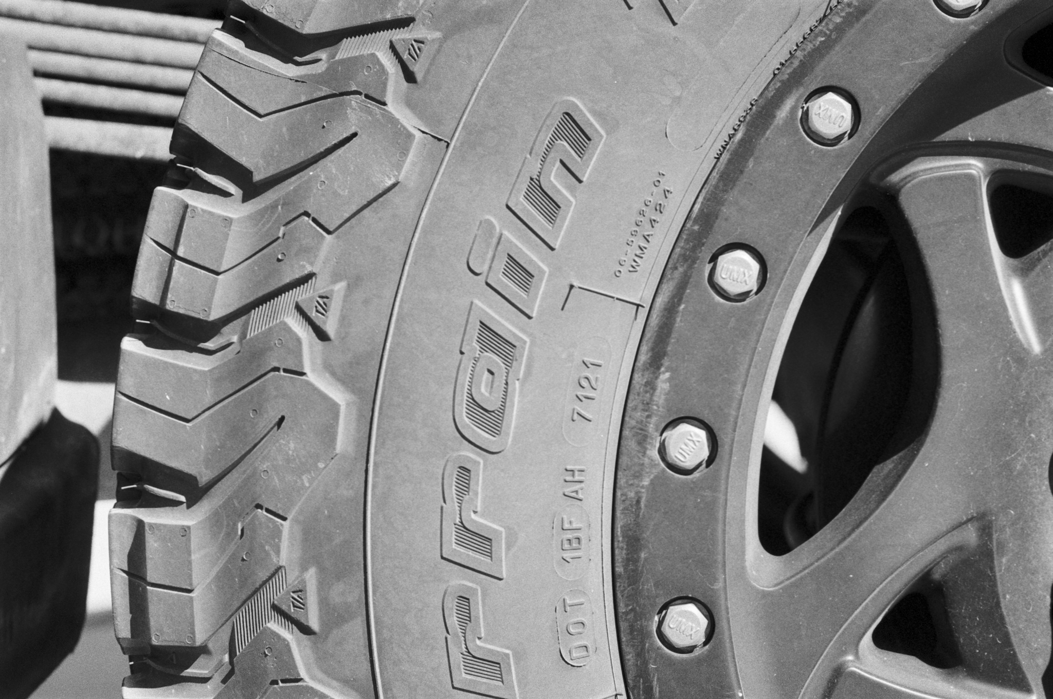

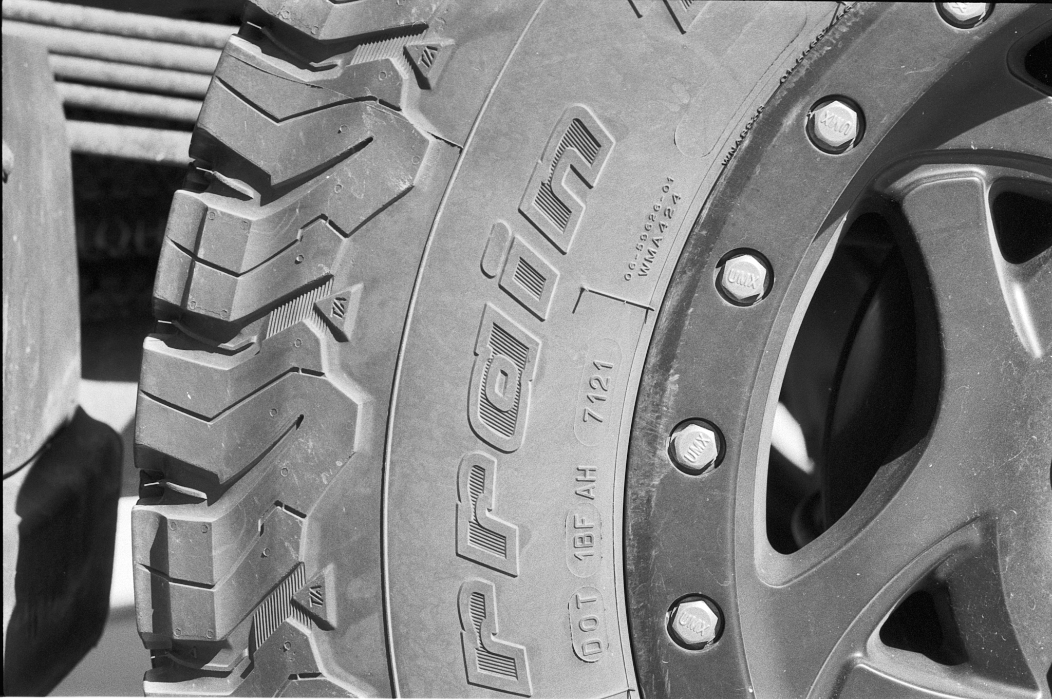

Si I did a scan an image using two different scanners.
Which does everyone think looks best. I tried to keep things as equal as I could, but that rarely works out.
The full resolution images show the same differences.
With those two images I can't say which looks best without more info, including a raw scan with no scanner software applied color. However I do find the color balance on the left image nicer, but it may not be true to the film. What type of film? What type of corrections did you allow the scanner software to make?
I wish I could post better images but with the file size limitations it's hard.
I like the left one too, it was scanned with my V700, the right is the XA plus.

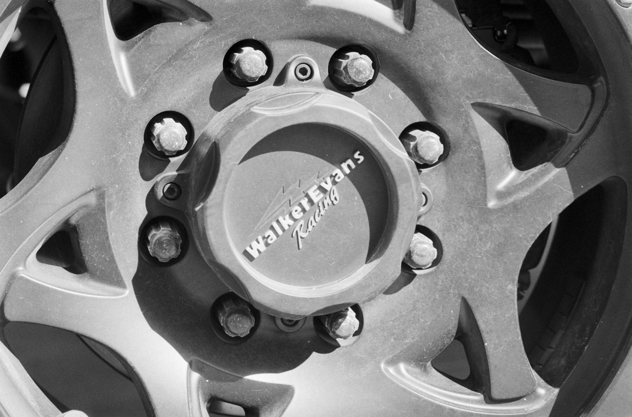

Now that I have the scanning bugs worked out I have been doing a lot of comparisons XA vs V700. I am now impressed with how good the V700 really is. I always considered it just OK for 35mm and really didn't do justice until MF and LG ( 4x5 is as big as I go ). The XA is good, but I was really expecting it to outshine the V700 with 35mm, it's just not the case. There were some images where the XA was maybe a bit better, but was really close.
The make it or break it deal for me is can the XA really scan a full uncut roll of 35mm and not screw up. If it come down to feeding strips into the XA or 3 strips at a time in the V700, the XA will likely go back.
Like other scanners, the XA certainly cannot make use of 10,000DPI that it claims. 5000DPI is only marginally better that 2500DPI. More than 5000, things actually get worse ( like a softer focus ). That might all depend on what the picture is of.
So for now, the XA is not as disappointing as it originally was, but it certainly does not have anything over the V700.

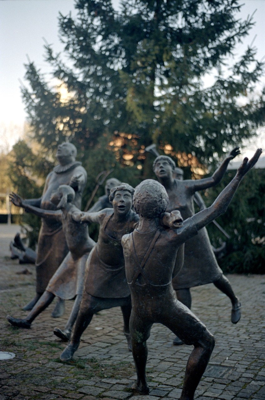

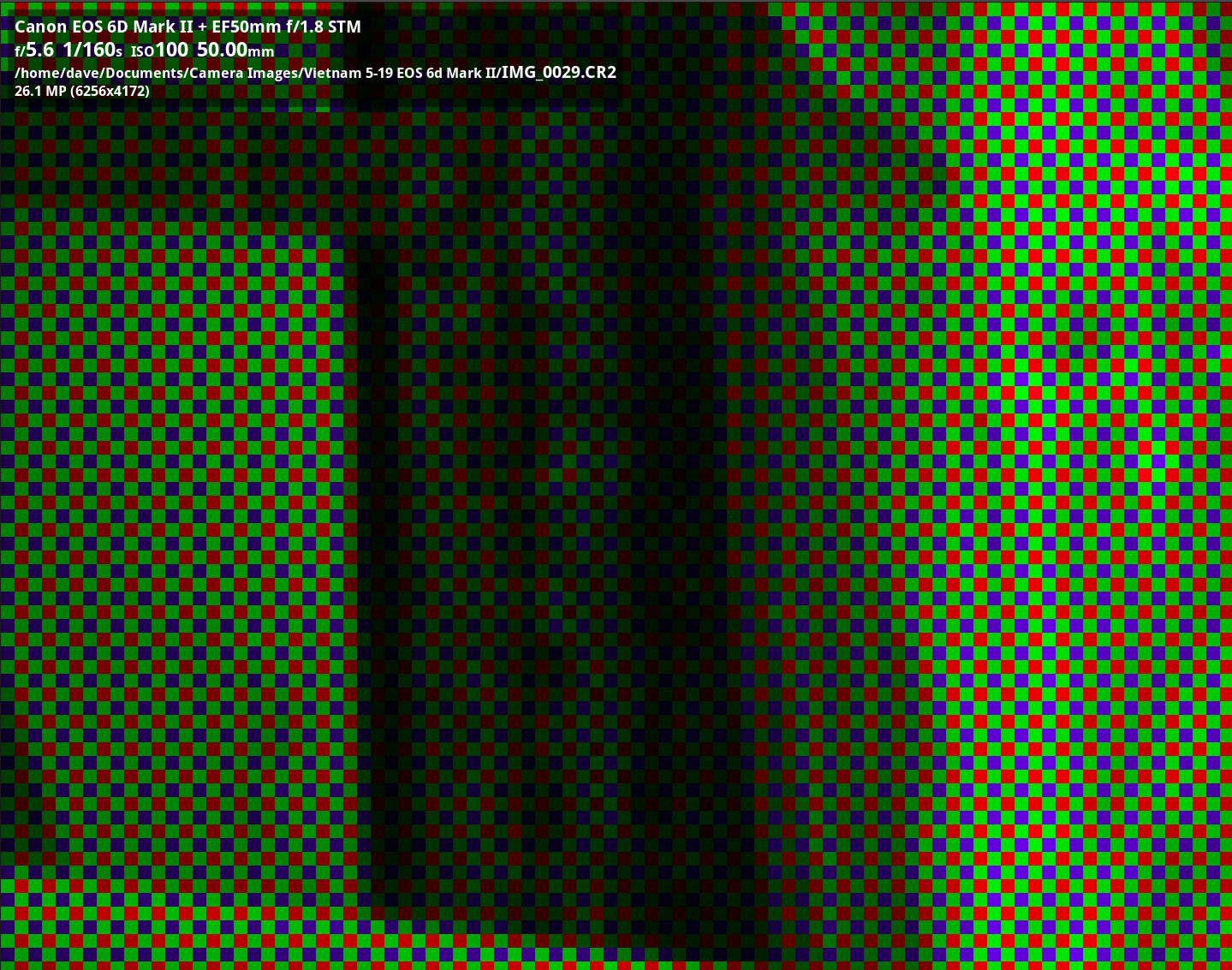

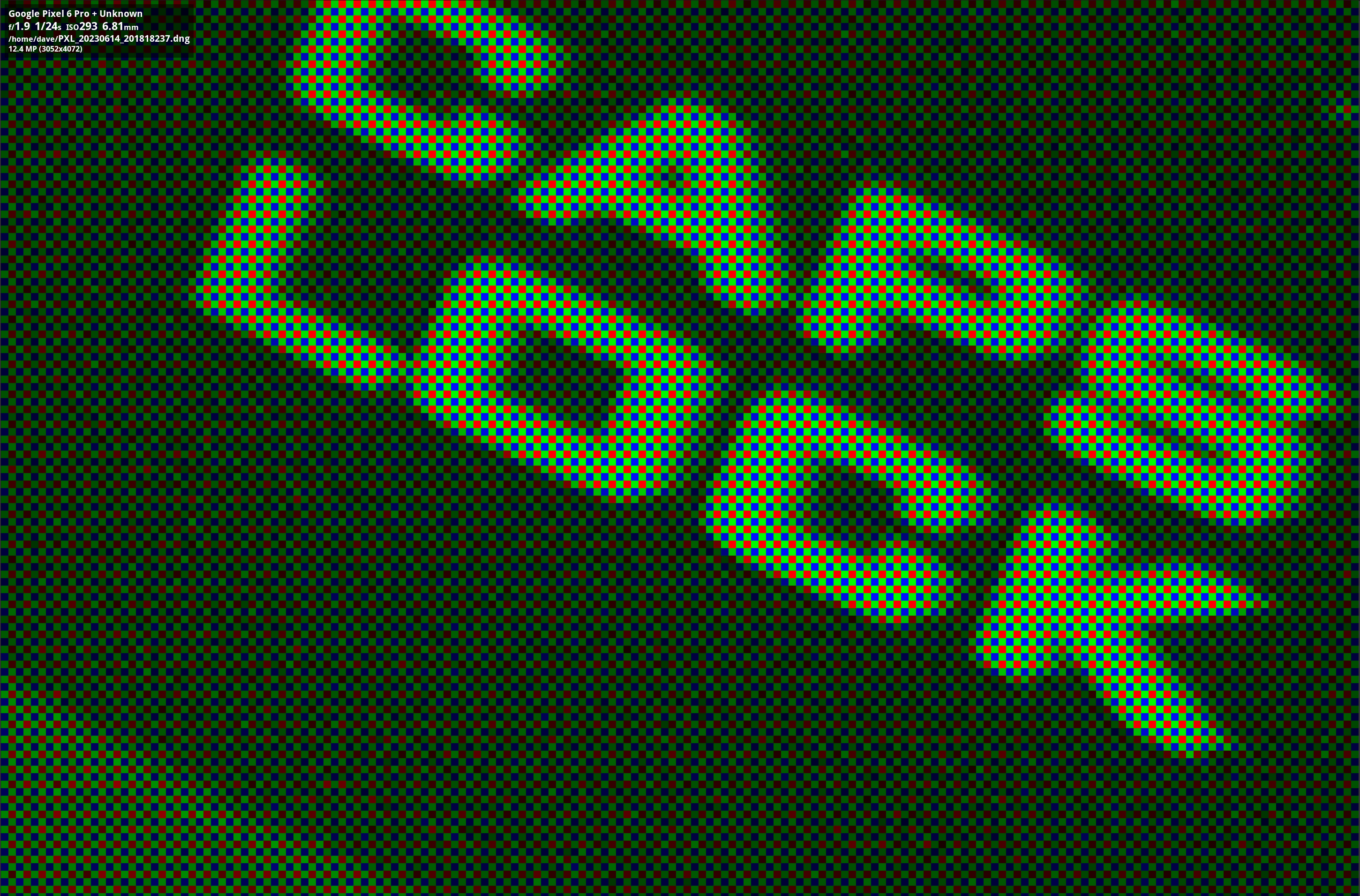

In one of the posts, someone spoke of getting the RAW image from the scanner. If possible it will look nothing like a raw image from a Digital Camera as I have attached below but Vuescan certainly has the option of raw or tiff added so it could be interesting. As I am sure everyone knows, part of the beauty of film is that every photosite has all three primaries in layers, and line scanners such as this are NOT Bayer, They have three scanner heads that are in rows of ONE color per head, one red, one blue, and one green so ALL colors are scanned from the film at every photosite so all the colors you see came from actual photons in a scan unless one did it with a DSLR with its Bayer sensor thus defeating the purpose of shooting in film in the first place, might as well just shoot digital at that point. The raw output of a line scanner will have all colors available at every pixel whereas a raw digital image from a digital camera will only have ONE color for each pixel and the color blend you see in digital images is a mathematical guess, not all the colors in the final image are from captured photons. The below image is a cropped image that the sensor produces before interpolation (mathematical guess) is applied and each square is a pixel. Yes, you have two greens for every single red and blue. Film scanned with a line scanner which is most of them except a drum scanner (even better with it's photomultiplier diode) will not look like the DSLR raw image that the camera sees before the fake mathematical wizardry is applied. I reiterate, the below images are NOT from a line scanner and film. One is from a cellphone, the pixels are just smaller on the teeny tiny sensor.
