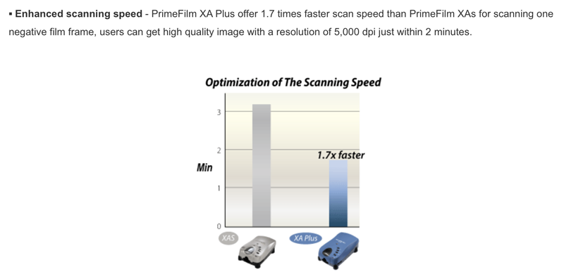

Id be curious how much faster the new model is compared to the XAs. That is what I have. When you are spending 4 to 5 hours scanning at 5000 to 10000 dpi per 36 roll, saving time would be a benefit. Again what slows me down (besides the high rez setting), is centering each frame for each scan. Sometimes I have to correct it, as its off. I think in the future Im just going to do digital camera scanning with a GFX camera. Until then, I use what I have available. I also use an Epson V850, and though its scans are soft, its colors are better and its quicker to use.
Last time I spoke to PI they said it is a lot faster.
My trick is to scan the whole strip and than center rescan the pictures I like.
What I really like I print from the negative
I dont find their listed time for 5000 dpi to be accurate for the XAs. Its closer to 4 and 5 minutes. Its around 7 to 8 minutes for 10000.

I am comparing both scanners. So far the Plus is almost 5 times faster at 5000DPI black and white with almost identical quality scan.
I am will do a separate post about it.
