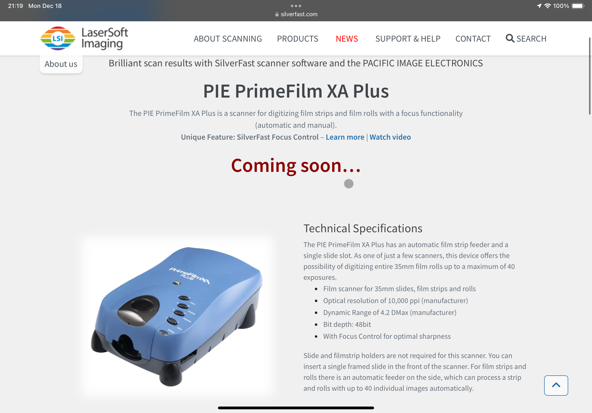

I really dont see any difference with the XAs and the new coming XA Plus. They look identical to me, even in the specs. I wonder if the driver for this new scanner will work on the older XAs? And they havent seemed to solve the issue of getting each successive frame centered on the scan, without readjustment.
You won't see a difference in form factor as that external form factor has been around for quite some time. Even the old Braun has the same form factor.
I would be inclined to get the XAs as the XA Plus, while being faster, does not work in Linux at present. I am not sure if Ed will be able to get Vuescan to work with the XA Plus for 35mm. Perhaps someone who is regularly in contact with him has an idea of what is wrong. I had heard that the USB implementation is where the problem is but I have patched USB drivers in the past to solve problems with certain hardware and recompiled the Linux kernel after hacking the code. If it's in the Linux Kernel USB stack where the problem is, that can certainly be modified and even set to only pass the new parameters when that scanner is plugged in and UDEV identifies the hex manufacturer ID and Device ID.
I had two XA Plus recently and they worked with Vuescan (Windows). They had other problems, but Vuescan compatibility was good.
