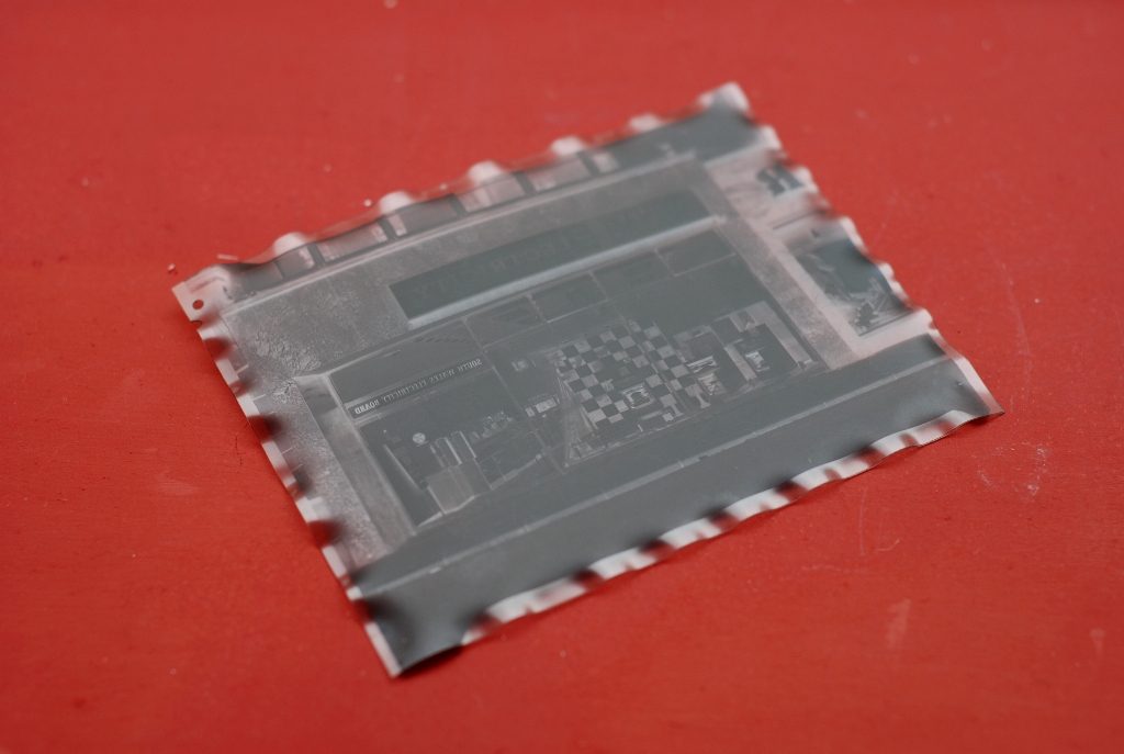

And so, someone just brought me a very oddly modified negative to ask my opinion on how, and or why it would have been done. It's been (very) physically altered for some reason, but for the life of me I can not figure out how or why.
It was brought to me by a local photographer who also collects images of the local town/area that we live in, and he recently bought this negative online. The seller doesn't know much about it's history other than it was taken by a family member who used to take images for the electricity board (back when it existed).
I've photographed the negative and before I describe it a little more, here are the images:

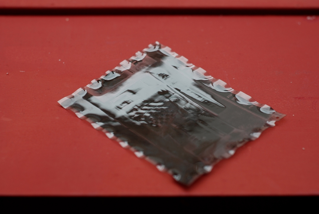

As you can see it looks like it's been crimped all around it's edge.

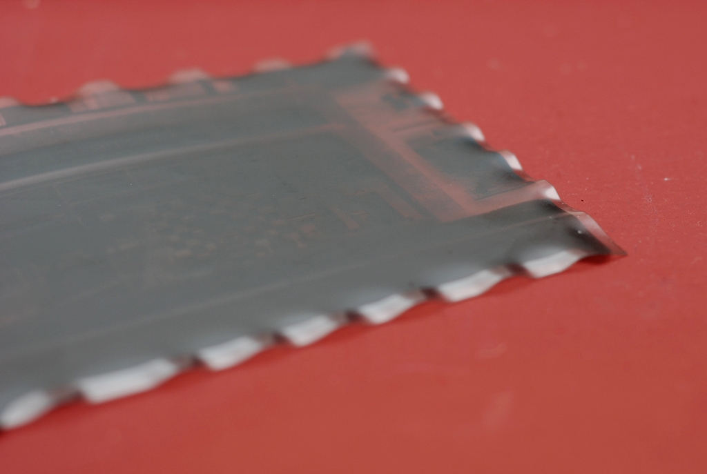

It's very evenly and precisely done, and must have taken quite a bit of force to do because the waves are quite high, but don't go very deep back into the negative itself (about 5mm).
But other than the crimping it seems otherwise normal, the non emulsion side is maybe a bit more shiny/plastic than normal, and has a little bit of a relief to it. It's a 9x12 b/w negative and the image was taken sometime in 60s, but on what camera is anyone's guess.
So has anyone seen anything similar to this before, and if so, how is it done and to what purpose?

I do not think it was intentional. Anyway, it is a matter of uneven swelling, shrinking.
I got samples of similarly warped sheets of acetate foil, with the warped edges not covered over time.
I would agree with AgX; i'll bet the negative is almost desiccated and probably very fragile. It appears the negative has been exposed to heat and low humidity over an extended period of time. However, it appears that most of the image area was somehow protected and didn't take the same amount of environmental exposure; maybe sandwiched in between small glass plates or something?
Very strange...
Desiccation though would induce different tension structures. Here the edges rather look like swollen. One sees similar at edges of book blocks, though due to fiber orientation not symmetrically.
Maybe that piece of film had been framed at its edges. Thus creating an autocatalytic reaction just at the edges, causing swelling.
In any event, it looks as if the emulsion is ready to lift, so I'd so something quick if it is important...
thanks for the suggestions so far, and I thought maybe heat, but would just heat cause such a uniform and even swelling all the way around and just at the edge?
and it looks more "pressed" than swollen, if such a distinction can be made.
and just to add, other than the edge, it's in very good condition. It's still just as supple and flexible as normal and the emulsion is fine. there isn't any peeling or scratches. And from the look of it (bar the obvious) it looks like it was pretty well looked after.

This was done on purpose. I have seen it before, but forget the details. The edge crimps are intended to hold the negative in place for work on the image itself. Note the 3rd photo. I'll bet the image is almost a relief image. I wish I could remember the details.

It has a slight - very slight - relief to the non emulsion side, but even saying that you have to really look to see it.
