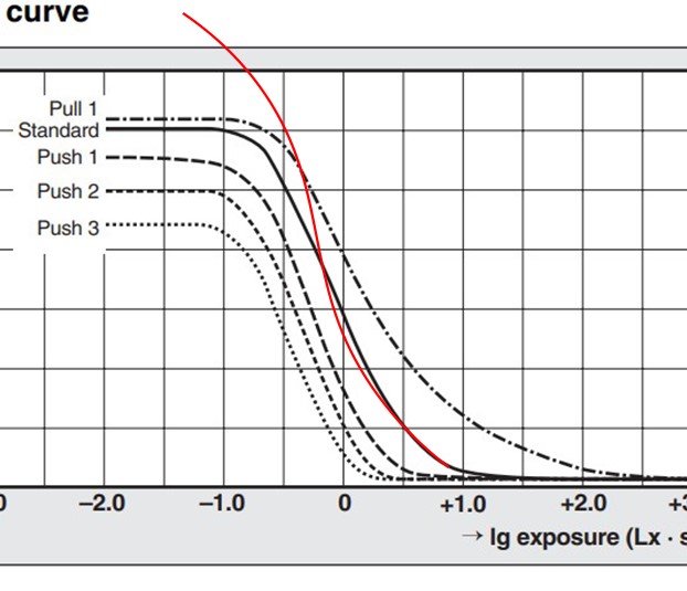

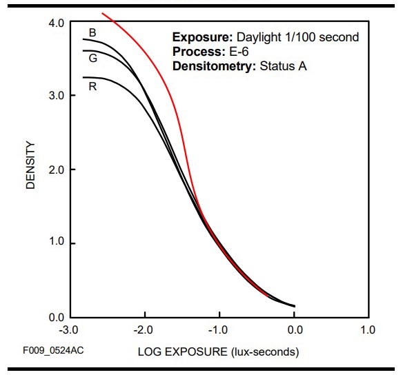

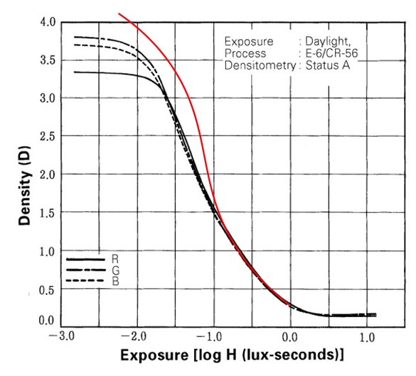

I've very (very!) roughly plotted the data provided & then superimposed the curve (in red) on to Velvia 50, E100 and Scala 200x's published characteristic curves (all scaled to match each other as closely as possible). The good news is that the highlights seem to track quite well with Velvia 50 and E100 (which both have remarkably similar characteristic curve shapes - at least in the sector that matters for tonal reproduction) - I'm not so sure about the gradient of the straight-line section or the transitions at the shadow end. A bit of fiddling around with the Wehner FP4+ curve suggests that a slightly lower Dmax and a sharpened shadow/ straight line transition could net a longer, less steep straight line, much closer to that of an E-6 film.
Klaus Wehner
Jan 1, 2022
57
Paderborn, Germany
Analog
Thank you! That is a very interesting comparison.
A black and white slide usually needs a higher contrast than a color slide.
Example: a red apple hanging in a green apple tree can be seen without problems in a color slide even without a high brightness contrast.
In a black-and-white slide, however, the contrast must be as high as possible so that the apple is clearly visible in the green foliage. Here, only the brightness contrast can work. This should be high enough to make as many details as possible clearly visible.
The three curves show well how a higher contrast contributes to a better differentiation of the gray levels.
A brilliant slide will be able to show more details than a low-contrast slide.
Best regards
Klaus
