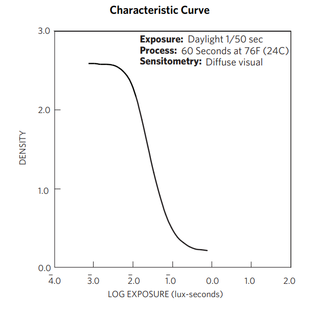

You're right - Kodak 2302 has very high theoretical DMax (~4.0). However, in a neg-pos system where this film is used, to achieve the theoretical DMax of 4.0 in the positive, the density range of the negative needs to be > 2.0. Is the negative film in the neg-pos system developed to this high density range?
Coming to the effect of flare in projection, here is a discussion that suggests that densities higher than 2.3 log D in the positive are generally not useful:
"Motion picture print film has a density range of 4.0 log D. From this one could expect to have a luminance ratio of 104:1 or 10000:1 in the projected image, which would exceed the recorded scene contrast. But the actual screen contrast is reduced by stray projector light and from light that first reflects of the projection screen to surfaces in the room and than reflects back to the screen. Both effects are summarized as viewing flare, which is 0.5% to 1% of the maximum screen luminance for good projection rooms. 0.5% seems to be a small number but flare reduces the contrast in the projected image from 10000:1 (4 log D) to 200:1 (2.3 log D). Therefore, the motion picture system has to squeeze a scene contrast of 500:1 or more into a screen contrast of 200:1."

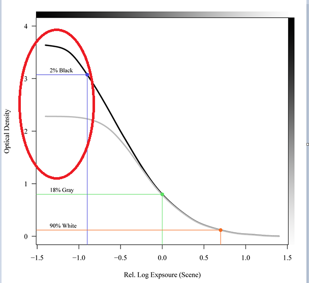

It seems to me that there a methodological flaw in this argument - it uses a slide of very low contrast but high uniform density to do perceptual evaluation of the projected image. Flare has little effect on the projected image when the contrast is low. It's effect, that of reducing the contrast, is noticed when the slide has high contrast. See the page whose link I shared in my previous post for a technical discussion of flare and its effect on projection.
I am certainly no expert on this subject, but IMHO the following is a better methodology:
1. Choose a slide that has clear highlights, good midtones and deep shadows going into DMax territory of 4.0 log D.
2. Identify a reference highlight patch in the slide. Measure its density using a densitometer.
2. Identify a few patches in the slide with densities in the range 2.00 - 4.0. Ideally, the chosen patches will have density throughout this range.
3. Measure the densities of these high density patches using a densitometer.
4. Project the slide in your normal viewing environment.
5. Measure the luminance of the reference highlight patch as well as the high density patches from the projection.
6. Compute the luminance ratio of the reference highlight patch with each of the high density patches.
7. Compare these ratios with that obtained from the densitometric measurements of the slide.
8. Due to flare, the two sets of ratios will not be identical. The amount of flare in the viewing environment determines at which density the ratios start diverging. With a flare of 0.5% you should see divergence at density 2.75 and above.

On a slide with an optimal maximum density of about 4.00, the deep shadows (zone I...III) are perhaps in the range 3.6...2.8.
Even with the influence of stray light, one can expect optimal differentiation here. Of course, all mid-tones and also the highlights benefit from a higher contrast.
This is not true IMHO. Assuming a flare of 0.5%, the deep shadow range of density 2.8 log D .. 3.6 log D in your slide gets mapped to the range 2.18 log D .. 2.28 log D in the projection. What this means is that there is not much effective shadow separation in the projection despite the high densities in your slide. This is also obvious from Figure 2.9 of this page on the effect of flare.
Ironical it might seem, but if your deep shadow was in the range 1.7 log D .. 2.3 log D, you would get better shadow separation: 1.60 log D .. 2.0 log D. So for best shadow separation in the slide, it makes sense to aim for a slide DMax that is a little above the DMax of the projection for the expected flare factor. For 0.5% flare this is ~2.5 log D.
As you can see there is definitely a tradeoff between midtone contrast and shadow separation in the projection due to the presence of flare. Optimizing the slides for midtone contrast alone comes at the expense of poorer shadow separation. Optimizing the slides for best shadow separation results in poorer midtone contrast. As @Lachlan Young opined earlier, none of this would have eluded the thought process of the scientists/engineers who were in the forefront of film design and processing. I believe typical DMax of 2.75 log D - 3.2 log D for slides must have been a consequence of trying to achieve a reasonable tradeoff between midtone contrast and shadow separation.

Take a look at the portion of the curves inside the red oval below. The black line is the density curve and the gray line is density after taking into account 0.5% flare on the projected image. You can see that the high densities corresponding to the deep shadows in your slides (2.75 log D .. 3.6 log D) get mapped to very narrow density range (2.2 log D .. 2.3 log D) in the projection due to flare. Though there is substantial shadow separation in the slide (0.8 log D), there is very little in the projection (~0.1 log D). So high densities in the slides don't mean much as far as shadow separation in the projection is concerned. This is what I tried to explain in my previous post. Hope it's now more clear.
It's not too difficult to see from the above graph so see the tradeoff between midtone contrast and shadow separation in the projection. The steeper the black curve gets in the shadow region, the flatter the corresponding part of the grey curve will be. Increasing the contrast of the slide does increase the midtone contrast of the projection but at the expense of poorer shadow separation.
