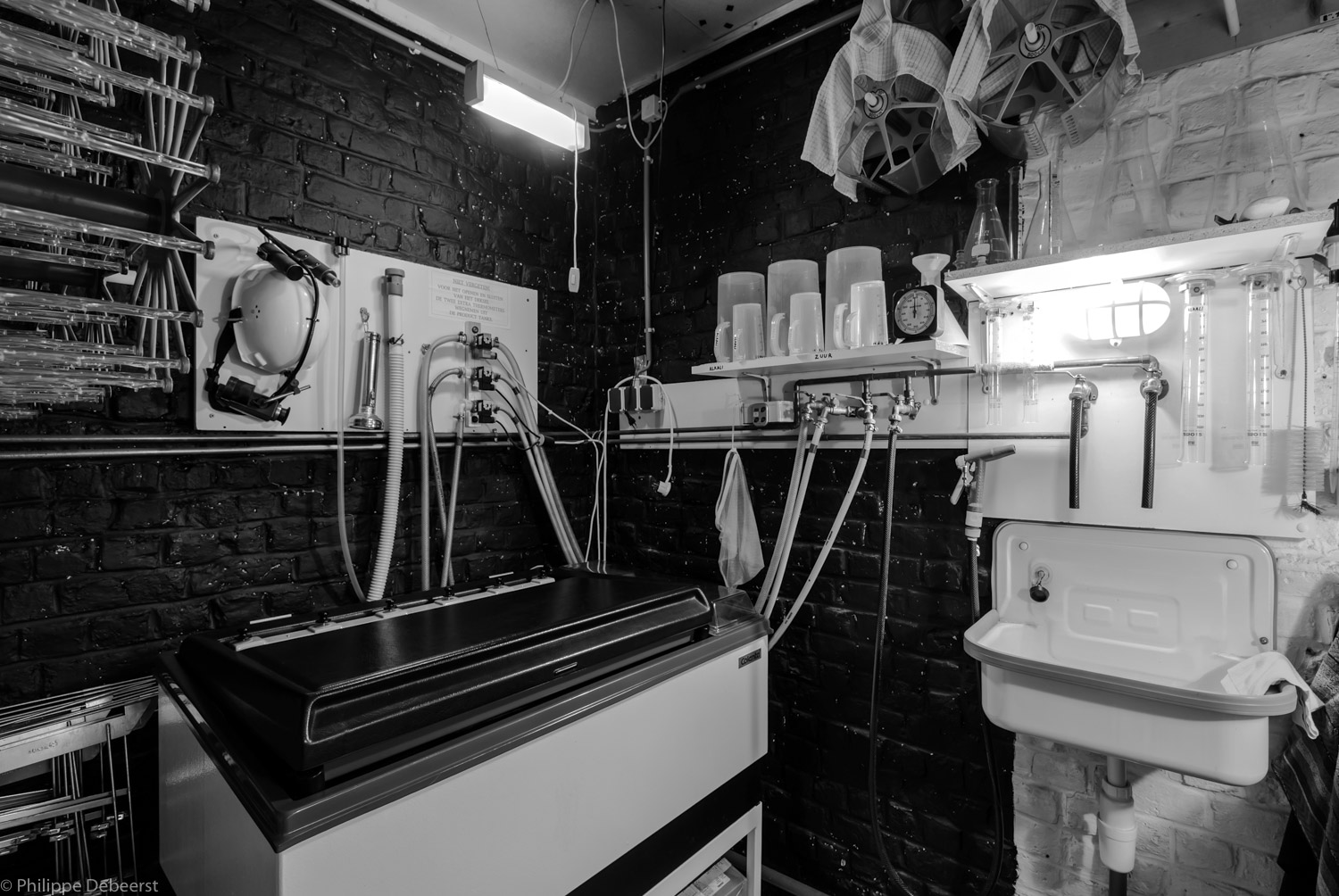

If somebody, in the EEC, would like to startup a new Scala or B&W reversal processing service, my Colenta developing machine is for sale.
At the time, I did a lot of B&W reversal in it, the process I used was based on the glorious AGFA DIA DIRECT system, modified for a more 'general' use.
Particularly the Ilford Delta 100 was very good in this process.
The machine comes with a lot of accessoires and the elaborated formula (some baths have to be home brewed as they can't be purchased any more).

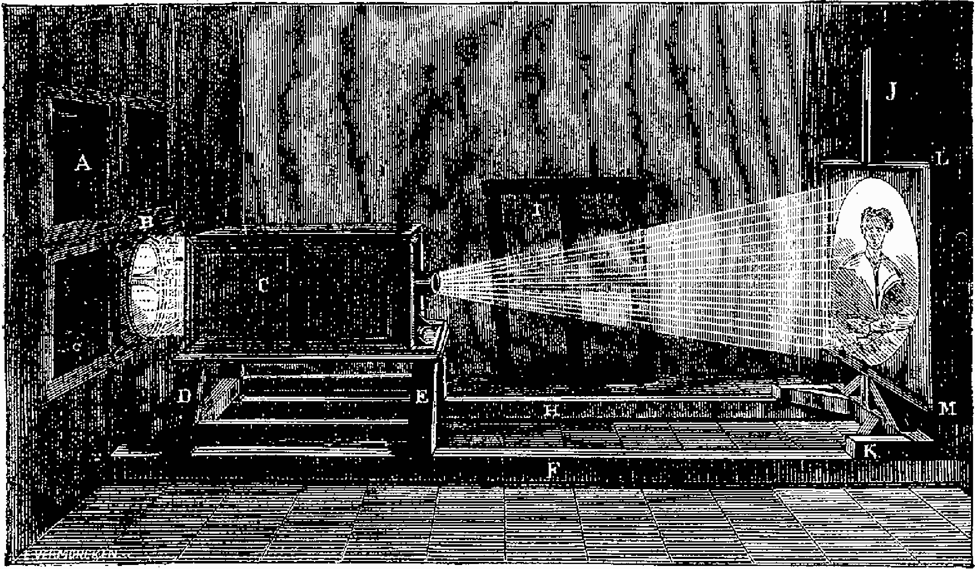

As an aside, the worlds first company, in medio 19th century, to produce photographic (glass-) plates on a for that time large industrial level was the Belgian chemist and scientific researcher Désiré Van Monckhoven in Ghent, he also invented the enlarger (which worked with sunlight).
