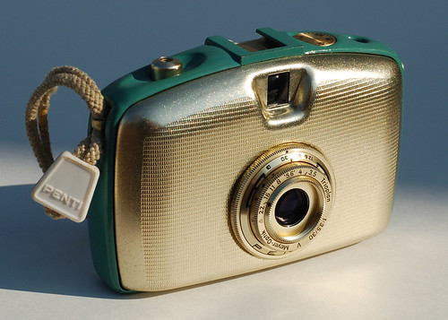

The first film camera I ever shot was a Penti half frame that used the Rapid film cassette (the GDR/DDR version)
