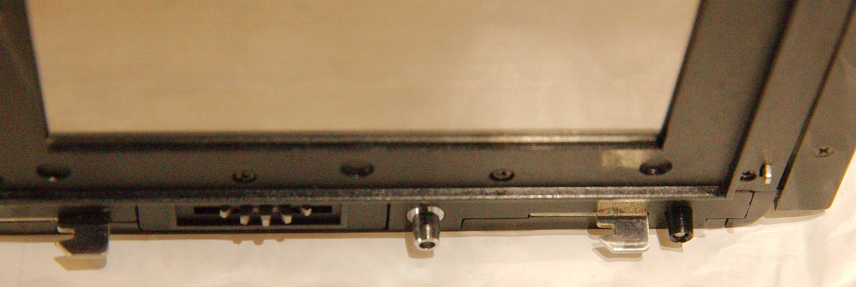

Could you post a photo of the side of the back that mates to the body? It is intuitively odd there would be two sets of electrical contacts on the back...the only electrical data should be the ISO setting for the film which is loaded.
There is a mechanical interlock...
  1. which should prevent the shutter from being released when the film has not been advanced to the next frame (unless there is a multi-exposure switch set on the body of Bronicas with that feature), and
  2. there might be an interlock on Bronica backs (depending upon vintage of back) which prevents shutter from being released if the dark slide has not been removed.
The fact that you do not get same metering result when switching backs is pointing to some issue of uncertain origin.
The two mechanical pin connectors between back and body on a Bronica ETR, SQ, or GS, as wiltw said, communicate whether the back and camera are wound, and whether the darkslide is in or out to prevent shutter firing when the darkslide is in. They don't have to do with metering.
All Bronica backs of these systems prevent the shutter firing when the darkslide is in, I believe. However, only the later generation of backs prevent removing the darkslide when the back is off the camera, I think that's the generational difference wiltw was thinking of. You can tell the difference because the later darkslides have a little notch near the bottom, and the backs have a little sprung metal piece that engages the notch. (On the ETR and SQ, the later darkslides with the notch have a gray handle. On the GS, I think all the darkslides have the notch and a black handle. That's real Bronica trivia.)

Thanks reddesert. So the ISO and exposure compensation settings are passed to the AE finder via the two gold hemispherical contacts at the upper right of the film back ...?
For a while I had only one dark slide between two backs - which at first was a problem. Turns out (file this under more Bronica trivia) that there is a tiny metal nubbin (maybe your 'little sprung metal piece'?) on the bottom of the film back, near the dark slide handle, which when pressed allows the dark slide to be removed when the back is off the camera. To insert a dark slide into a loaded, off-camera back, press the nubbin in and insert the slide. Maybe this is common knowledge - but it took me a while to catch on.
Yes, your metal nubbin is the piece I was referring to. If you depress it (with back off camera of course) and slide the darkslide in and out, you can see the pin connector at lower right move in and out to indicate the presence of the darkslide to the camera.
The two electrical contacts at top are how the back passes film speed to the meter prism. I think it's just a variable resistor but don't know exactly. To put some numbers on it, I measured and with one back I get a resistance of about 1000 ohms when set to ISO 100 and 0 exposure comp. For every stop you change the film speed or exp comp, the resistance changes by about 200 ohms. You could measure your two backs with an ohmmeter and see if there is a difference. I don't know what the "correct" value is, although a repair manual would likely say. I don't have a GS meter prism.

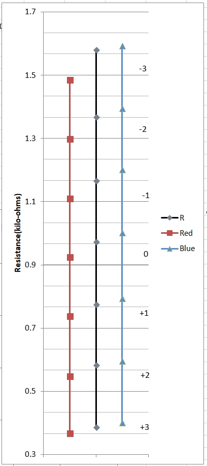

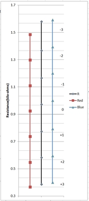

reddesert, I followed up on your excellent idea, on my three GS-1 6x7 film backs. They do show some variability, which would account for some of the metering inconsistency I've been experiencing. A plot attached, showing resistances that I measured at ISO 100, for exposure compensation settings -3 to +3, for three backs (red, blue and black lines). Your measurements would fit in nicely with the data for my three backs.
This is of pretty modest interest, I think - rather than establish a reference back and refering to a correction sheet in the field, I'd just use a spot meter. But it's good to know where errors are coming from, and what remedies might be sensible to pursue.
On the plot, the vertical axis is in kiloohms - the data are resistances that I measured at various exposure compensation settings (noted in a hand-waving way on the right hand side of the plot), for three film backs labeled R, Red and Blue.

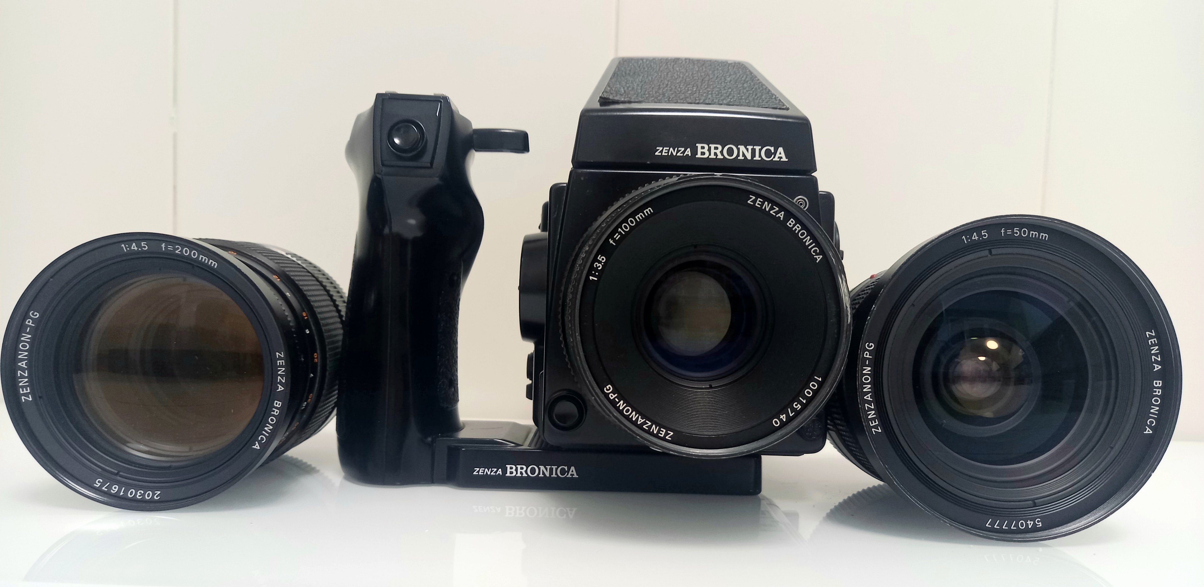

A nice Bronica GS-1 kit has shown up today at home. My Pentax 67II still does not know it yet in case she gets jealous. The kit matchs very well my usual set of lenses with the Pentax (55, 105 and 200 mm).
Some thoughts after playing a little bit:
- Focusing screen: Dim, very dim compared to the Pentax and without any focusing aid. It is ok for the 100 mm but not for the 50 mm and 200 mm. If I keep it I will buy a Rick Oleson's.
- AE lock button: It is in a very uncomfortable place, perhaps I will get used to it.
- Filter diameter: Three lenses, three diferent filter diameter (72, 82 and 95 mm). Not cool.
- Double strock advance: With the grip. Seems it needs one for film advance and another for cocking the shutter and mirror return, both feel very smooth. Not really a problem but it slows down a bit compared Pentax 67 single stoke.
- Shutter operation: Quiter (still noisy) and smoother than the Pentax.
- Weigth and size: With AE prism and grip Bronica weight is very similar to a Pentax 67II, and with worse mass distribution. Both are similar in total width and height, Bronica has more length than the Pentax due to the modular design (body+back).
I am a big fan of Bronica SQ-Ai but this GS-1 clearly falls behind in terms of usability, at of course the same compared to a Pentax 67II. I did a quick test roll to be developed tomorrow to validate the working condition and more will come if there is no unpleasant surprises. At the end of the day image quality and reliability is what I care the most.

Good luck with that kit! I selected the 65 and 150mm lenses, along with the G-36 teleconverter, as it gave me a good range in focal lengths and only 72mm filters.
Without the speed grip, I found the GS-1 awkward to handle with the prism finder - a strap + a waist level finder would have worked a bit more comfortably. The speed grip was the ticket to easy use for me.
As you might glean from earlier thread entries, the AE system gets mixed reviews. I'm curious to hear your impressions.
I use my GS-1 mostly for landscape work (hiking in the Rockies). I always have a tripod with me so that obviates the need for the speed grip (which I have). I have a 72mm polarizer from my digi cam lenses, but mostly use Cokin filters for the GS-1. The 50mm and 250mm lenses that I have are razor-sharp, as is the 110mm macro. I really love this camera.
Your first impressions of the GS-1 mimic mine. You won't be disappointed by the Oleson screen BTW. One thought: you got unlucky with the lens selection though. It just so happens that these 3 all have different filter diameters. Have you gone with the 65, 100 and 150 trio, the filters would have been the same.
Also, I would confirm @Tony-S assessment of the lenses. Never had any sharpness issues. But honestly, are there really bad medium format lenses from the 80s out there? Even much older systems like my Mamiya C220F comes with excellent lenses.
This kit is not an accident. I knew in advance the filter diameter discrepancy but I choose it anyway because is more or less what I am used to in my Pentax 67II (55, 105, 200). I don't know if 65 mm is wide enough for me and I love the PS 40 mm of SQ-A system, this 50 mm looks like its brother. I really like the compression of 200 mm in 6x7 (not only for portraits), I had the Pentax 67 165 mm f/2.8 and I sold it because I prefer the 200 mm f/4 perspective even it is one stop slower. My filters are all 77 mm, I can step up the 100 mm filter ring from 72 to 77 mm (already had an adapter from other lens) and I hope I can step down the 200 mm filter ring down from 82 to 77 mm. 50 mm is completely out of the question for filters.
