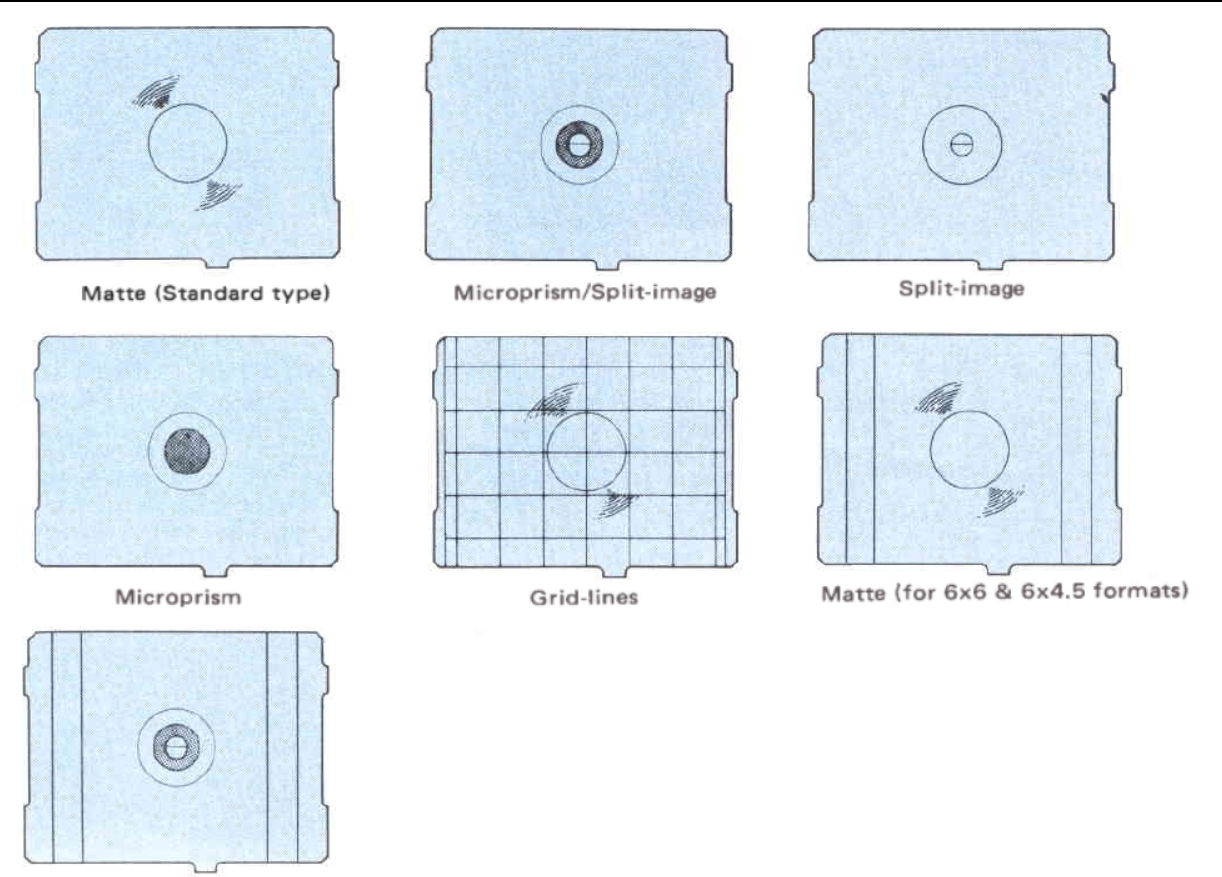

Steven, the GS-1 user manual component chart indicates that there are 7 'G' screens - which one are you thinking of? The image below is from the user manual. I assumed that I had the 'Matte' screen, which was quite dull (even after cleaning).
@tom williams Mine is Matte (standard type) and it came in a box which simply said "G" on it, so I assumed it is the type name. Judging by the photo posted by @halfaman above, it is brighter than his because the entire screen is as bright as the center spot.

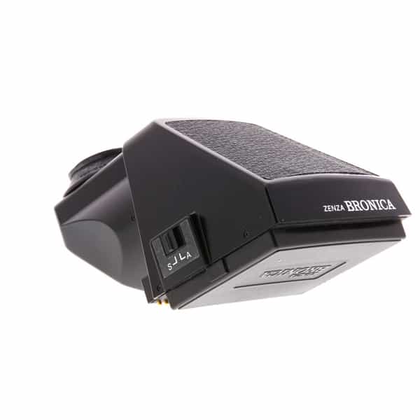

Just a quick question to any Bronica GS-1 users out there. I’ve had 2 Bronica GS-1 camera bodies, each with their own GS AE Finder. I sold one of them, however, BOTH consistently underexpose my negs by one full stop.
It’s making me wonder if I should really be using a 6V Silver Oxide battery instead of the 6V Energizer Alkaline (the 4LR44/A544 battery as seen in the attached photo).
Do you guys think I’ll be getting the proper exposure via the GS AE Finder if I went with a 6V Sliver Oxide battery, or will it not make any difference whatsoever?

The silver oxide batteries are much more likely to supply the correct voltage for a long time.
An alkaline battery will only supply the correct voltage for a portion of its life.
