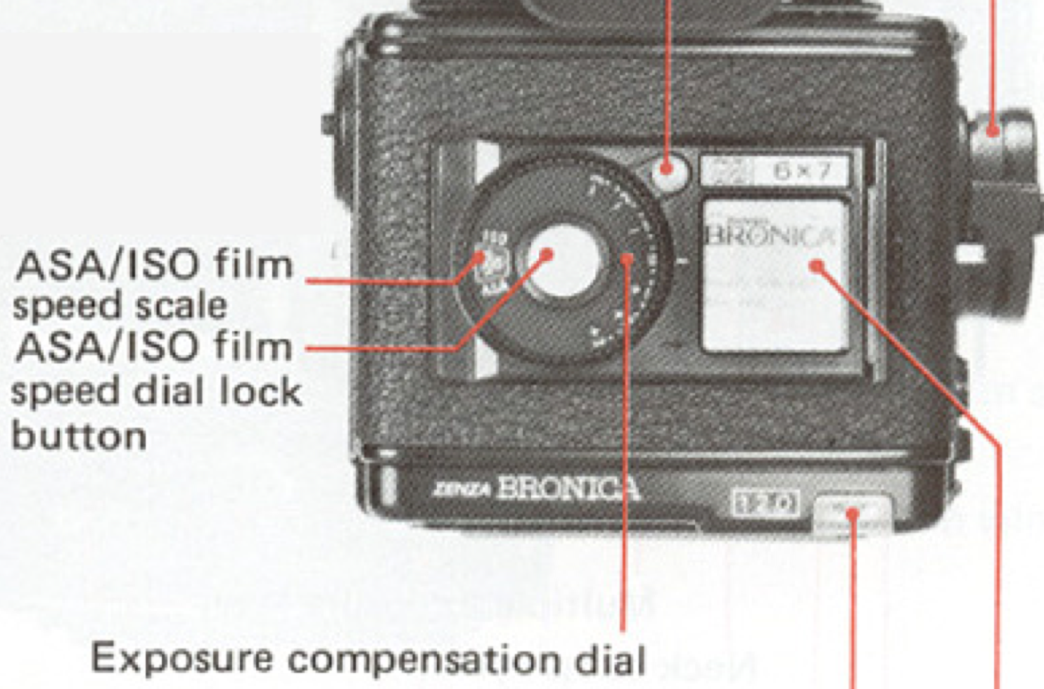

Million dollar question: Does anyone know where I can get my Bronica GS-1 serviced and have the camera's meter's tendency to underexpose everything corrected?
I've taken cameras apart before and have a pretty good grasp of their mechanics. I wonder if the underexposure issue is something I can fix by resetting the ISO dial on the GS-1's film back so that when we read 400 ISO, the camera is really reading 200 ISO.
That said, I've been wondering whether the GS-1's underexposure issue has more to do with the film back - which has the both the ISO dial and the exposure compensation dial - rather than the AE finder.
Or even more likely, the connection between the back and the camera.
The meter depends on the information about the film speed set on the back.
Do you have more than one back?
Following this lead, I checked my two camera backs, and they do differ. I made some observations by setting both backs to the same ISO, fixing the lens aperture at f11, and then metering an indoor scene under constant illumination. I noted the speed indicated in the AE display for each exposure compensation setting, for both backs. The metered shutter speeds for one back were consistently slower than for the other back. The differences ranged from from 1/3 stop to 1 full stop, with the larger differences at higher shutter speeds.
This after cleaning the gold-colored hemispherical contacts at the upper right of the back, and on the lower right of the finder.
I noticed two pin-type connectors at the lower inside surface of the back, with complementary features on the camera body. One near the ISO dial, the other not. Does anyone know what these connectors are for?
