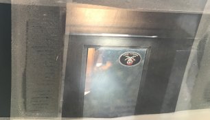

Yes and yes. The Pentacon Six has a reasonable built-in loupe in the view-finder and I have also had other persons confirming my opinion of 'correct focus'.
I tried with parchment paper yesterday, but couldn't get any usable readings on it. At least my parchment paper has a far too strong texture or structure to provide a clear enough projection to evaulate focus or sharpness. I tried to get a roll of translucent tape, as somebody else suggested, but I haven't found any. I'll give it another try tonight.
You don't need anything all that special. If you look at the attached image you can see how I did it. I took a piece of clear 120 leader and roughed it up with some sandpaper to give it texture and taped it flat to the film gate. As you can see it projects a very clear image. It's best to do this during the day when you have bright lighting as it will be very hard to see your DIY ground glass in dim lighting. In all it took me about ten minutes to set this up. If I wanted to make sure it was absolutely flat I would make a carrier out of some foam core and then tape the film to a mask sized to the film transport and stretch it tight. Then I would place the assembled carrier flat against the film gate.
Edit: Revised text for clarity

This is the tape you want https://www.amazon.com/s/ref=nb_sb_ss_c_1_13?url=search-alias=aps&field-keywords=scotch+magic+tape&sprefix=scotch+magic+,aps,505&crid=3TAZVBPQIORB5
Scotch Magic tape not transparent tape as I stated earlier.
