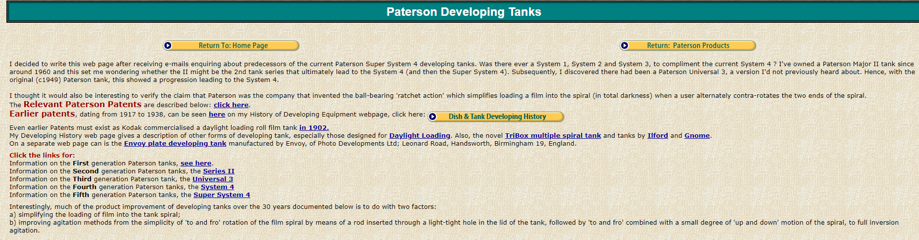

Everything you ever wanted to know about Paterson Developing tanks:
and the link for the above: https://www.photomemorabilia.co.uk/Paterson/Developing_Tanks.html

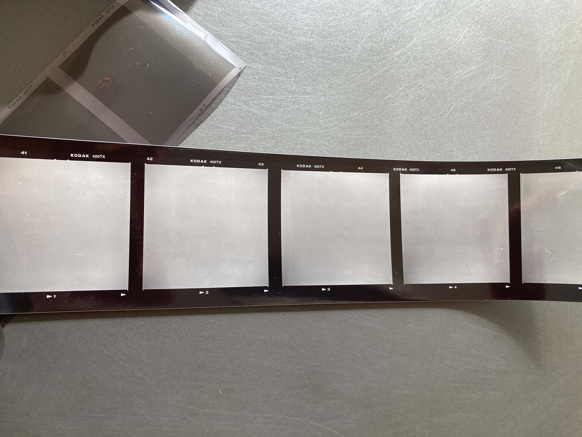

When you load the reels, is there any chance that the film itself is rubbing against something, like your shirt front or the edge of something?
It's all a bit blurry still but I can say that the 1 min initial agitation made a dramatic improvement and I think that pre-soak adds a little extra evenness although pre-soaking before I tried the added initial agitation time did not provide a noticeable improvement.
Can these streaks be the infamous bromide drags?
Not that I know, but these drags are always coming off from perforations, in 35mm film mostly, 120 hasn't them
The twizzle stick gave me horrible results could you please detail how you use it ?
Sorry, Vania, I missed this. How can this benign gadget give you 'horrible results'? This is what I do: Film in tank, lid on. Pour in chemical. Start timer. Insert twizzle stick and twiddle backwards and forwards between finger and thumb for about 10 sec. Remove swizzle stick (and wash it before the next chemical goes in). Snap on the outer cover and 'burp' it. Tap the bottom of the tank on something firm but not too hard (I use the heel of my other hand) to dislodge any air bubbles. Start inversions at 30 sec until the end of development (or stop-bath or fixer).
I use the swizzle stick like this at the start of each process. For the final wash, I always use the Paterson force film washer which forces water up through the spiral(s) from the bottom of the tank. However, I always take the lid off first, to avoid chemical residue pooling up in it around the washer hose.
I saw a suggestion by @koraks in another thread, see if it might help.
https://www.erikgouldprojects.com/coldcoffee/2016/12/31/streaky
Good find, looks remarkably similar. Rapid introduction of chemical to film or vice versa; and immediate agitation. I maintain that Paterson Super System 4 tanks are the best option. Fill rate is amazing, and the chemical swirls in through the spirals. One can get a twizzle stick in and use it, faster than one can get a lid on and invert the tank.
I've never inverted, I always use the stick for agitation and I have never had streaks on my films like the OP.
9. Presoak... That could be a solution.
Otoh I've heard that processing 120 films shouldn't include a water pre-soak.
Oh I don't know where I remembered this from, but I have somewhere in my mind: the larger the format the more necessity of pre-soak. And when I think about it, this is logic too. When the developer hits the dry film there's much more chance of unequal distribution because a dry surface does not receive wetness in one stroke, you need it to be wet for an even distribution by way of capillary action; the surface sucks the developer then. You can see that in uneven developed skies in 4x5" e.g. Good agitation in the first minute can reduce that problem, but with big films that is less easy to do it quickly
I presoak all film except Kodak Tri-X when processing in XTOL using a Jobo processor because both Kodak and Jobo clearly state not to.
Thanks for the link! This tends to confirms the origin of the streaks as being link to chemical reaction when introducing the developer and/or during the first seconds. As stated already I have tried both type of tanks Paterson and steel tank with and without pre-soak, pouring the developer in the tank (including the Paterson type) and dropping the reels in the developer in the dark, as well as with or without the Paterson twizzle stick (worst results by far!) But none of these had any effect. So the defect is happening anyhow, unless I agitated for the first minute. This maybe due to the active nature of HC110 as dilution B and I definitely should try a higher dilution as suggested before. I don't get perfectly even negatives (when shooting a grey card) though but I will work on that.
I sort of conclude that there is nothing wrong and that I just have to agitate for the first minute with this developer now. I am just very surprised that it is happening now after more than 10 years of use... This does match the recommendation of "Way beyond monochrome" and Steve Anchell's 'Darkroom cookbook" :

I include a picture of the best result I got so far which is a tremendous step forward but I can still see some discrete streaking. Although is does not show well on the picture. Plus the now denser sides perhaps due to the increased agitation necessary to solve the streaking issue. :blink:
