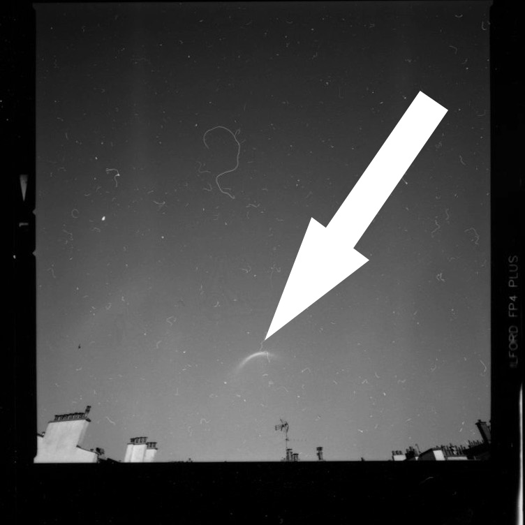

I did notice on one of the frames posted here that there was a crescent moon mark on the negative. This usually suggests that the film was kinked and this again usually happens at the film of either removing backing paper and/or loading onto reel. (see below)

Do you think the kink from loading would affect the film on all it length ?
The kink would only affect the spot where it is.
... Leastwise, that has been my experience.
