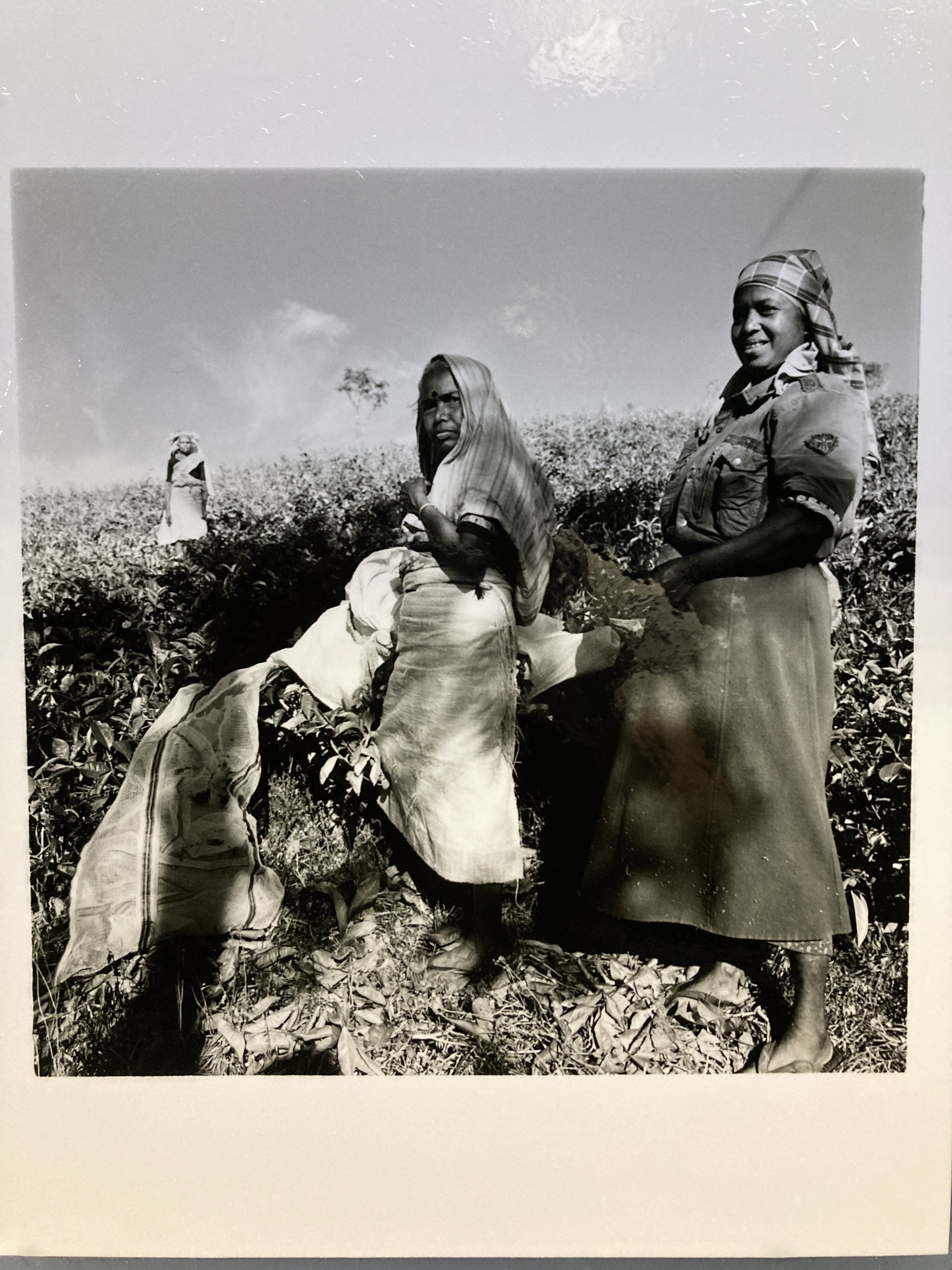

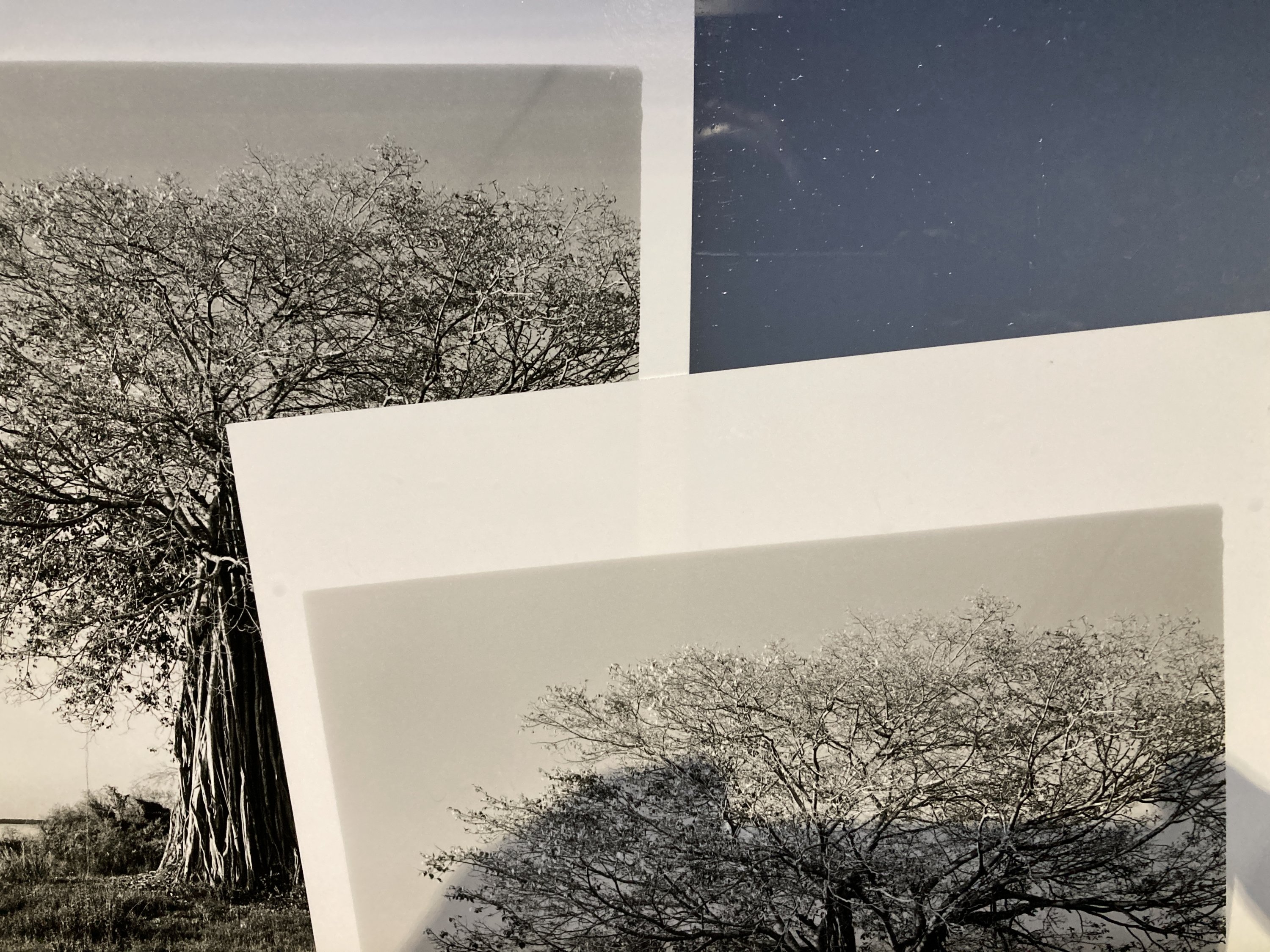

Because it does so on some paper as I detailed in a previous post with pictures to illustrate
Ah, I thought we were talking about film development around which the problem centres.. Yes paper development is, I agree, a different kettle of fish and an acid stop bath is clearly necessary
pentaxuser
pentaxuser
Sorry not at all what I am saying. If you read just a couple post up you will see that I have systematic streak with paper and acid stop bath. it's all explained in the post.
