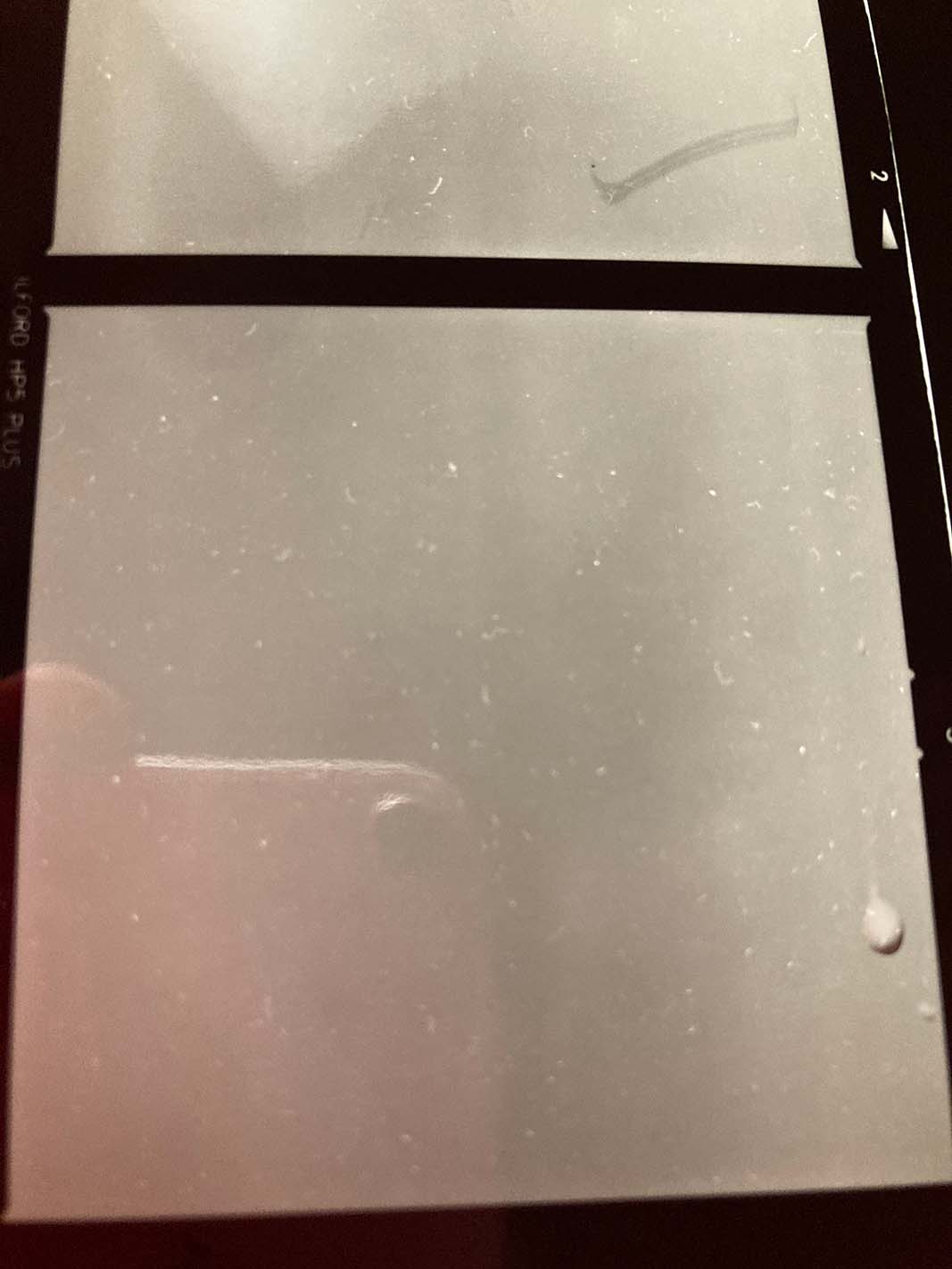

I have spend a lot of time thinking about the source of the problem and I too have come to the conclusion that the tank has not been filled enough and that bands on the film are a result of insufficient chemical volume needed to properly cover the film.
I don't think this is a processing system fault. If it was light leaks during darkroom handling, I would expect to see the bands between the frame spacing as well as in the image area. I'm leaning toward a camera problem.
Do you have anyone near you who could expose a roll of film for you in their camera and you process it as you normally do? I think that would narrow it down to either a camera or processing problem.
OP says that lab-developed film did not show the artifact. That would point to processing, especially in the light of this happening with many different cameras. I'm stumped.

But even then, Matt, the light never consistently fell into nice neat bands roll after roll. I believe that there is not enough developer in the tank and that is the cause of the very consistent banding. Definitely a camera problem, photo finisher problem or a tank problem.
The lines are totally parallel with the film edges, yes? To me that points to pressure marks. I don't know hasselblad backs, is it possible for them to malfunction or to load them wrong so that they produce pressure or stretch marks like that? Rubber bands around exposed rolls have already been mentioned.
Yes, I thought about push exposure too, but then it is a little strange that they are not very straight and bend off the image sometimes, not impossible, but interesting. Plus, Viana told that he used all his camera’s with all backs random. There’s not one back I understood.

So after trying all possible variations of development method and agitation pattern possible I finally had twice usable negatives again. But they are not perfectly even and streaks can be perceived on some views. Mainly because I am shooting a zone VI white board, but it will probably not be discernable on a textured surface. So at least I know I am on the right track. Here’s what changed that made a difference :
  1. Using more chemical. 500ml instead of 450ml in steel tank (haven't tried this on the Paterson tank yet). This change alone did not do anything and maybe is not needed but I suspect it was part of the problem. Although my reels were always well covered before, I think there was too much empty space in the tank. This was probably allowing part of the film to be out of chemistry during inversions. This is a wild guess since using a Paterson tank with the twizzle stick only and no inversion, just rotations of the stick, did bring some streaks too, but more in the center of the frame.
  2. Most importantly and this is the game changer : constant agitation for the first minute and not just 30s. I tried everything and nothing else worked until I implemented this. Then it’s 5 inversions every 30s.

It is completely mind blowing to me that this 30s more of initial agitation has such a dramatic effect. Even more so that I processed hundreds and hundreds of films with just an initial 30s agitation for years with no issues… Should also add that the lab guy whom I gave some films to test told me that he uses the Ilford recommended method of only 4 inversions at first then 4 inversions every minutes after that. He uses Paterson tanks and always avoid being much shorter than 10 minutes. Trying this gave me the worse results at 8 minutes development time. Go figure... someone probably sliced a chicken throat on a picture of me or something...
This brings me to the conclusion that more agitation is the best course to achieve even development considering my current karma, although probably not in force but in quantity. So changing to a Jobo rotary system probably makes sense. They have little rollers to allows manual rotation which makes the whole system quite reasonable. The question beeing which one to choose for best even development the 1500 or the 2500 system ? And do they both work well with the hewes reels (the ones with the large center for Jobo) ?

Some of the rolls seem to have two, others three of these streaks, leading me to think it is not insufficient chemicals or agitation. Since the streaks look continuous, but not always in the exact same position, my guess it is coming from loading or possibly in-camera. When the shutter opens, I believe there is a baffle that opens, too. Could there be something happening there? Also, could some light be reaching the film during loading, reflecting off the metal reels? Have you tried plastic reels in a plastic tank?
When you empty the tank of developer you need a stop bath whose purpose is to stop the development still on going even though the tank has been emptied of all developer, except of course that developer which sticks to the film surface until neutralised by acid stop immediately or by washes of water which take just a few seconds longer
That's a very good point. There's no sense in pouring in your stop-bath (or dev or fix), then immediately taking it away by inverting the tank. On the other hand you need to ensure the chemical quickly reaches every part of the film. That's why Paterson recommend the twizzle stick when the chemical is first added, with inversion agitation thereafter.

Honestly I think increasing the duration of agitation is a red herring, because most people don't do that. Likewise pre-washing.
You originally described 'sharp inversions', and I wonder exactly what that entails. In the Paterson tank at least, the liquid that gets into the funnel when the tank is upside-down needs time to drain back before you invert again. I reckon a single full inversion takes 2-3 sec. which is not what 'sharp inversion' suggests to me. (Your metal tank may be very different, I have no experience.)
Not wishing to pile on the agony, but I can't help noticing that you've got a serious dust problem too ... :whistling:
