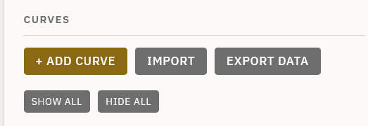

Website does now again host the most up to date version, implementing these new features:
1) New look
2) Ui bug fixes
3) Show all and Hide all curves buttons

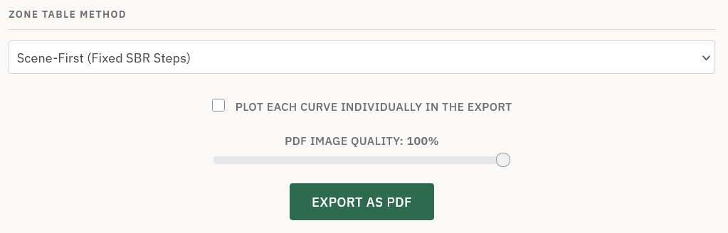

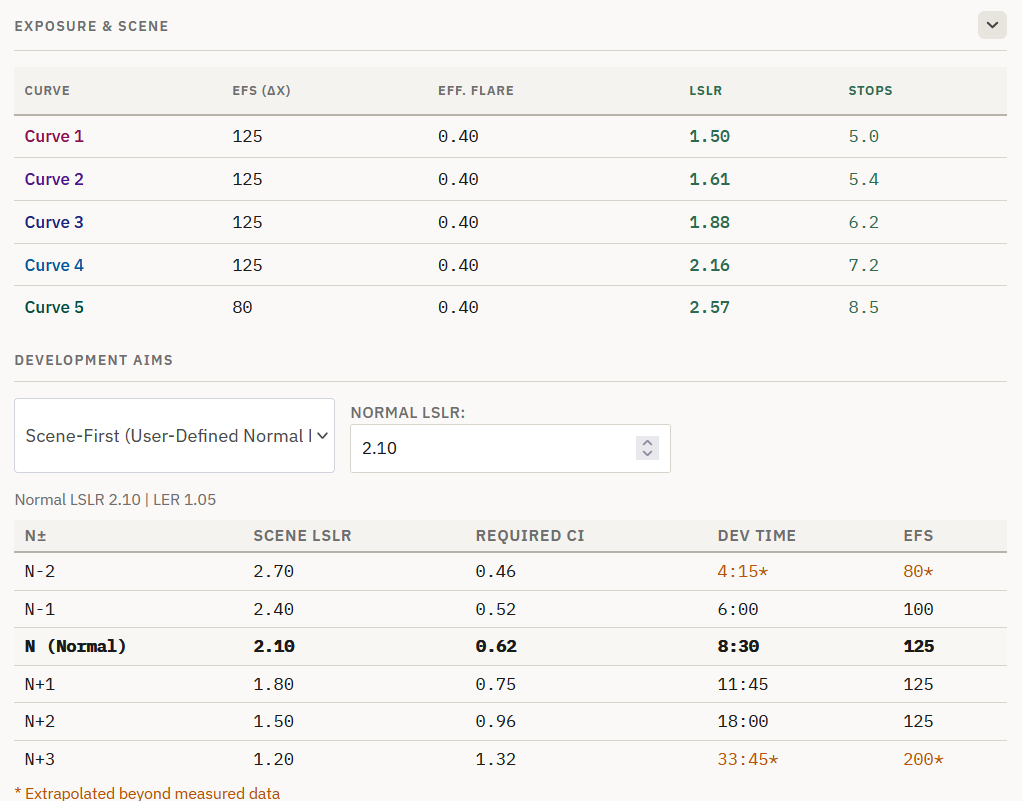

4) An option to choose how Normal is defined in the Zonesystem table - you can choose between a Ci you define as normal or use the auto select of the tool that is based on your entered LER (Negative density range required for your Paper) and the dynamic flare model
5) Curves are now no longer stretched optically, Y and X axis are now displayed as the same interval

3) The website now features a compare film button that lets you plot all the data of up to 10 films against each other and export separately as a PDF

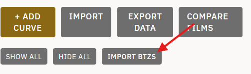

BIG Feature
You can now import your BTZS save files into my program. This will import all curves and data you configured in BTZS into my software.

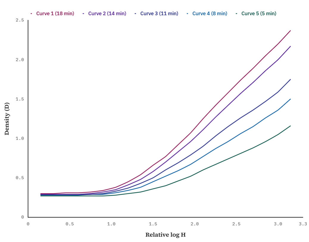

You will need more than one set for data to be extrapolated. I would recommend at least 5 different curves. from lets say 4min dev time to 20 min or so

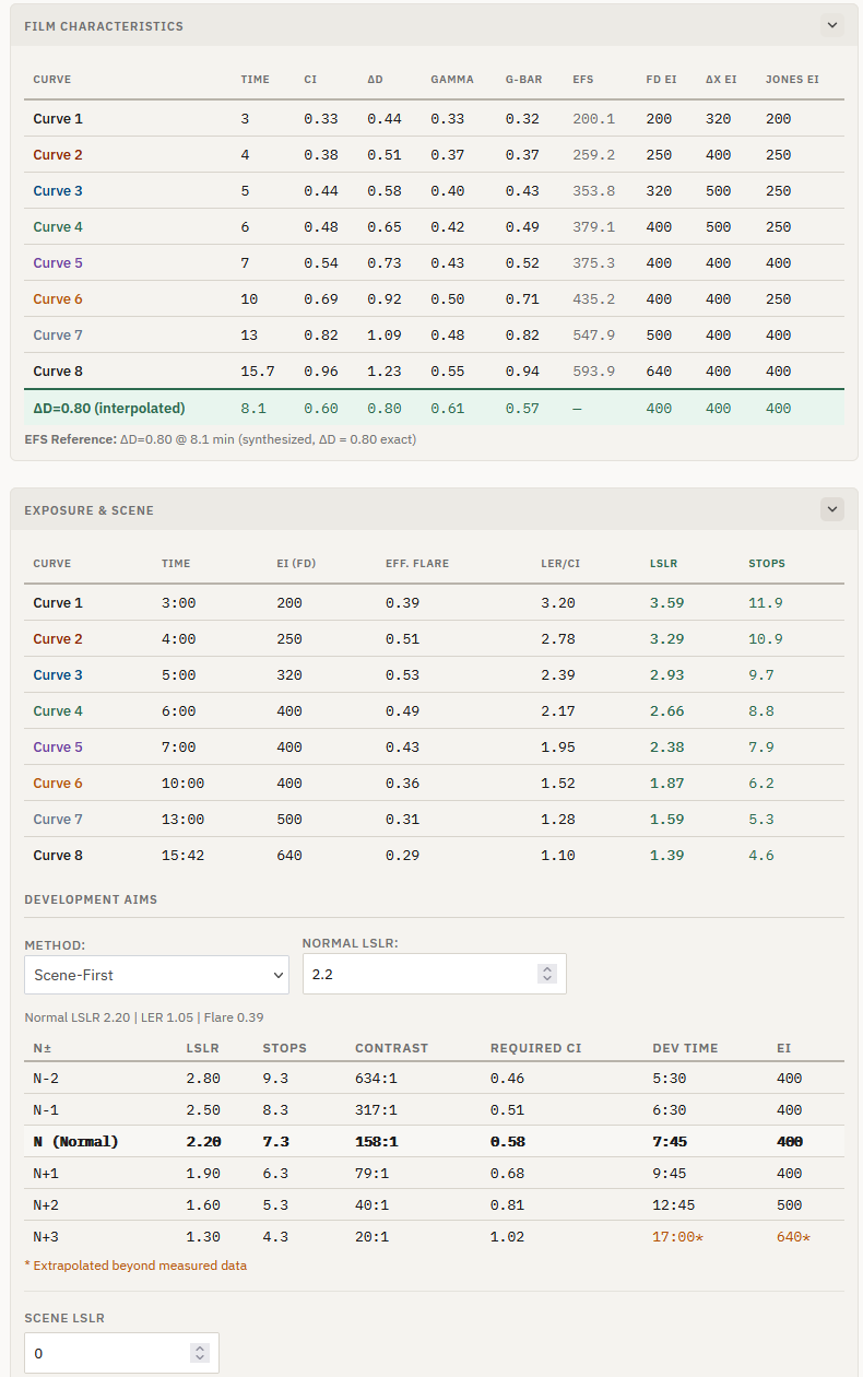

The software now allows the user to see more info in the User Interface.

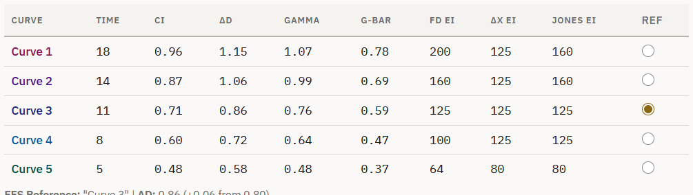

The first table shows all relevant film data: Delta D, Ci, Gamma, Gbar, Fractional density EI, Jones Criterion EI, Delta X EI
The second and thrid table show scene and exposure related values, Like N numbers, LSLR and Flare. Here you can also define your own Normal, your target LER and the flare model you want to use.
I also removed the mathematical clamp on delta X and just made the software switch to Jones Criterion should Delta X start to fail mathematically.

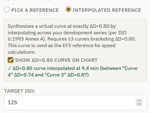

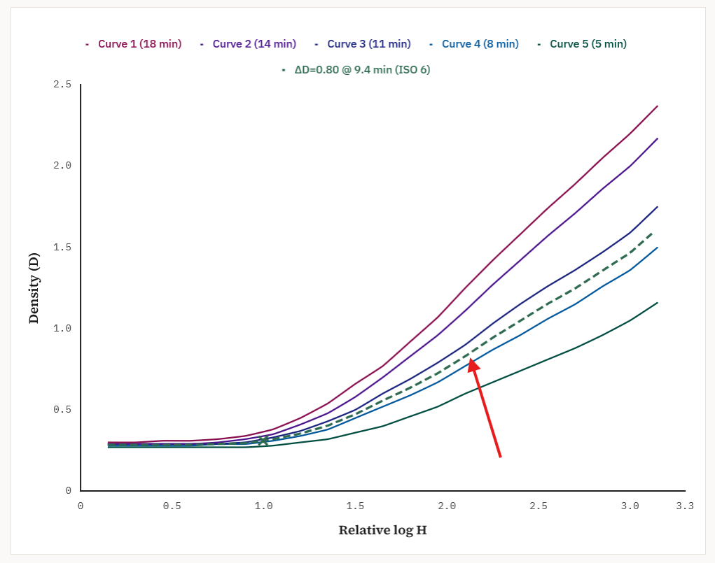

The reference curve feature has been overhauled. Now you can choose between a reference curve you have actual data for and is within your curve set (that's the pick a reference option) or you use the interpolated reference option. This interpolates a perfect Delta 0.80 curve out of your data and therefore gives you no need to try to develop a 0.80 curve precisely.
the interpolated curve will be shown among your curves

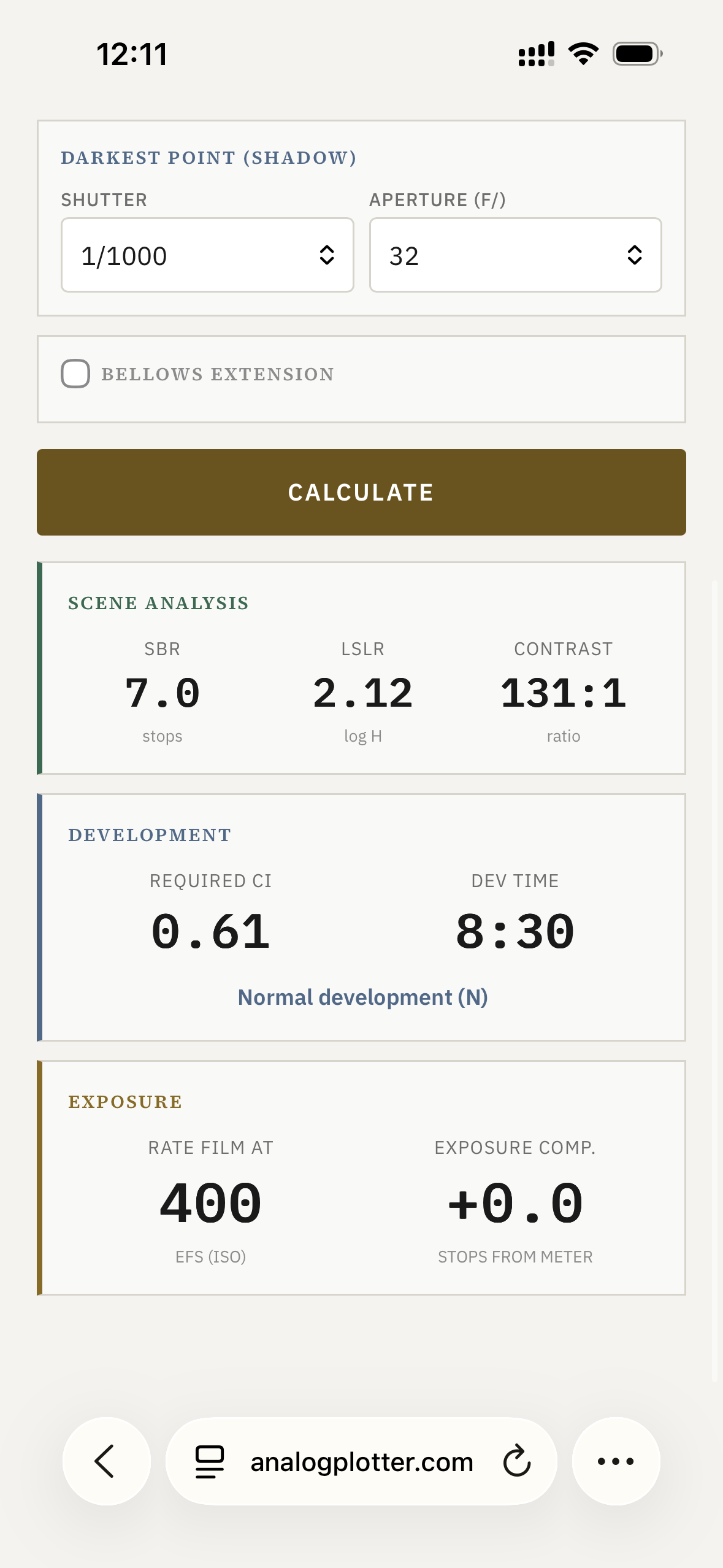

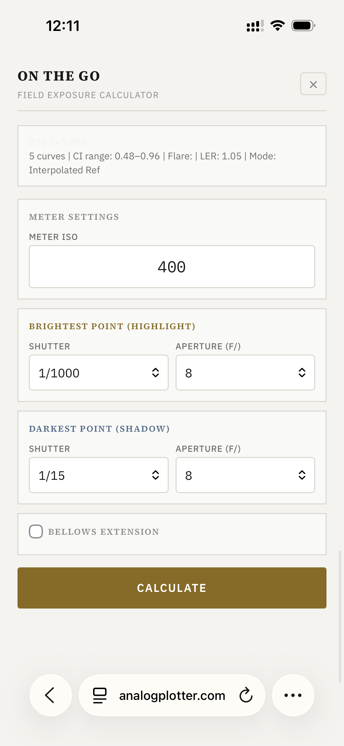

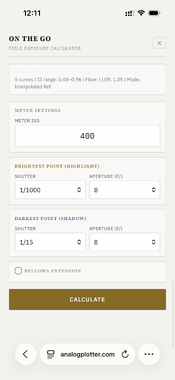

The tool now has a button called "on the go" you can enter this mode after importing a curve set, on your phone. You can enter your meter's ISO and then measure the brightest and darkest scene element. Enter these two into the tool, and it will tell you (based on your data) how to expose and develop. For LF users, there is also a bellows extension feature factored in.

I removed the mobile version again. I didn't like it.

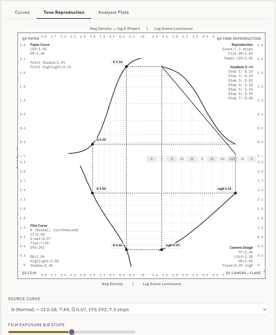

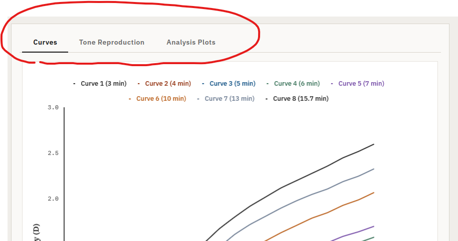

I added a quadrant system
I also added an area where you can interact with the analysis plots
you can cycle through them with the tabs above the curves

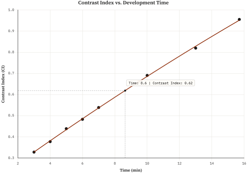

The normal Ui now also shows very sophisticated information, much more than before. The tool automatically interpolates perfect N-Zone curves for you, even if your data set is limited. Do still insert as much data as you can produce, tho.

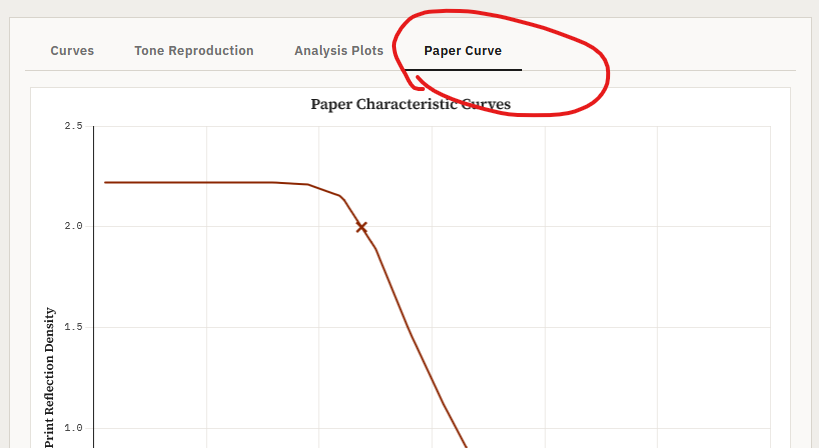

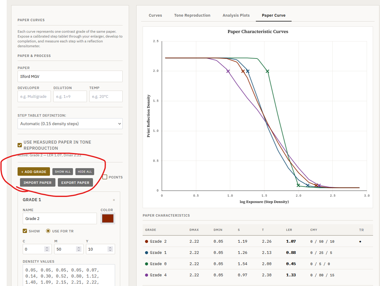

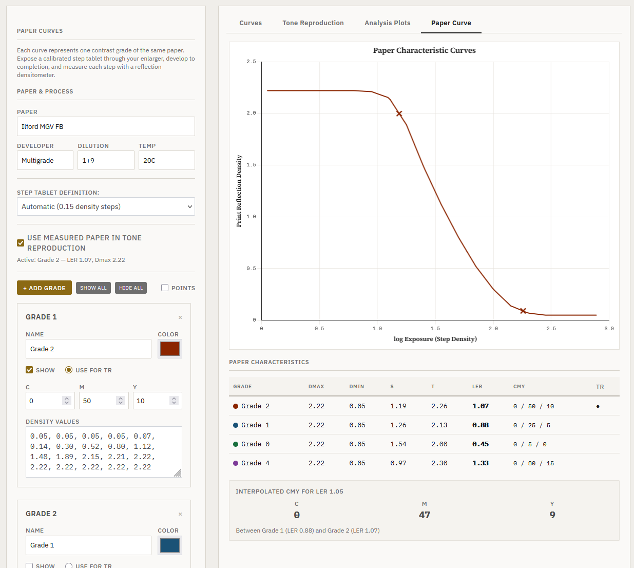

the tool now also features a print curve section as a tab
In this section you can now enter you step tablet vs print density data. You can also select a print curve to use in the quadrant system.
When you enter different curves with different contrast filtration, the program will interpolate exact CMY filter settings that produce the user defined LER.
Let's say you want a LER of 1.05, but only have data that produces LER 1.0, 0.60, 1.35 curves, the software will tell you: you have to filter like this in order to get a LER of 1.05.

When exporting your data the files get named after File document Name (which should be the Film) + Developer you entered
You can now export film curves and Paper curves separately. The Paper curves are named in the same fashion. This allows you to save different film paper profiles and comapre them easily.

I do it like this: I test until I find my first exposure giving me 2-3x B+F density in the beginning of the strip. I do a range of tests afterward like (5 to 18 min dev, same exposure) and this generates enough data for me. I also just switched to a 41-Step tablet with a DMAX of 4.05. Which makes life way better in this regard, but comes along with other issues.
