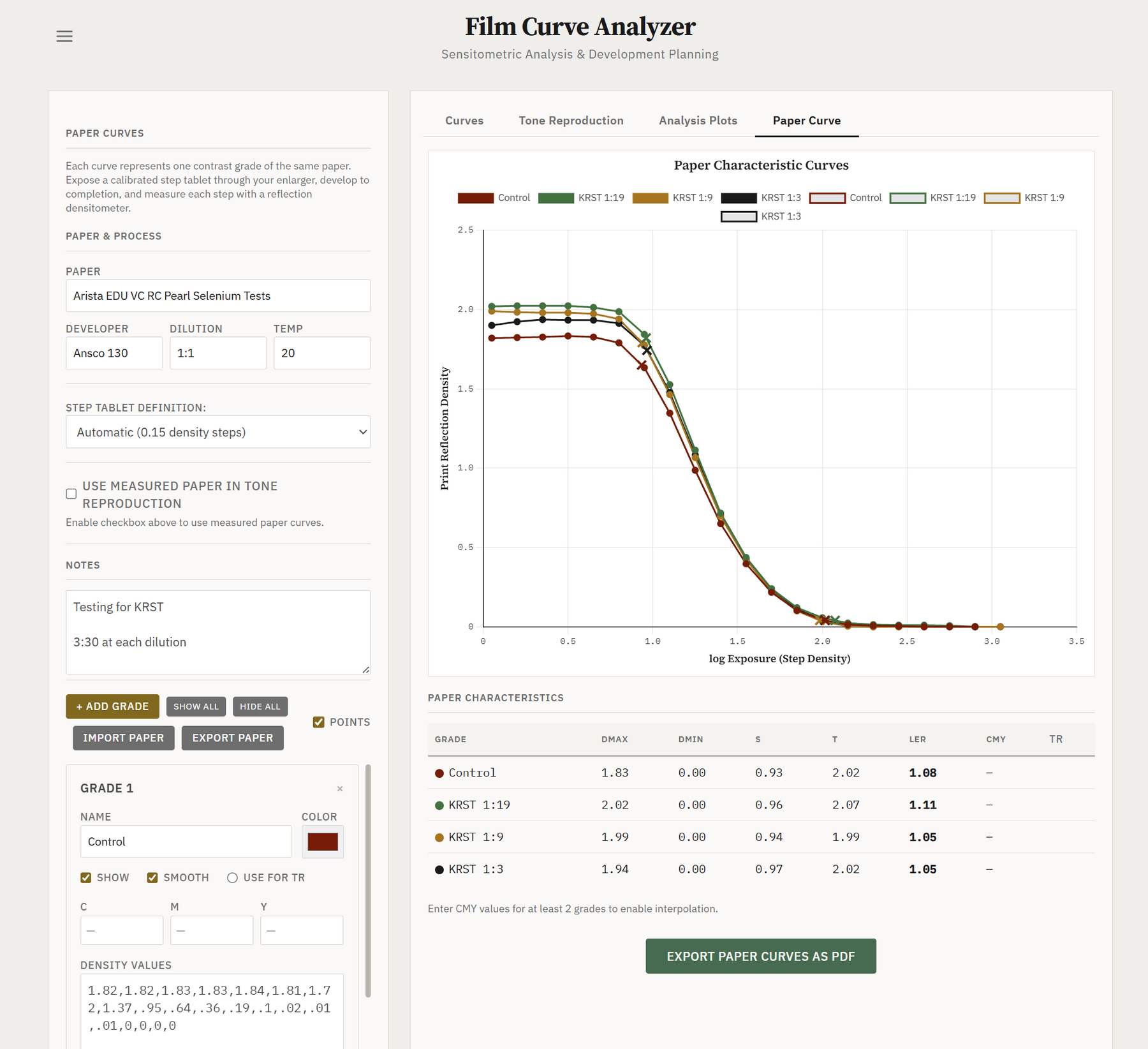

This new feature allows you to anaylze the tone reproduction curve. It shows Avg. Gradient and Avg. Mid-Tone gradient (Zone III to VII). It also overlays a Graph to see local gradient of each point.
All of these updates are incredible. Having an option for paper curves is great.
Three small requests related to the paper curve section:
1. Could you add a "Notes" option? Similar to the option under "Process Description"
2. Could you add the option to export paper curves as a separate PDF? It would be helpful in a reference binder when comparing papers.
3. Could you add a "Smooth" option for the curves?
Thanks again for making all these fantastic additions!
Done
