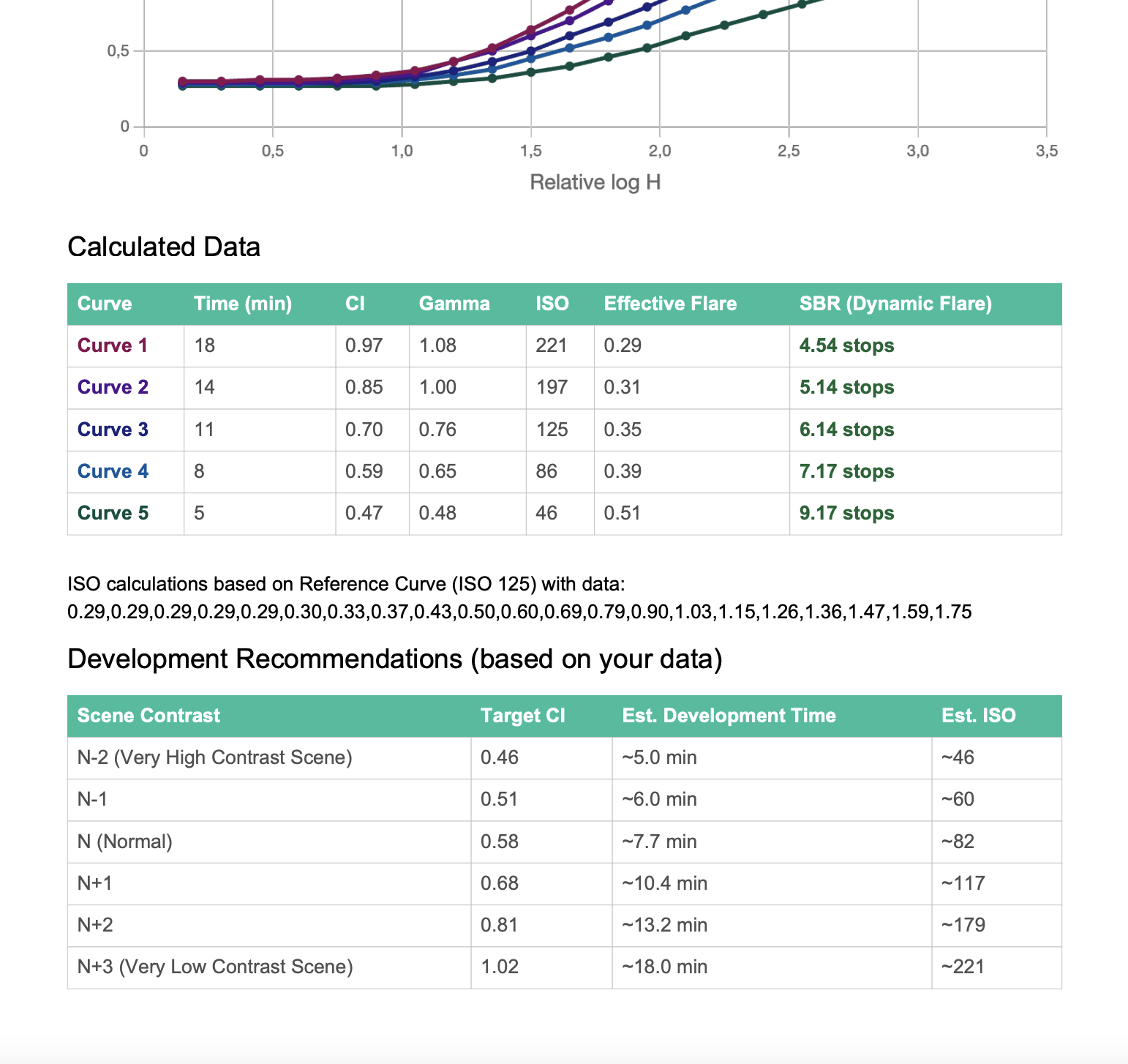

Why not both? A table with a dynamic developmental model that's based on entered variables would be helpful. I believe I saw a CI / Time curve which can also be used to extrapolate development times. You actually need both. The aim CI values are calculated for -1, N, +1, etc, and then the development time is determined using the CI / Time curve.

- I added a full density table to export to the PDF
- I also modified the PDF "Calculated Data" area, it does no longer state the SBR with flat 0.40 flare applied, It's just not useful.

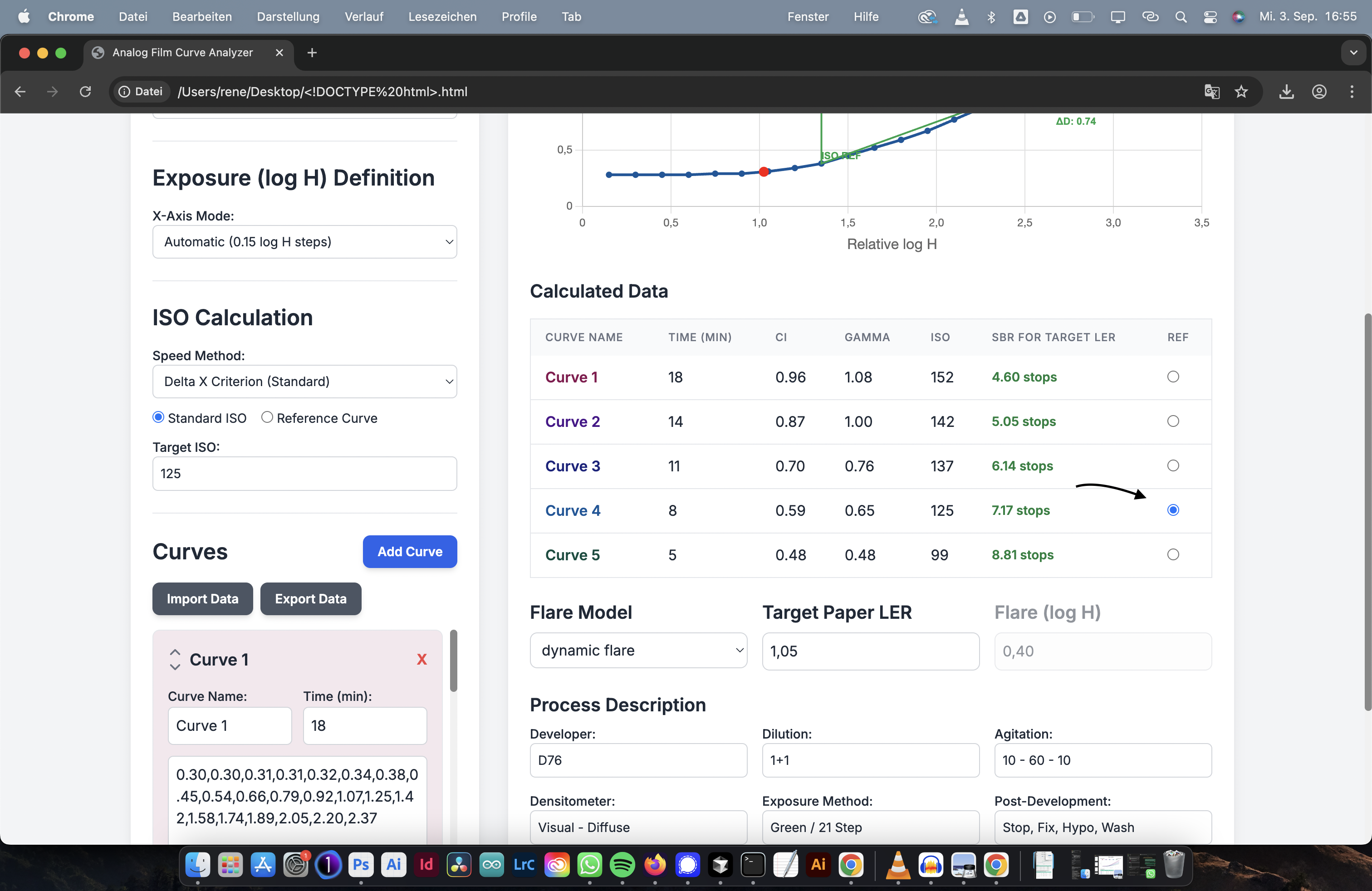

- Now you will have to add a "reference curve" with the button "Add reference curve" There you have to enter the measurements you got when developing the Box speed curve. It will be used to calculate the relative speed of the rest of the curves.

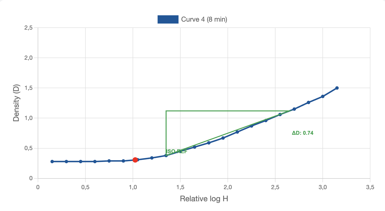

-You can now also tick a box called "Show ISO ref." that if the curve it is used on, is used as a ISO:6 reference, it will draw the standard 1.20 logH time 0.80 DR triangle to show the "match" with the curve
-You can now choose between DeltaX and normal fixed density ISO calculation

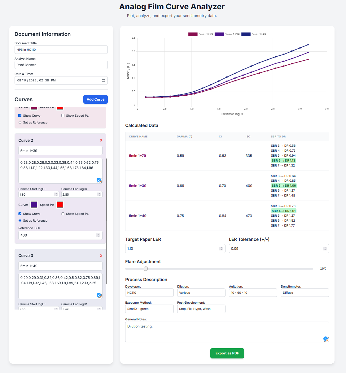

Yesterday, while working on my tonal reproduction tool, I had the idea to make an online plotter for anyone who wants to plot their curves quick and easy. With this free, online tool, you can just input the 21-Step tablet Density measurements you made. The Tool will assume 0,15 log H steps. It is meant to be used with relative testing, this means you don't know the (luxs) exposure intensity that was used to expose the different densities. You can assign one curve (the one you developed for box speed) to your reference and enter the speed. Based on this, my tool will calculate the relative speed for each curve. It also shows the contrast index or gamma of the curve. (Contrast index is similar to gamma but takes another way to calculate curve form). You can also enter ISO R or LER in a field with some tolerances, and my tool will show you what curve to use for which paper. I also included a Flare slider, which will add a haze over the data that is more active in the shadows. (This is done because Camera systems and Optics don't transfer scene illuminances without distorting them.) You can export all your data in a somewhat nice PDF. I am still working actively on my tools, so take everything with a grain of salt.
https://analogworkshops.at/plotter.html
This is the website. Feel free to have fun with it and test it. I would again be very happy with some feedback!

Update:
-The tool will now properly show the ISO reference triangle if the standard ISO mode is selected.
-The user can also change the reference manually for what ever reason they might like.
-Delta D will be shown in order to adjust for development if needed. This will also be properly referenced in the exported datasheet.
