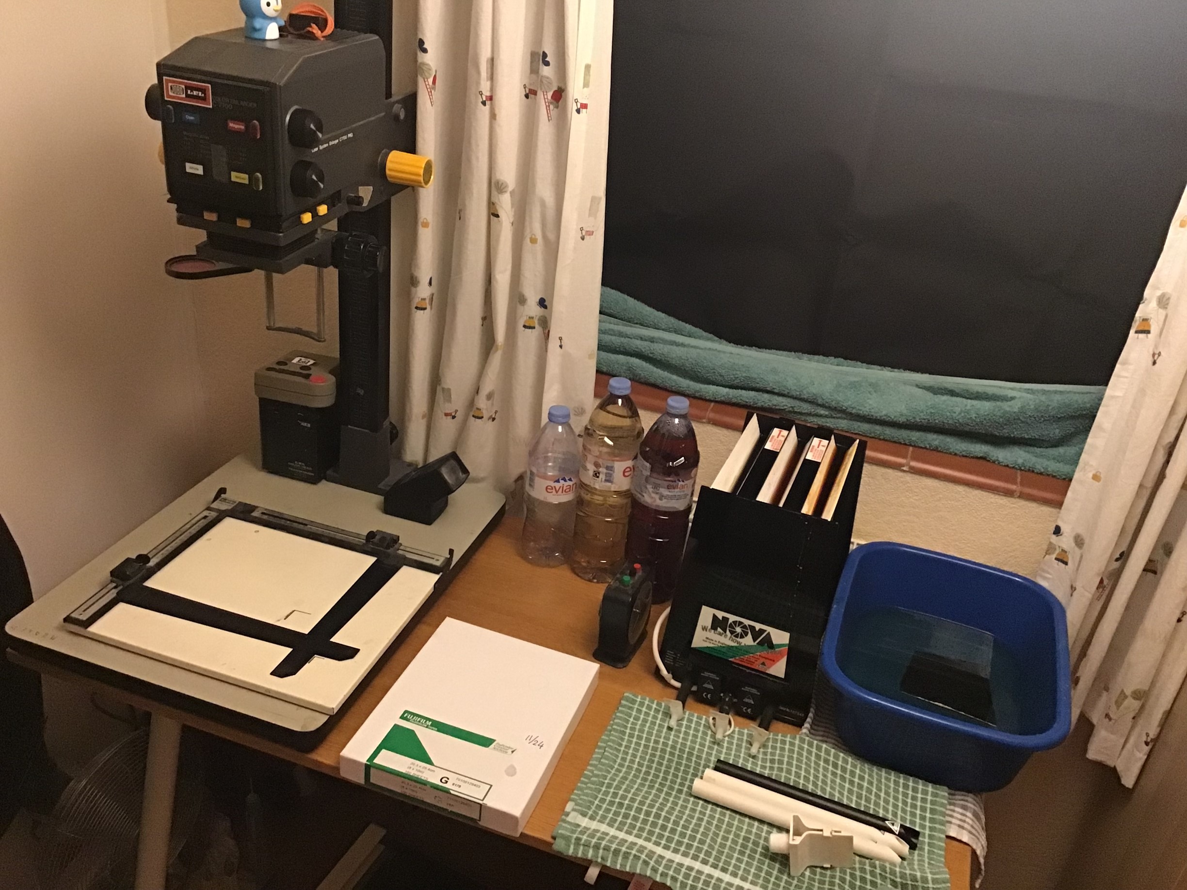

I got some prints, quite hard work some of those negatives. It's too dark now so will show you all in the morning.
Tomorrow I'm going to continue making my life hard by trying to print some unmasked Agfa CN17 and Ilfocolor
My setup:

Cool project! And your setup is very nice and compact, amazing! How do you like the Nova for processing prints? I've never used one, but it seems quite efficient and practical.
perkeleellinen
Apr 14, 2008
2,906
Warwickshire
It's no exaggeration to say that the Nova is the reason I can continue to print. That setup is in my son's bedroom which he is 'hiring out' to me at £20 per day! I've always had temporary or tiny darkrooms and the Nova makes it work. I can leave the chemistry in overnight which speeds things up and reduces the smell considerably. When I've finshed for the day I put the lids on the Nova and ventilate the room.
That's a small 10x8 heated trimate, I used to have a quad with four slots - the extra was good as a water bath before the print goes in the bowl. I've also got a much larger 11x14 quad but that needs repair to the taps (I live 5 minutes' drive from Nova Darkroom so will drive it there). I'm using the Adox RA4 kit which is great.

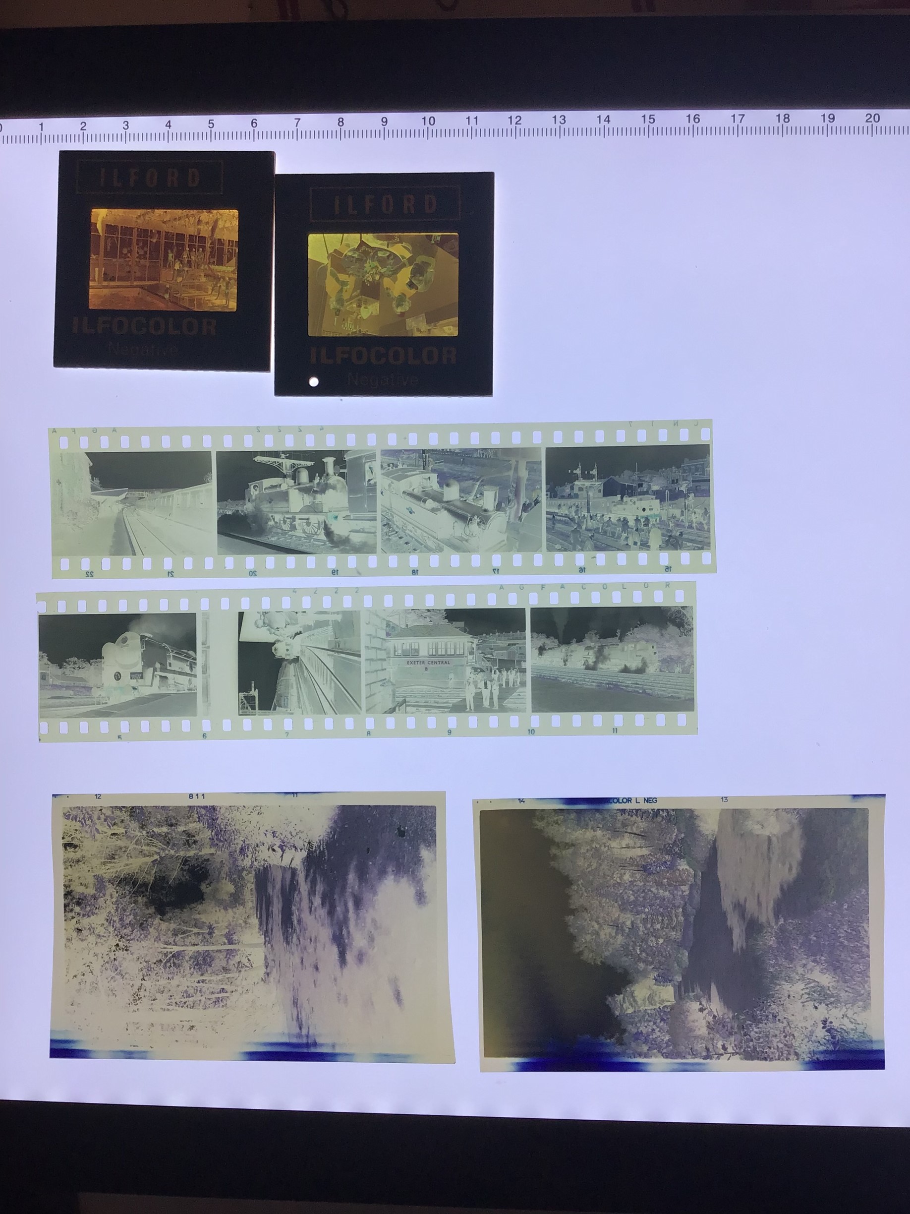

My setup:
When I used to make prints from Agfa CN17 unmasked negatives (in my minilab a few years ago) I would put a clear piece of processed C41 negative (just the orange mask part) between the light source and the negative. It made the negative "look" like it had an orange mask and it would scan with very little correction on a Frontier scanner.
I know you are making optical prints but the same principle, in an enlarger, may help.
Alternatively, as Gregory Davis suggested, you can use a combination of color-compensating filters: R-30, Y-35.
Thanks for the tip, I had thought about this but it turned out that the unmasked negs were not that hard to print compared to the faded Kodak negs from the late '60s.
Had hoped to share prints but again it's so gloomy here that it's already too dark at 2:30pm!
Yes, it does; it makes printing easier since filtration will be in / around a more familiar area. It works without the extra bit of masking film as well, but you need to really crank up M & Y to get where you need to be.
I understand that some enlargers came with an in-built orange filter, perhaps for this reason?
