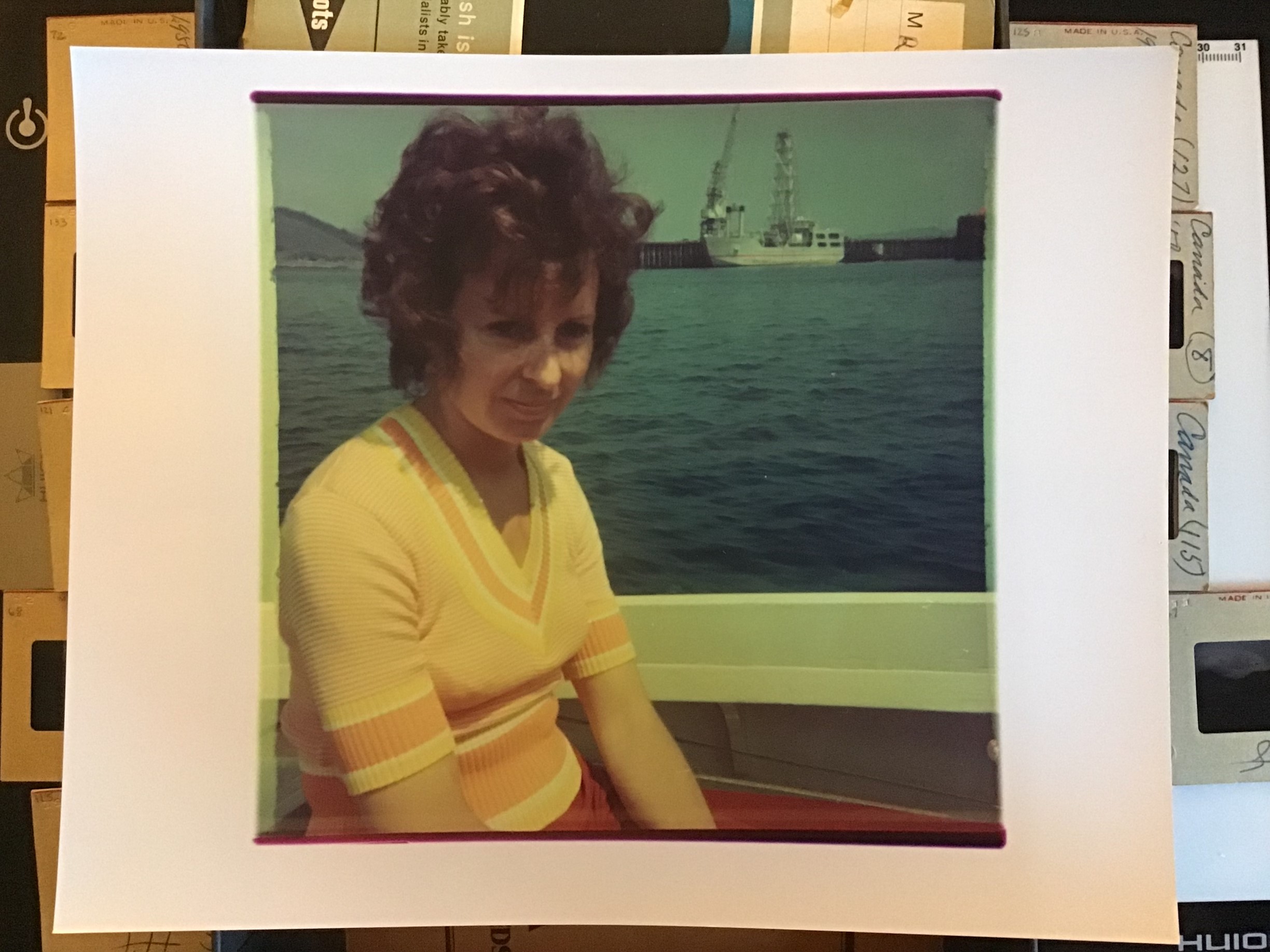

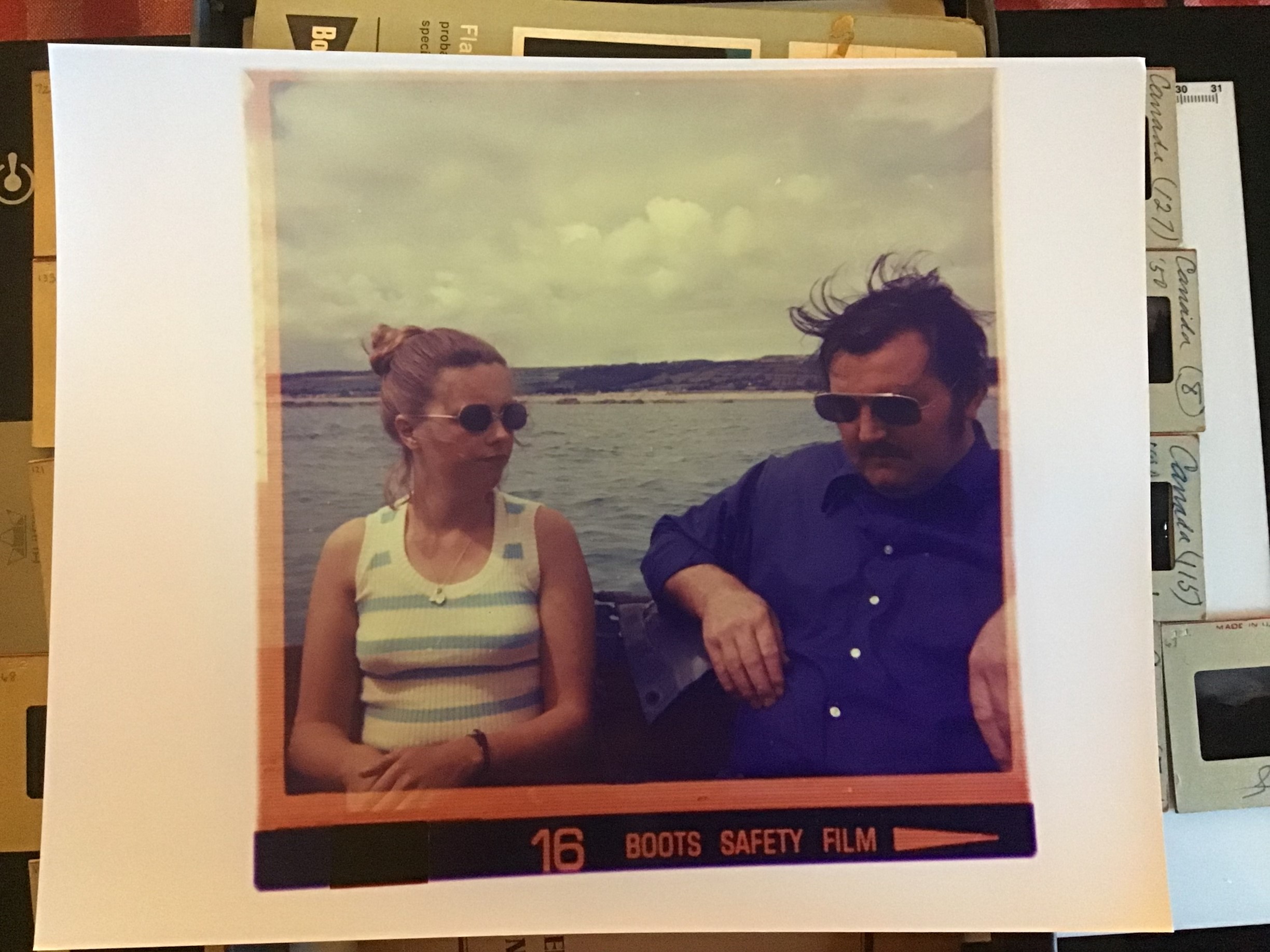

Some prints. Firstly two which were very hard to colour balance - the purple Kodak neg and the Boots Safety Film neg. Both of these took ages and the final result is only 'acceptable'. The main difficulty in both of these was that by removing one cast I would introduce another and there seemed no middle ground. I both cases I decided a warm yellow cast was better than a green one.
The purple Kodak neg, my Aunt, probably late 1960s:
This is her husband, my Uncle around the same time:
Sorry about the lighting on these, a reading lamp, it's so gloomy here I can't get natural light indoors. But you can still see the warm cast I decided was better than a green one. Both of these took twelve (12!) test prints, that made me question my skills!!

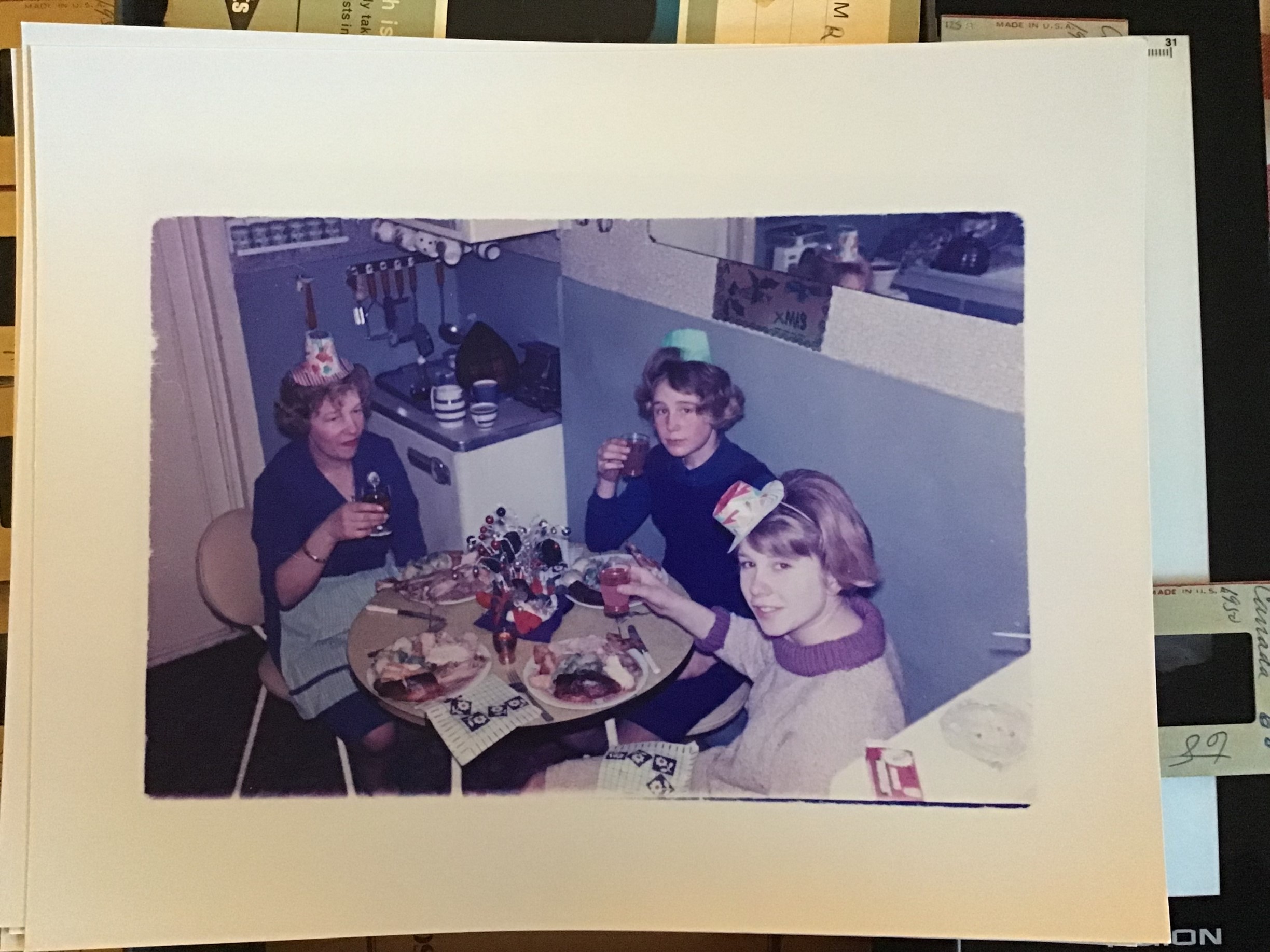

More interesting, here are two unmasked Ilfocolor negatives from probably the late 1950s. Again hard to colour balance. The first was lit with a Philips Photoflux (you can see the box bottom right) which has produced a very cool colour on an austere Christmas day meal.

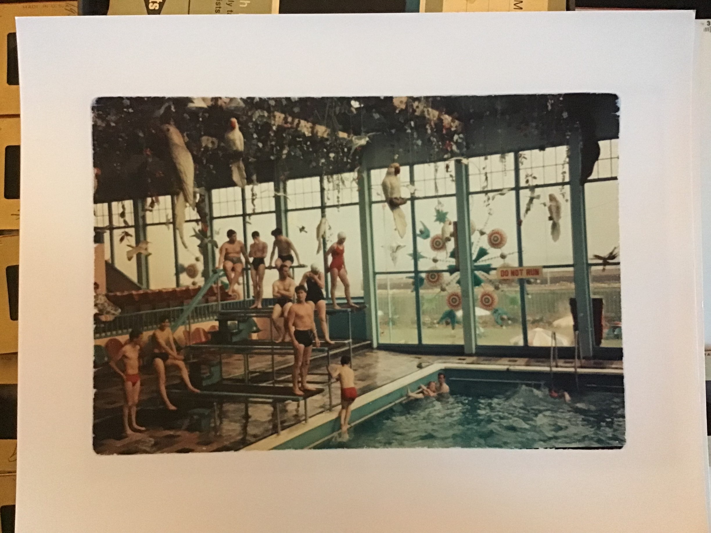

And here is a very interesting scene which was surprisingly easier to balance:
Interesting film, displays a bit of grain at this size but oddly not much detail when you look close. Again, crappy reading light casts over the prints.

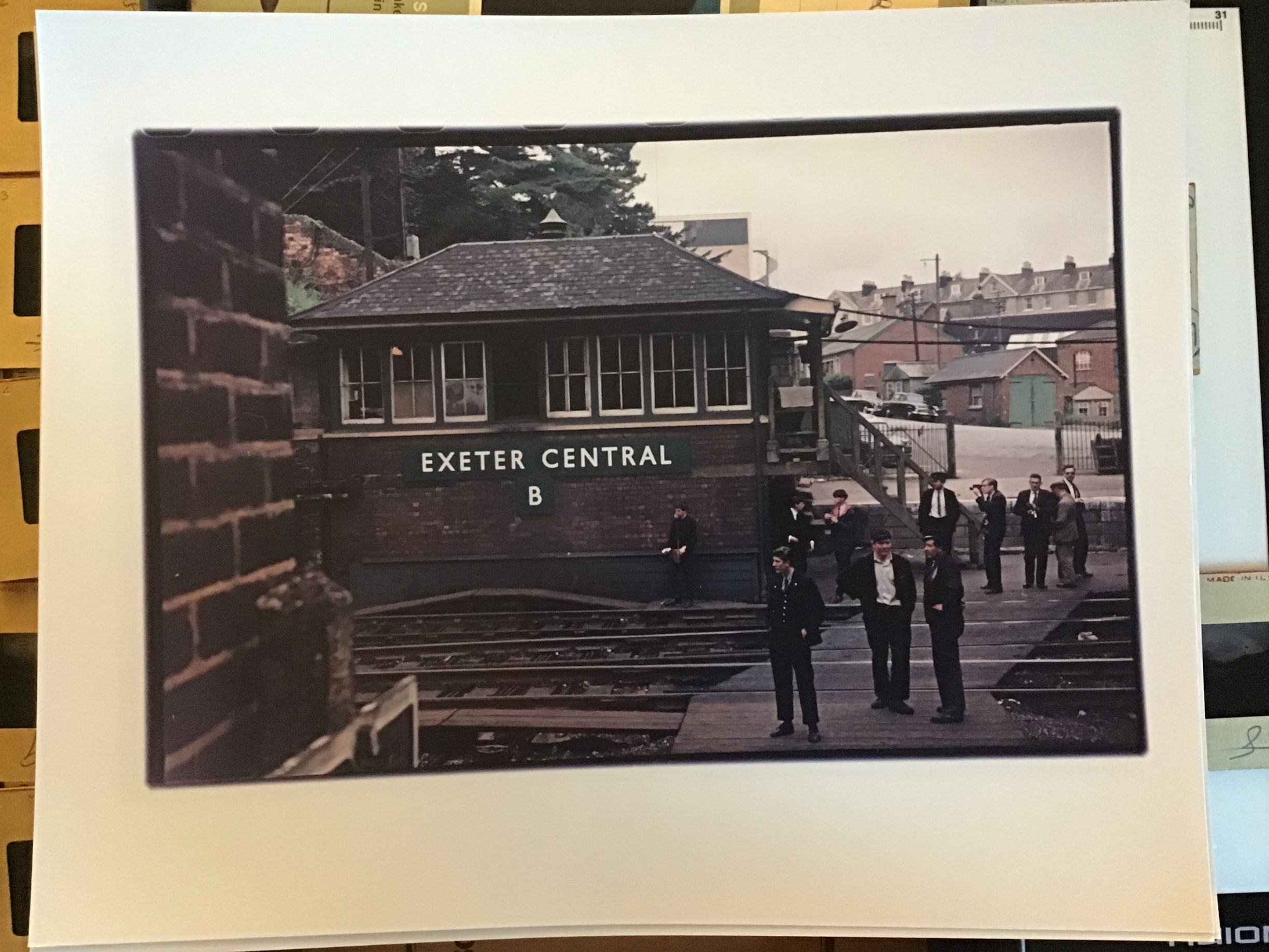

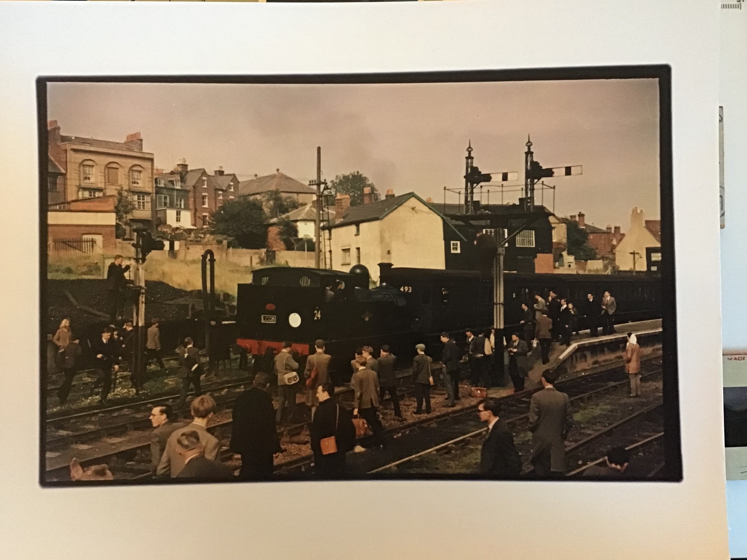

Lastly, two unmasked Agfa CN17 negs. These were easier to balance but hard to fine tune, I kept going between browny skies and purple skies.
The negative sleeve has written on it 'Ilfracombe 12-9-65'. Could we be looking at the last days of steam with those enthusiasts out to document a final service? One chap seems to be recording sound.
