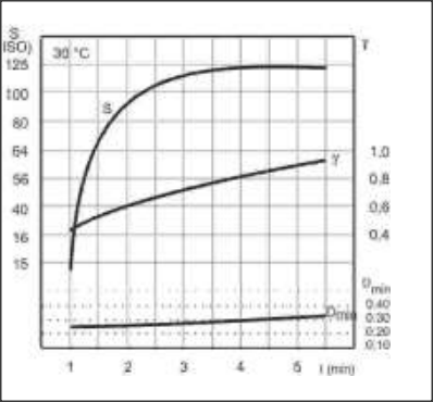

I believe Foma uses gamma (γ). A film with a γ = 0.67 - 0.71 range is approximately the same as a CI = 0.56 - 0.58 range. It's normal. Gamma uses a different method to read the curve.

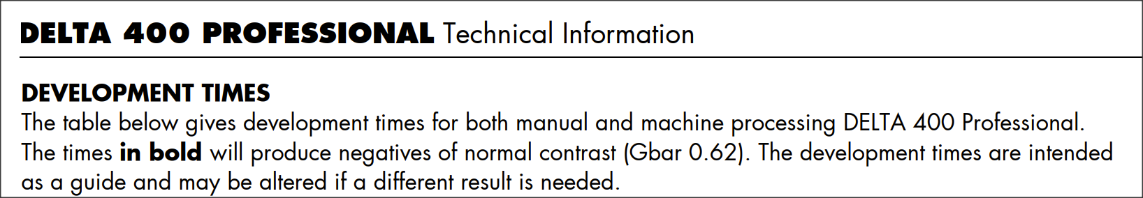

Stephen where does Ilford's Gbar of 0.62 fit into this scheme of contrast measurement ? Thanks

It's funny, I'm working on a post about average gradient. I don't remember Ilford having a target of 0.62 for normal but they adopted a run of 1.50 like Jones' fractional gradient method. I've often wonder why Ilford didn't update with the general use of coated lenses. Depending on curve shape, mostly long toed curves, G-bar will return a different number than Kodak's CI.
Just checked a couple of Ilford's datasheets and they don't list contrast aims or even a Time / contrast curve but they do seem to have a standardized statement of "These times will produce negatives of average contrast suitable for printing in all enlargers. The development times are intended as a guide and may be altered if a different result is needed." So it looks like they are protected from lawsuits.

Did another search. It does appear that they use a G-bar of 0.62 in some of their data sheets. Delta's curve looks average so it should about equal the same as CI. My first thought is they are keeping to the ISO speed standard for some reasoning. Problem is the ISO speed standard isn't about defining a normal contrast. Interesting.
G-bar 0.62 is almost certainly an internal decision of Ilford's and not a product of the methodology. A possible reason why Ilford's aim G-bar for normal is 0.62 could be based on their aim LER of 1.10 for many of their grade 2 papers. Kodak uses 1.05 for their aim LER grade 2.

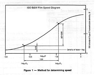

That is sort of true; however, I was referring to what Ilford considers the aim for normal with G-bar. The ISO speed standard has a contrast parameter that must be met before determining the film speed. Some people erroneously consider that to be the standard for normal contrast. The parameters equal a slope of ~ 0.62.
