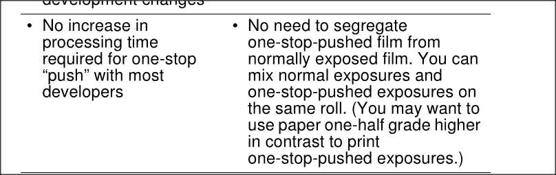

Kodak suddenly recommended not extending development for a one-stop push, some years ago.
For everything, or only specific films?
I have the 1988 Kodak Technical Information book and they have said that about TMax since they introduced the films. I wouldn't exactly call 34 years ago "suddenly". The ability to give a one stop push and not need to segregate the normal and pushed films in development was a big selling feature at the time.
But they don't recommend it for TMax films only...
Also for Tri-X.
Well, thanks, Craig...
Now I understand it more clearly. It started with the introduction of TMax films, and it was done with sales on mind, trying to make look TMax films better than other films. Then they extended it to Tri-X.

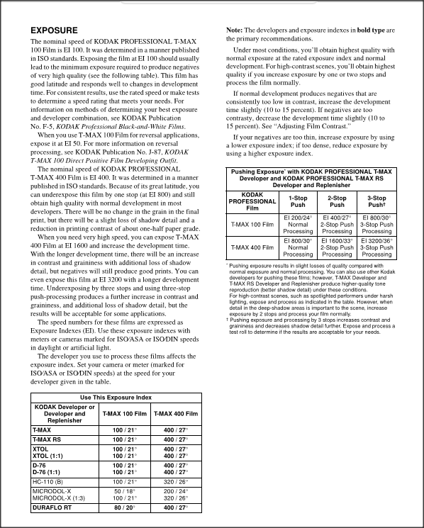

Kodak's published characteristic curves suggest that "normal" developing times are already a push over what would usually be considered a normal contrast target. I'd consider the normal published times to be a 2/3 stop push process.
Found this in Kodak's "Kodak Professional T-Max Films" - January 2002 - F-4016
From the publication, "Because of the great latitude, you can underexpose this film by one stop (at EI 800) and still obtain high quality with normal development in most developers. There will be no change in the grain in the final print, but there will be a slight loss of shadow detail and a reduction in printing contrast of about one-half paper grade."
It's basically an opinion, with caveats, in a publication by a marketing department. The facts aren't wrong. Whether or not it's desirable is another topic. In addition, the degree of tolerable underexposure has a lot to do with the subject Luminance range and where the darker values fall. Not every scene has deep shadows that will be lost with underexposure.
