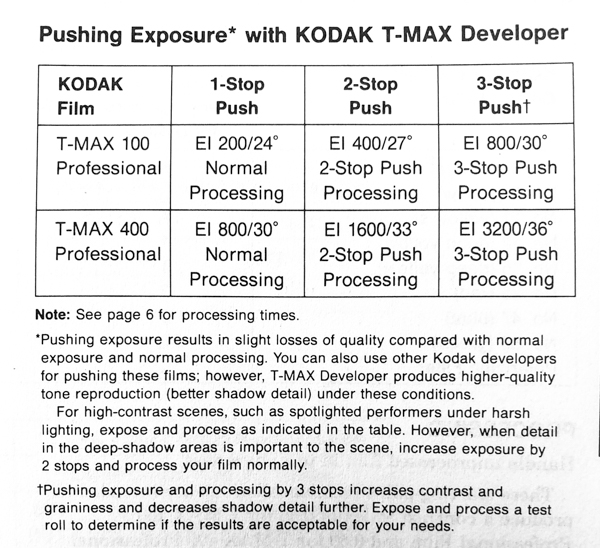

I was looking at T Max 100 curves, Tmax developer @24°C, publication F32, 1988. They specify the normal developing time is 6.5 min.
The curves show lines at 5, 7, 9, and 11 min, so I interpolated a bit to read a 6.5min time. Doing basic rise over run on the graph, the best I can read it is over a difference of log exposure of 2 (reading from -2 to 0) I get a density rise in that range of 0.3 to 1.9. Doing the math, that gives (1.9-0.3)/(2) which gives a slope of 0.8. Roughly extrapolating the graph back to a 0.58 slope should give a "normal" devloping time of 5 min. I'm also extrapolating that the difference from 5 min to 6.5 min equates to approximately a 2/3 stop push. I realize there is a lot of estimates and approximation here, it's a back of the envelope exercise.

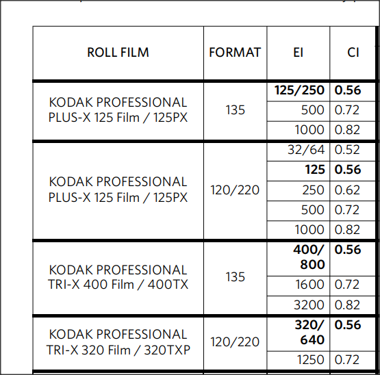

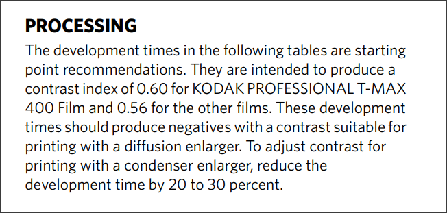

I couldn't find a copy of F32 1988, but I did find F4016 2018. It didn't specify a Contrast Index value for normal; however, the publication for T-Max Developers J86 did.
The publication for Xtol J109 2018 contained even more information.

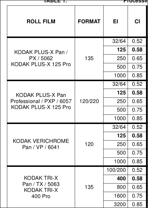

What I find interesting is their normal was 0.58 when Dick Dickerson ran the department. Looks like they went back to 0.56 except for films by other manufacturers. Have they fallen so far that they didn't want to retest non Kodak films and just kept the old CI targets the same?
From J109 2000 version:
They also seem to be able to center the values in the cells better in the earlier version.

There is also a footnote in the Pushing Exposure section of F32 that says (in part): "Pushing exposure results in a slight loss of quality compared with normal exposure and normal processing. You can also use other Kodak developers for pushing these films; however, T Max Developer produces higher quality tone reproduction (better shadow detail) under these conditions."
F32 does specify a CI for T Max 100 of 0.56, and 0.60 for T Max 400.

If I'm reading the text in the data sheet correctly, Kodak is only referring to TMY 400 for the development exception. This makes some sense as the effects of exposure is smaller with long toed curves. Plus they are also suggesting processing to a higher contrast for normal to begin with. What is throwing me, unless I'm mistaken, is that the tables in the data sheet include TMX 100 as a film not to adjust development for a one stop underexposure even though the text suggests otherwise. TMX has a very short toe and exposure changes will me more noticeable.
Originally the recommendations included TMX.

I had a close look, and there is the push processing chart I included above, plus tables for small tank and rotary push processing that include both 100 and 400 films. The text mentions that TMY can be exposed at 800 with normal development, but the text is silent on push exposure with TMX.
I think the key to this recommendation is the use of T-Max developer. They show a graph of developing time vs contrast for a number of developers. All the other Kodak developers have mostly parallel lines, but the T-Max developer line is much steeper, indicating that it builds contrast much faster than other developers.
