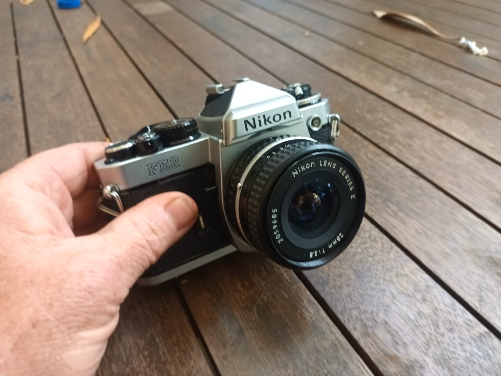

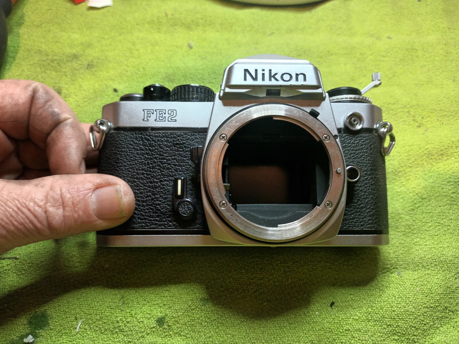

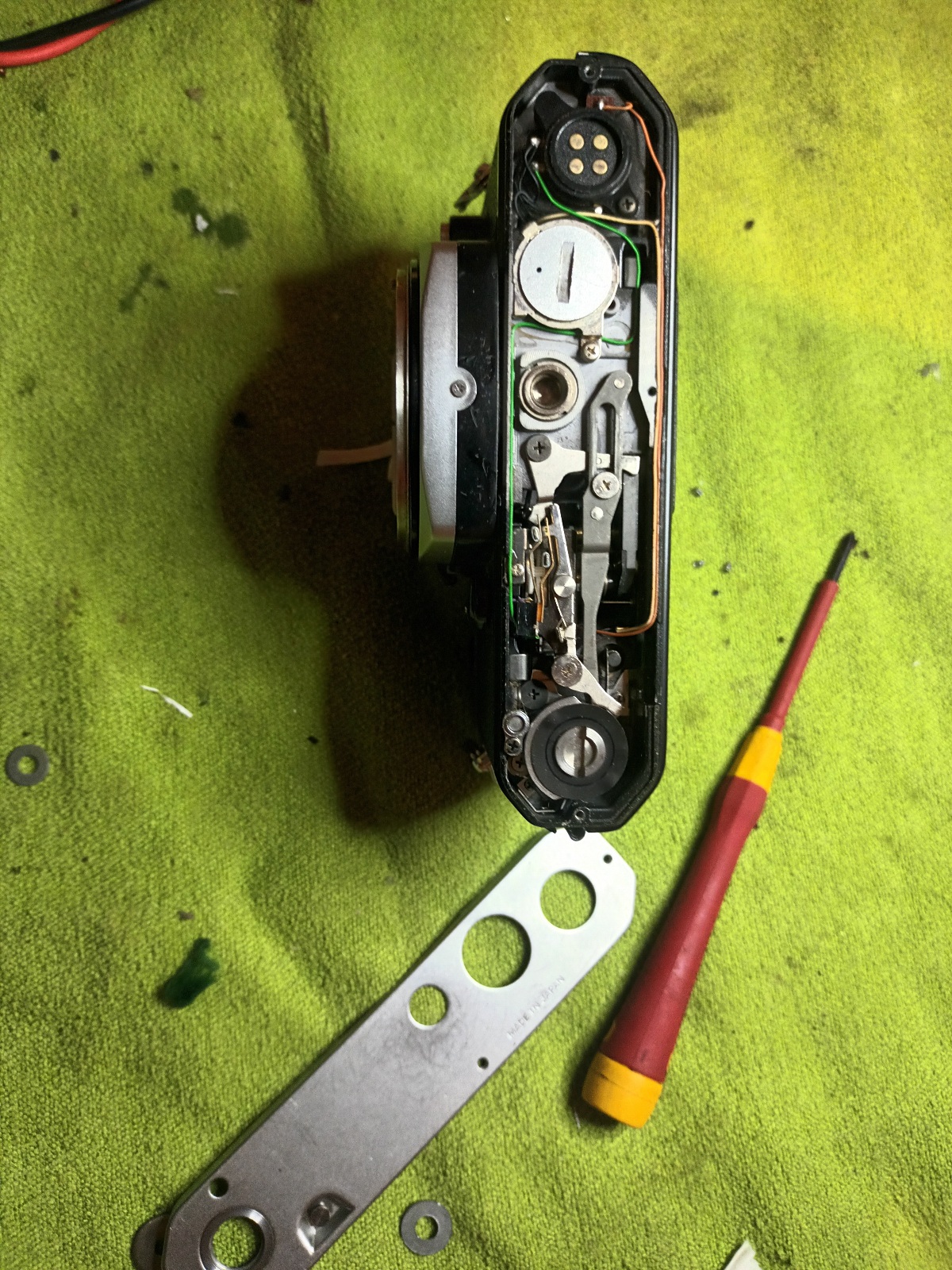

I bought a non functioning fe2 which turned up yesterday.
The mirror was locked up, meter was dead, timer wouldnt work, shutter wouldn't fire and film advance was locked.
Took the bottom plate off and could wind on when pulling the latch back, but still wouldn't fire and mirror would only go down manually. Eventually with a bit of lube I could get it to fire sporadically in bulb, bit more lube and actuation I could get it working in m250 and bulb, replaced the batteries, put the back back on and meter was working.
A aperture priority would only fire at one speed. Bit more playing with and it started working again.
Put back together and all is good. Only took the back door off and bottom plate off sprayed a small amount of lite lube a clean and did a few hundred actuations and it is working.
Also cleaned out some fungus in the e 28mm it came with.
Job well done!
Thanks for that, I enjoy a successful DIY story. Taking off the bottom plate of a Nikon of that era reveals a wealth of levers and cams all of which can gum up over the years often making a repair fairly easy, but it's still empowering to fix a dead camera even if it was just a lube job.
You fix some and some end up in a mess in a snap lock bag.
The FE2 is nicely built and this one probably had just been sitting in a camera bag since last century. Just needed to be coaxed back to life.
