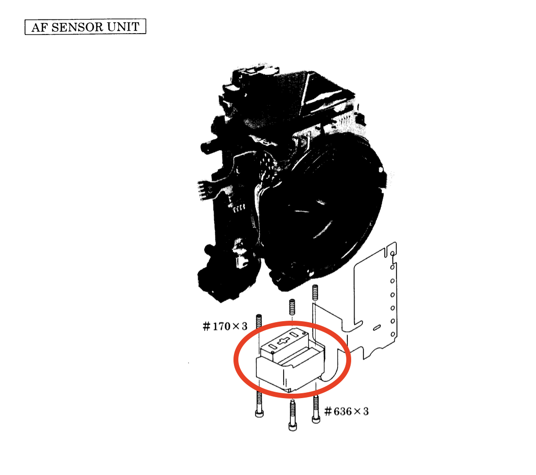

I have repaired a few F55 (N55) but have never repaired that issue. I don't think the AF issue is solved without a new AF module. Just last week I was re-flowing the solder joints to the AF module on an N55 without success.

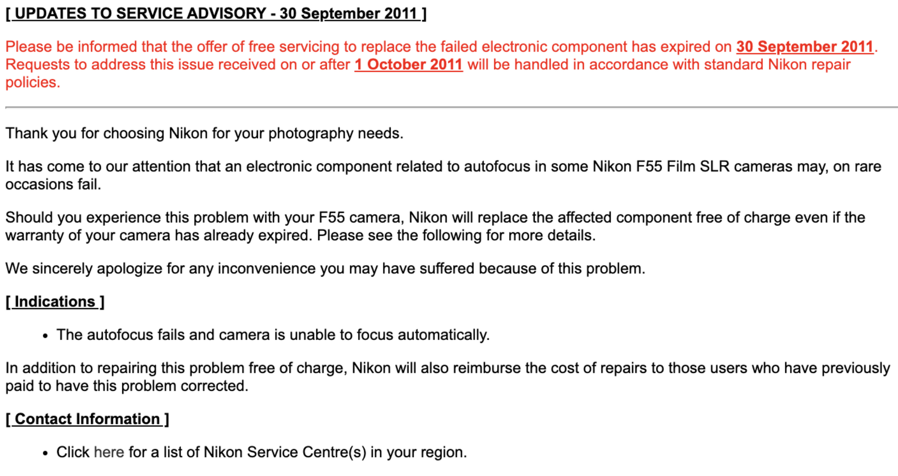

Of course the service campaign from Nikon is long gone...
