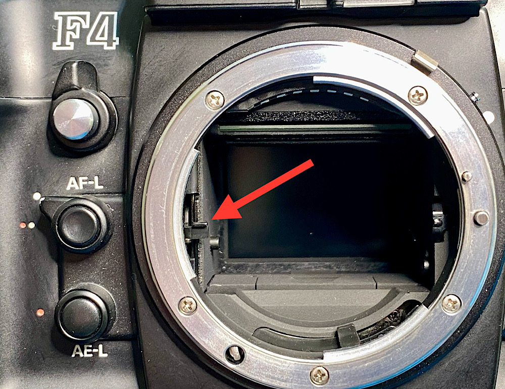

The candidate, a Nikon F4 on the battery compartment MB-23, which turns the F4 into a Nikon F4E:
The external condition of the camera is good, all functions work properly.
The aperture lever in the mirror box when the shutter is released only goes down a short distance and does this rather slowly:
  • Red arrow: actual position of the aperture lever
  • Green arrow: target position
As a result, apertures on the lens no longer close correctly above f = 8. Pressing the aperture button produces the typical screeching noise.

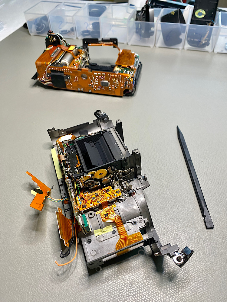

March 26, 16:00 CET, Vienna
The eagle has landed 🌔
Above is the rear part of the F4 with the shutter, below is the front part with the mirror box:

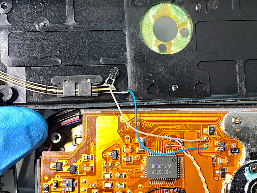

Along the way there were complications with three glued screws that I couldn't remove. I had to mill out the screw heads with the tungsten carbide cutter on the Dremel. Thankfully I have orginal replacements for all three.
I hope that my grounding worked and that there is no damage to the electronics due to electrostatic discharge.
I also pressed twice accidentally on a flexible conductor while working and damaged a soldering point when milling out a screw.
But no serious damage should have been done. I checked the spots with a magnifying glass.
The day's goal has been achieved.

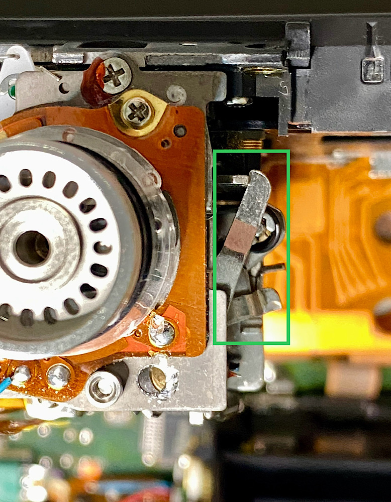

Now I'll take a closer look at the problem area:
The red arrow points to the lever that tensions the mirror, the green arrow to the lever that releases the mirror.
The aperture mechanism underneath is activated by the mirror.

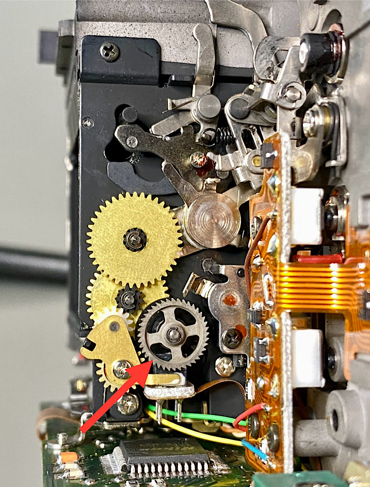

The screeching noise when you press the stop down lever is caused by this ratchet gear:

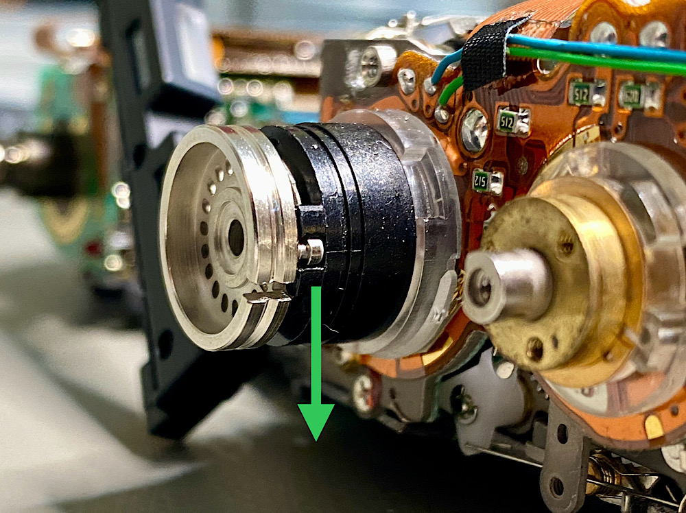

The ratchet gear is coupled to a perforated disk behind it (red arrow). This disk runs through a photointerrupter underneath (blue arrow) generating electronic pulses that are sent as signals to the control electronics of the F4:
The ratchet gear should run quickly and freely when the mirror folds up.
Here it runs sluggishly, as do the gears it is connected to.
I will clean the mechanism with benzine and then oil the axes of the ratchet gear and the gears sparingly and move the mechanism through.
After several times putting benzine into the mechanism, moving it around and drying it with the bellows, the gears run more easily, but still not completely freely.
The screeching noise when pressing the stop down lever, which was no longer audible during the benzine bath, is also back.
After I put a drop of Nyoil on the axle of the ratchet gear, the screeching suddenly disappeared. So there was a lack of lubrication here.
The axles of the other gears also get oil.
Now the mechanism runs easily and freely 🙂

The soldering point should not be affected by the damage. Anyway I won't know until after assembly.
