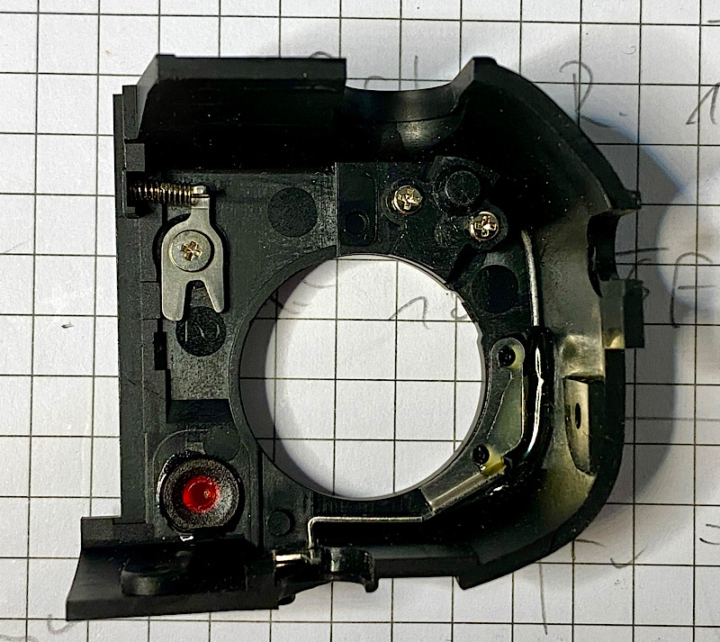

Do you have the picture of the underside of this cover? I am curious to see how the VF release lever is attached to the cover and the connection to the release mechanism on the chassis.
