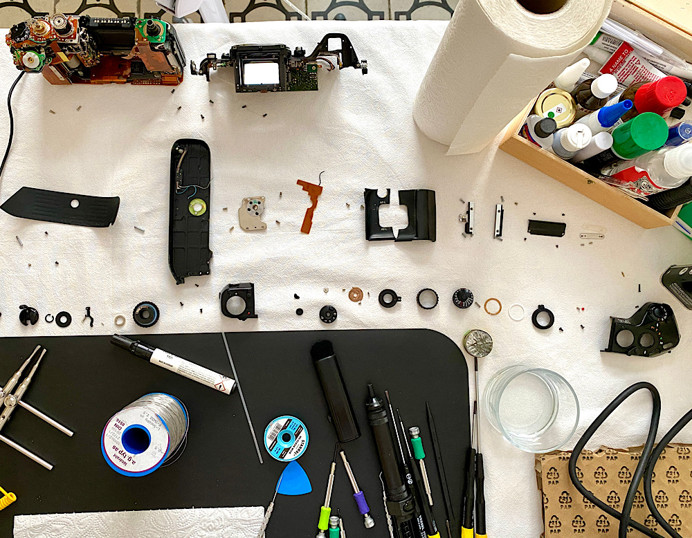

Disassembly, removal of the mirror box
In order to get to the point where the problem with the gummed mechanics is located, the mirror box must be removed. On the F4 this is the front part of the camera.
I followed the tutorial from @F4user, which shows all the necessary steps:
I'm just showing a few impressions or giving hints here.

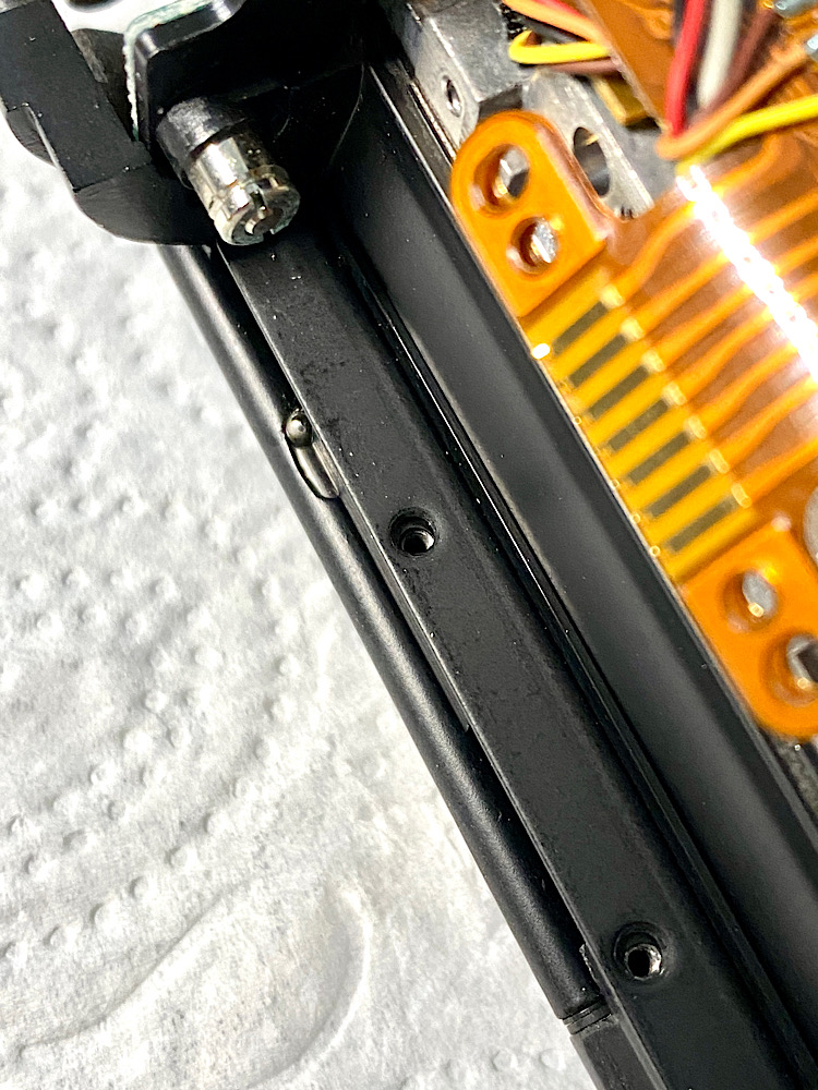

To get to this screw, the red rubber marking dot must be levered out. It's also glued on.
I don't want to use isopropyl alcohol as a solvent here because the cover is made of plastic.
The base plate is screwed on and also glued to the plate for the tripod screw.

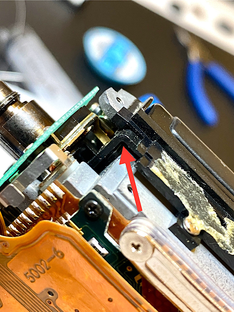

The problem area and search for a solution without having to dismantle the F4

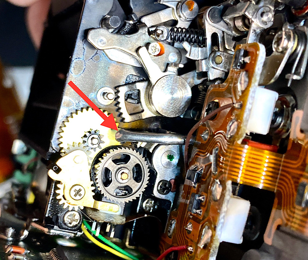

And here, on the right side of the mirror box, is the problem area in the aperture mechanics that inhibits the aperture lever in the mirror box.
@F4user instructs that a gear and a cover must be removed to clean the area.
The arrow points to the place where the gear, secured with a circlip, sat. The cover has already been removed underneath.
A spring runs off and moves the remaining gears when removing the gear mentioned. It was then no longer clear to me how to get tension on the spring again.
The darker gear in the middle cycles rapidly when the mirror is triggered or the aperture lever in the mirror box is moved.
On this F4, the aperture lever worked, but the mechanics were already a bit sluggish and the gear only turned slowly. I couldn't see any gumming or traces of lubrication and drizzled the area with benzine. Then everything ran quickly and easily.
I will observe whether the mechanics continue to run smoothly after this treatment.

Here you can see all disassembled parts. These are not a few:

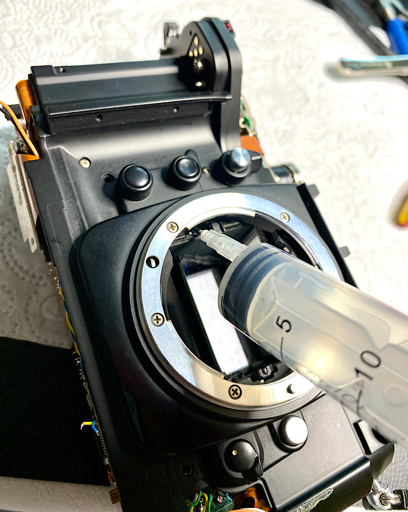

Troubleshooting without disassembly of the F4?
My first attempt to solve the problem on another F4 with the aperture lever being stiff was to apply a mixture of Zippo and graphite behind the lever with a pipette. I only knew roughly where the problem was.
But now I see the area and can think about how I can insert benzine (Zippo should work too) precisely.
This can be done with the cannula of a syringe:
However, I can't get to the spot with a straight cannula when the mirror box is installed. So I have to bend the cannula to fit:
Using the Dremel and a corundum grinding stone, I grind the sharp tip of the cannula round to avoid damaging the camera when using it:
This allows me to reach the spot in the mirror box:
Here is a view of the removed mechanics. The tip of the cannula reaches exactly the spot:
The cannula must be inserted at an angle from above, with the camera standing upright. Then the benzine is distributed over the area from top to bottom:
That should work.
I just need to practically test it on an F4 with the aperture problem. Provided that the removed aperture mechanism, which has already been treated with benzine, continues to run freely.
Now I'll let the project rest and think about everything again.

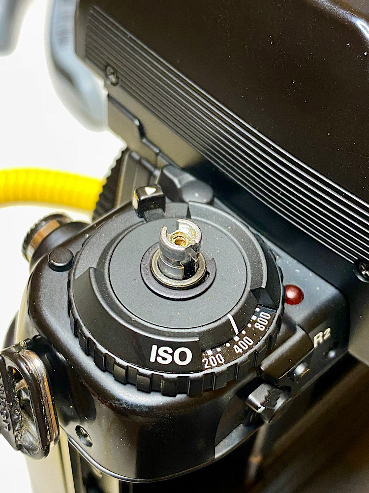

When you removed the rewind crank did you see the clutch in the rewind crank? I think mine is slipping so although I hear the motor run it doesn't rewind with power.
Hey all, I've been lurking on this and the other thread, and I thought I'd chime in. I did this fix a few years ago on a number of old F4's that were heavily used, at least 3-4 bodies, some minor some more serious of a slow down of the lever. All of the bodies were super well used after thousands of rolls doing weddings and while basically in good nick the slow lever action would make inconsistencies and I had really nothing to lose. I did a number of attempts, with CRC electrical cleaner first with operating the camera while spraying thru a long thin straw to try to target the 'joint' where that lever pivots, if you can see the part on an exploded F4 diagram you'll see what I was aiming at. After a good amount of spray/shutter cycle I switched to a more precise method of tracing the lever down with a thin wire and then dripping small drops of lighter fluid (Naphtha) and then cycling the camera plenty of times, doing this a couple of times finishing with lots of spray air targeted to dry the area. When things felt smoother, less sticky, I followed up with the same method of dripping tiny drops along a wire, but with this last one with CRC greaseless lubricant, not much. My theory was from the first cleaning as a general clean for the area, then the Naphtha as a more targeted clean, and then a tiny amount of lubricant. I think, (its been more than a few years, at least 5-6) I stopped doing the first spray after the first one and just did small amounts of Naphtha to clean, cycle until things seem better, then spray air to clean. I'd let the camera sit for a day or more then check the aperture lever operation with known test lens, if there was any slowness on *the first* cycle then I'd repeat the whole process. If and when a camera would pass that test I'd let it set a week and test. I think most of the bodies needed at least 2-3 attempts, and I would test them with film by putting the camera on A and shooting a sequence while moving the aperture ring from wide open to full stopped down. If there was any and I mean any residual lag the negatives would show over exposure, a correctly working lever would give perfectly even negatives which would be obvious when the negs were put on a light table.
As it was/is, I managed to revive those bodies and I passed one or two bodies off to friends/family and kept two or three, I lost those and several newer F4's (and a whole lot of other stuff) in the Lahaina wildfires, but I did save one F4 with MB-20 that I used to photograph the fire and its aftermath. That F4 was one of those that I did the revive on, and its been a regular shooter for me with no exposure errors, but I do try to shoot a roll a month with it.
Of course YMMV, but this worked for me. I now routinely test any F4 I find for sale by using the stop down lever and feeling how smooth it is and listening to the sound, if its too 'creaky' I figure its slow, and offer accordingly. Good luck with the mission, I will be following along.
I see your method confirmed by my experiment 👍
No, unfortunately not.
But the rewind crank slipped into the film cartridge chamber. Now I can't get the back door open anymore. I should have left it open.
